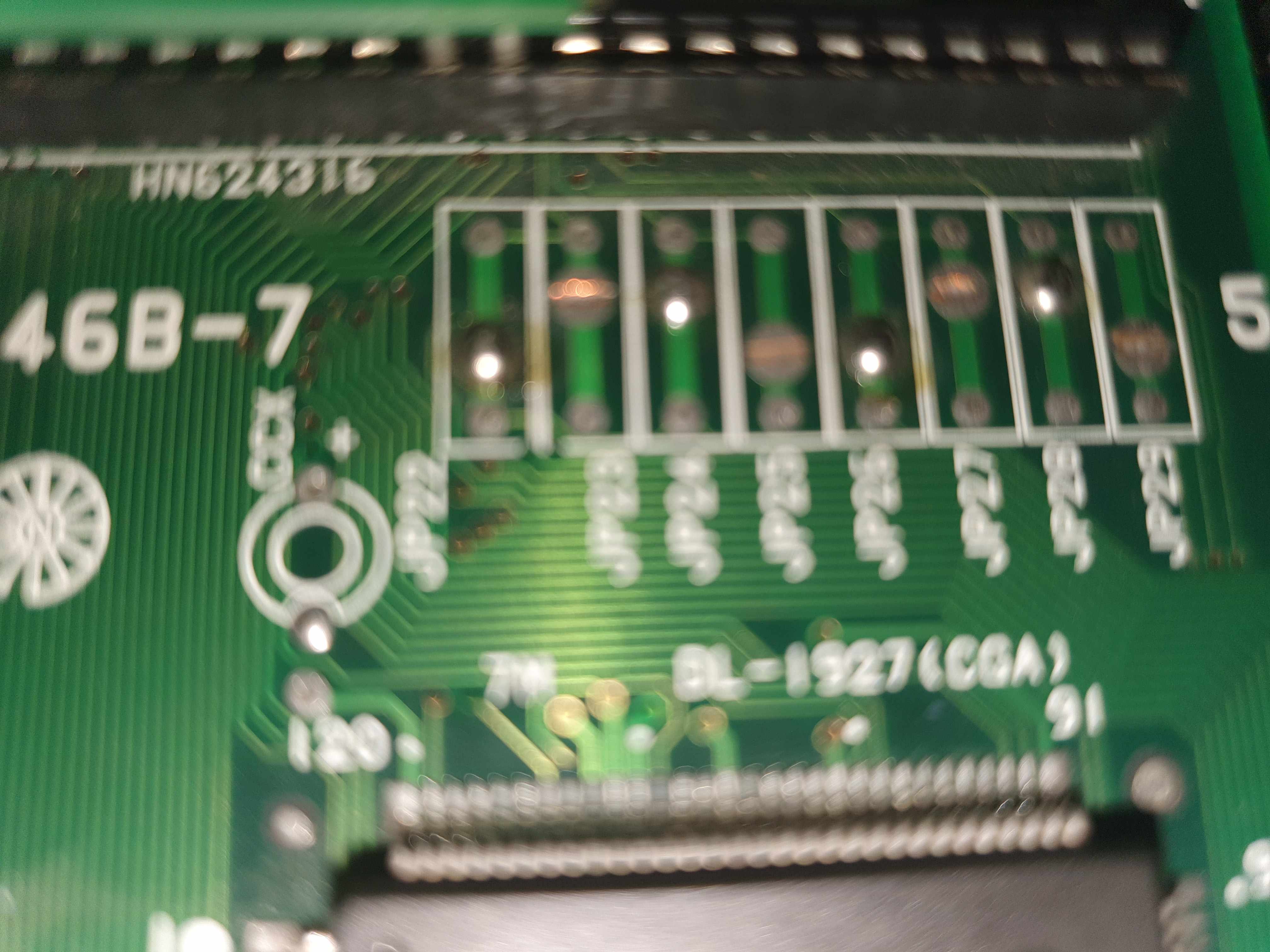

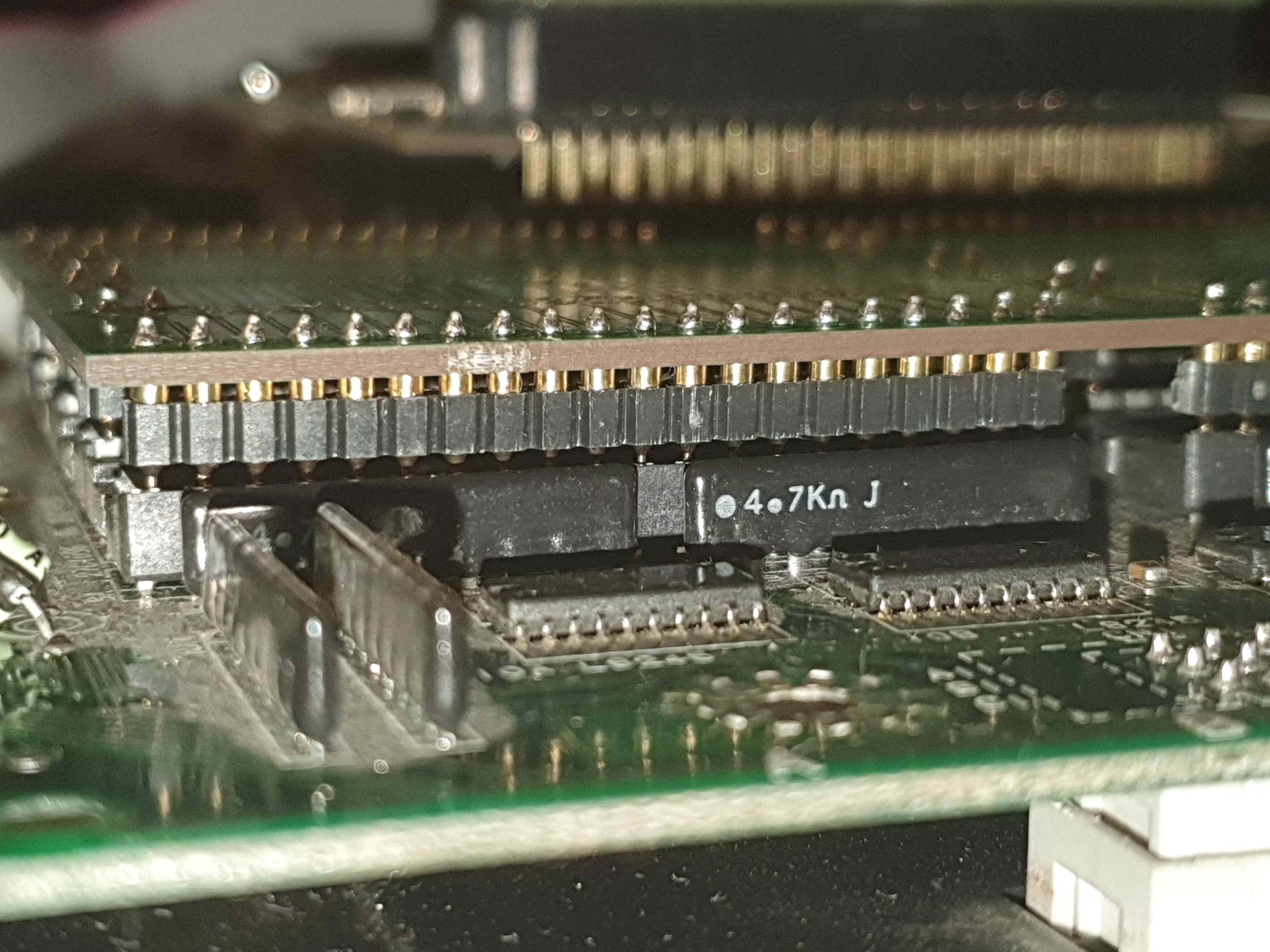

I think I may be onto what the problem could be. Wondering if someone can clarify before I actually do anything. I came across an old forum post here where someone had an issue where jumpers were attached via traces. Looking closely at my board it looks like I have traces between jumpers too (unless I'm wrong). I'll post pics. Can someone tell me do these traces affect the jumpers? do they need to be cut?

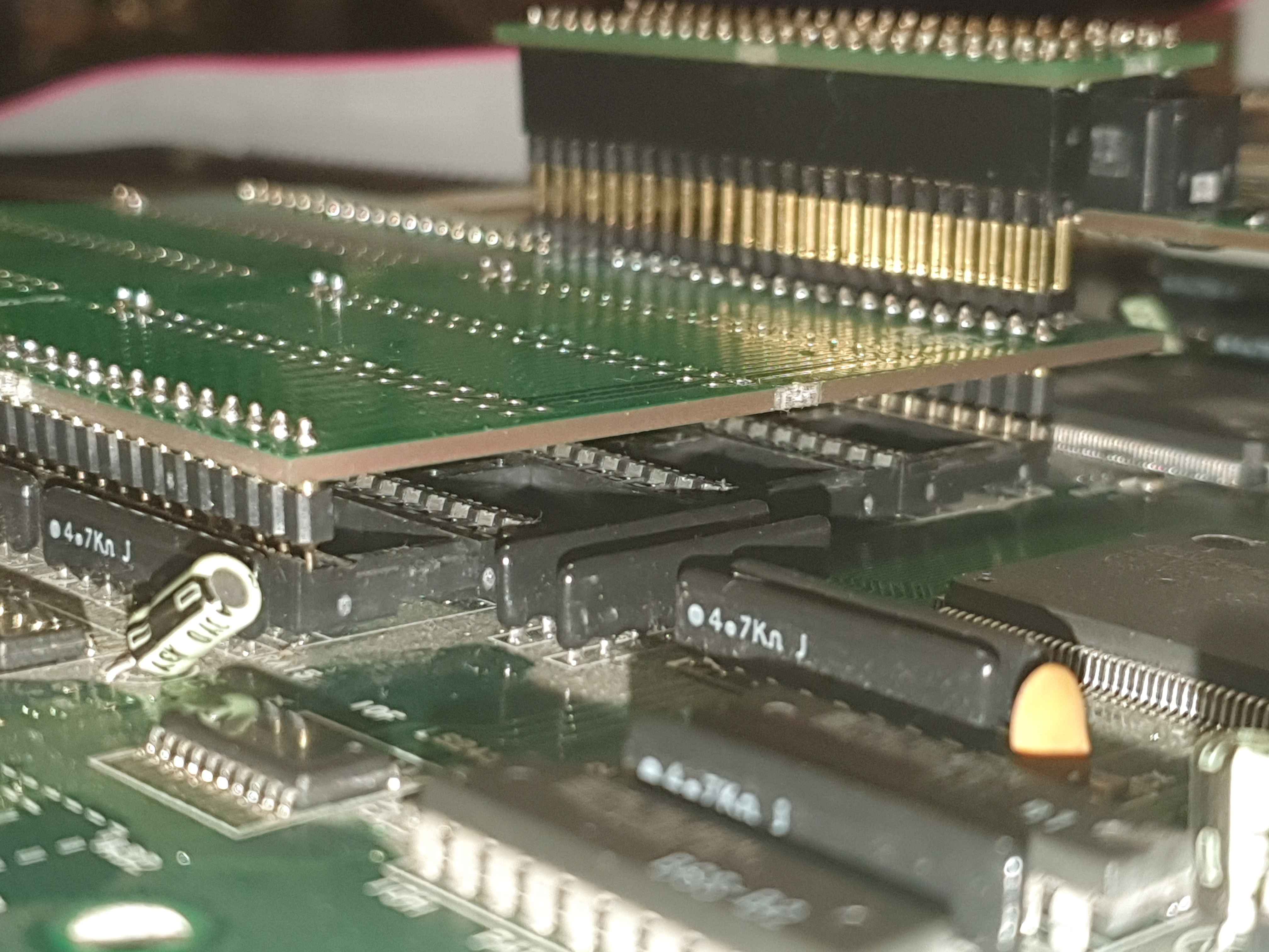

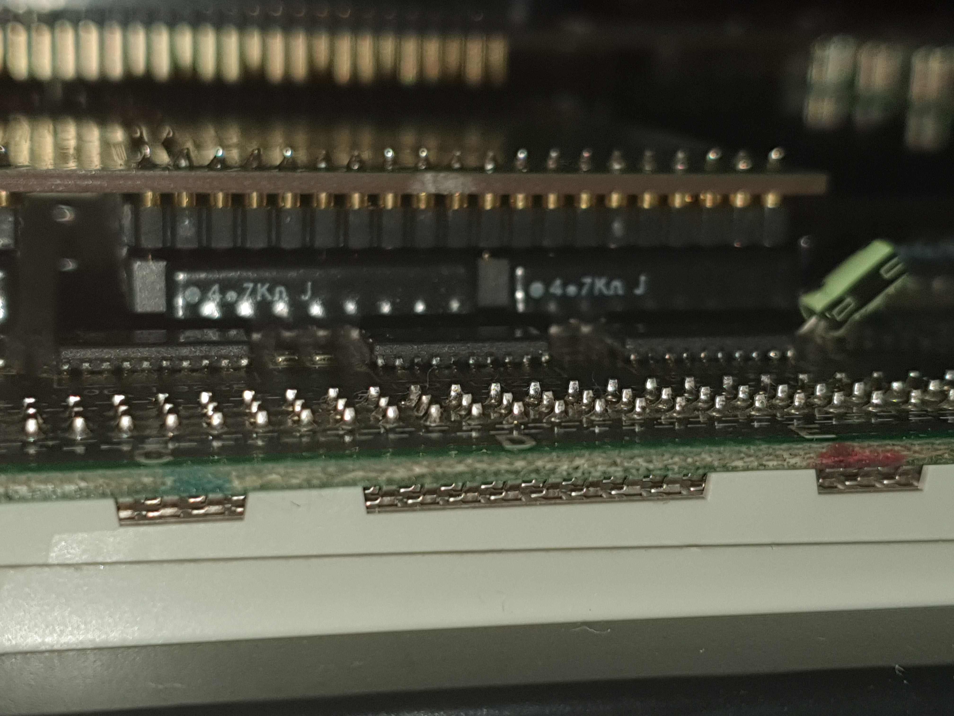

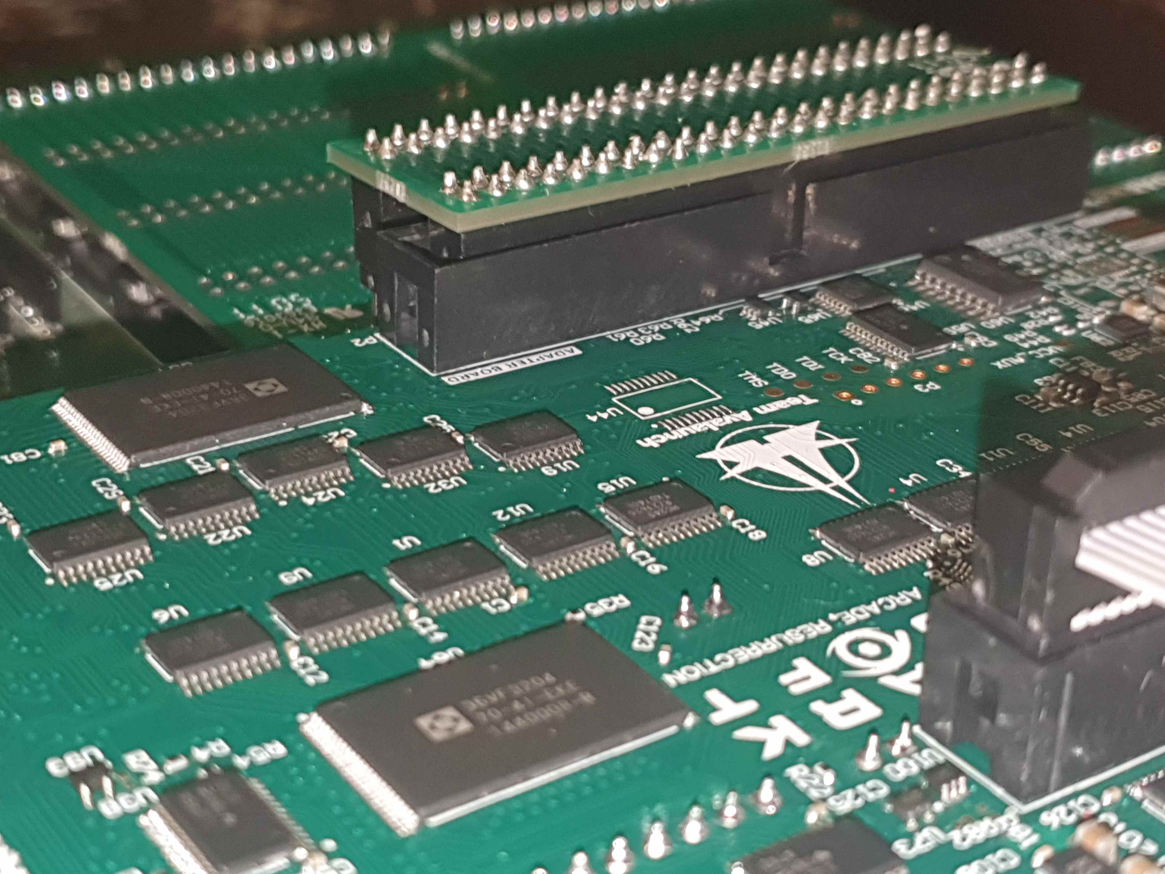

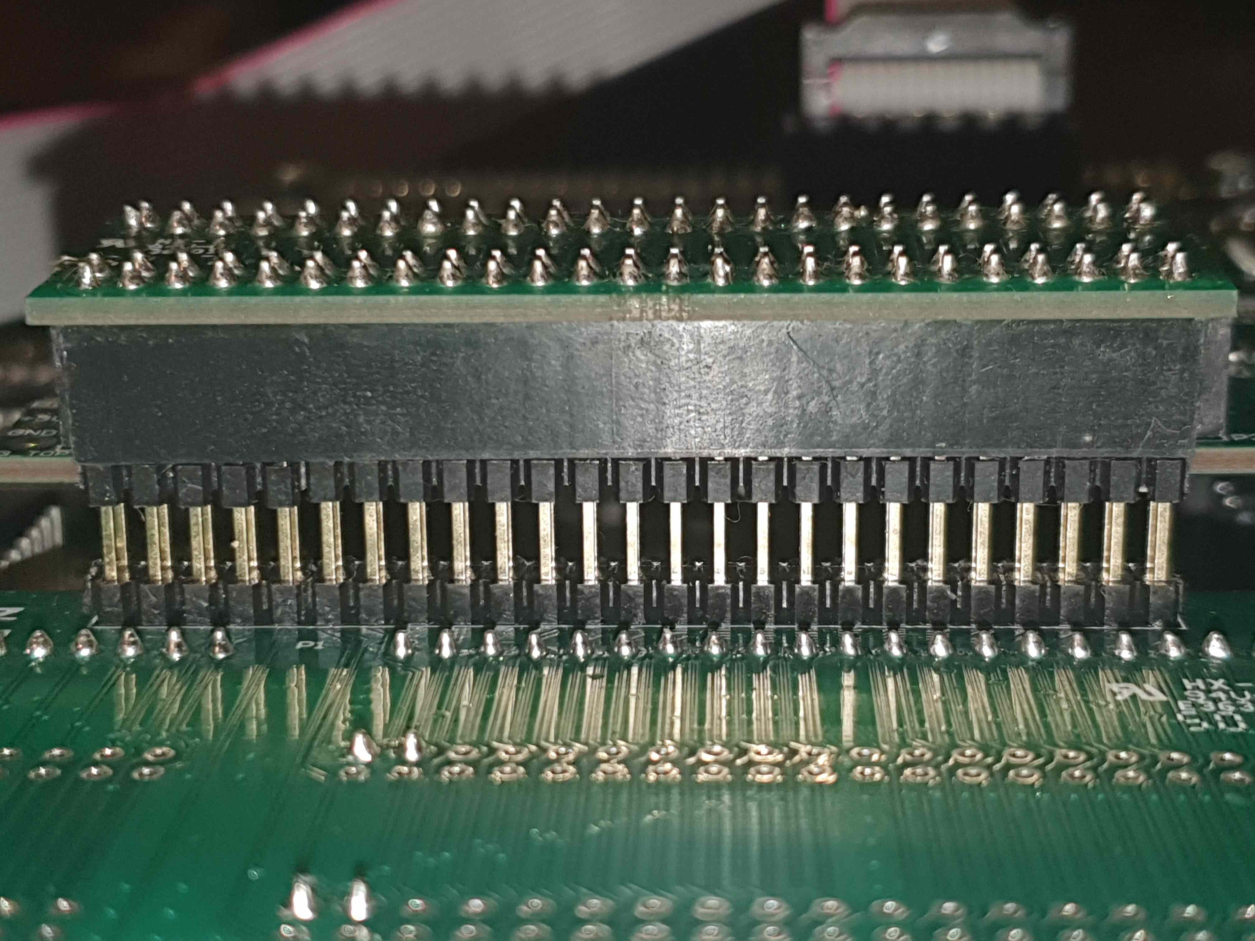

Uploading installation pics now.

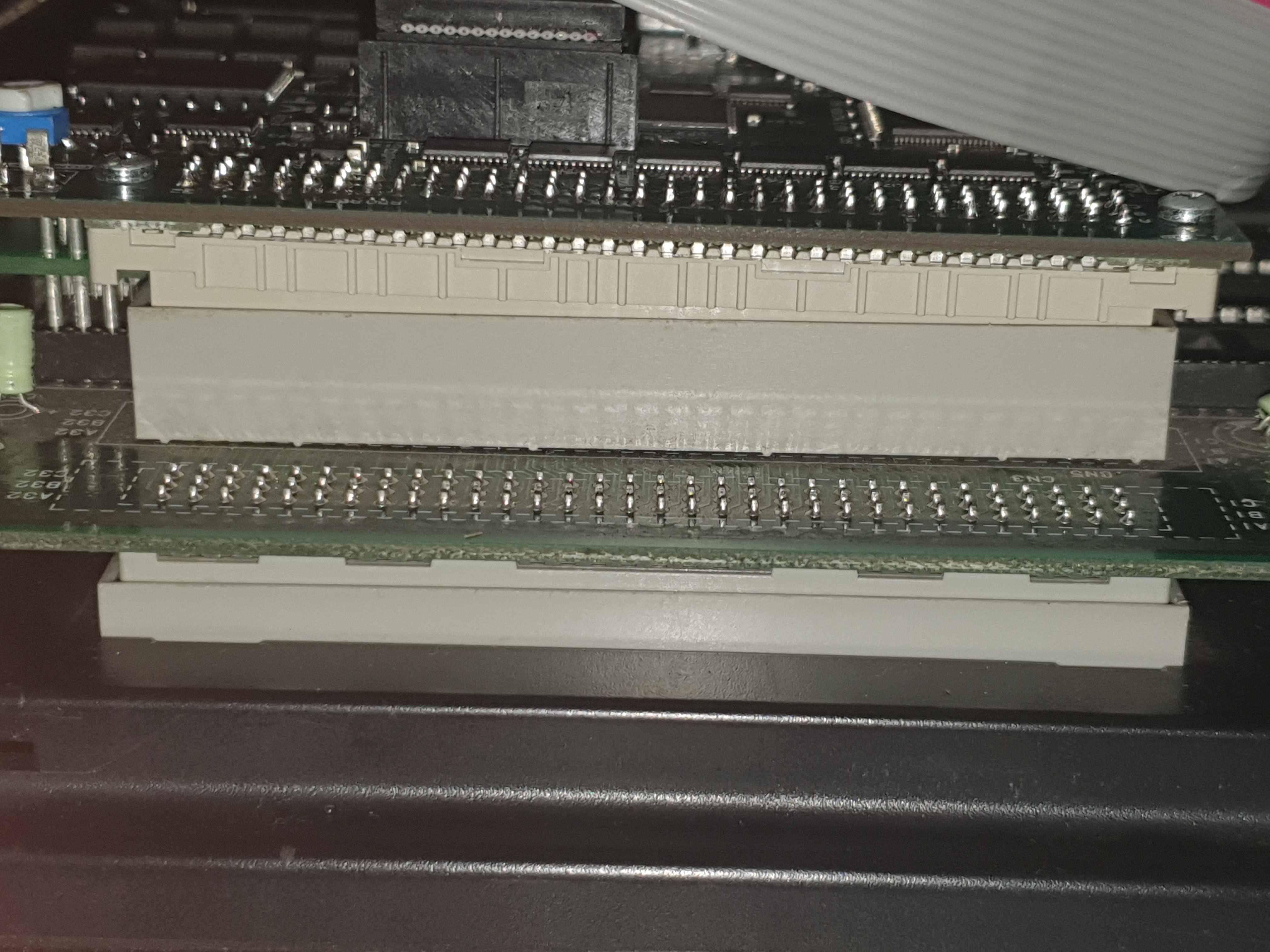

On the last picture it looks like grey the connector is not inserted fully.
Check if there are no bent pins etc and reinstall
Ok, so uninstalled the kit, checked all jumpers again - no problems. Checked all pins - all there and all straight. Reinstalled very carefully, ensuring everything is pushed tightly into it's place, tried 2 SD cards. And still the same problem. Graphics is no problem and running the game no problem. But the sound is fuzzy and tinny sounding. What else can I try with this? I'm reluctant to try another B board, as I don't have any other dead boards and I don't want to kill a live one. This board should be perfect because it's a Pal G Rev 7. Do I still need to lift a leg on the PAL on this board? or solder any wire? I haven't done that, as I thought it is not necessary on this board type. Can someone please clarify if this is the case and any other suggestions I could try would be great too. Thanks for your help guys.
