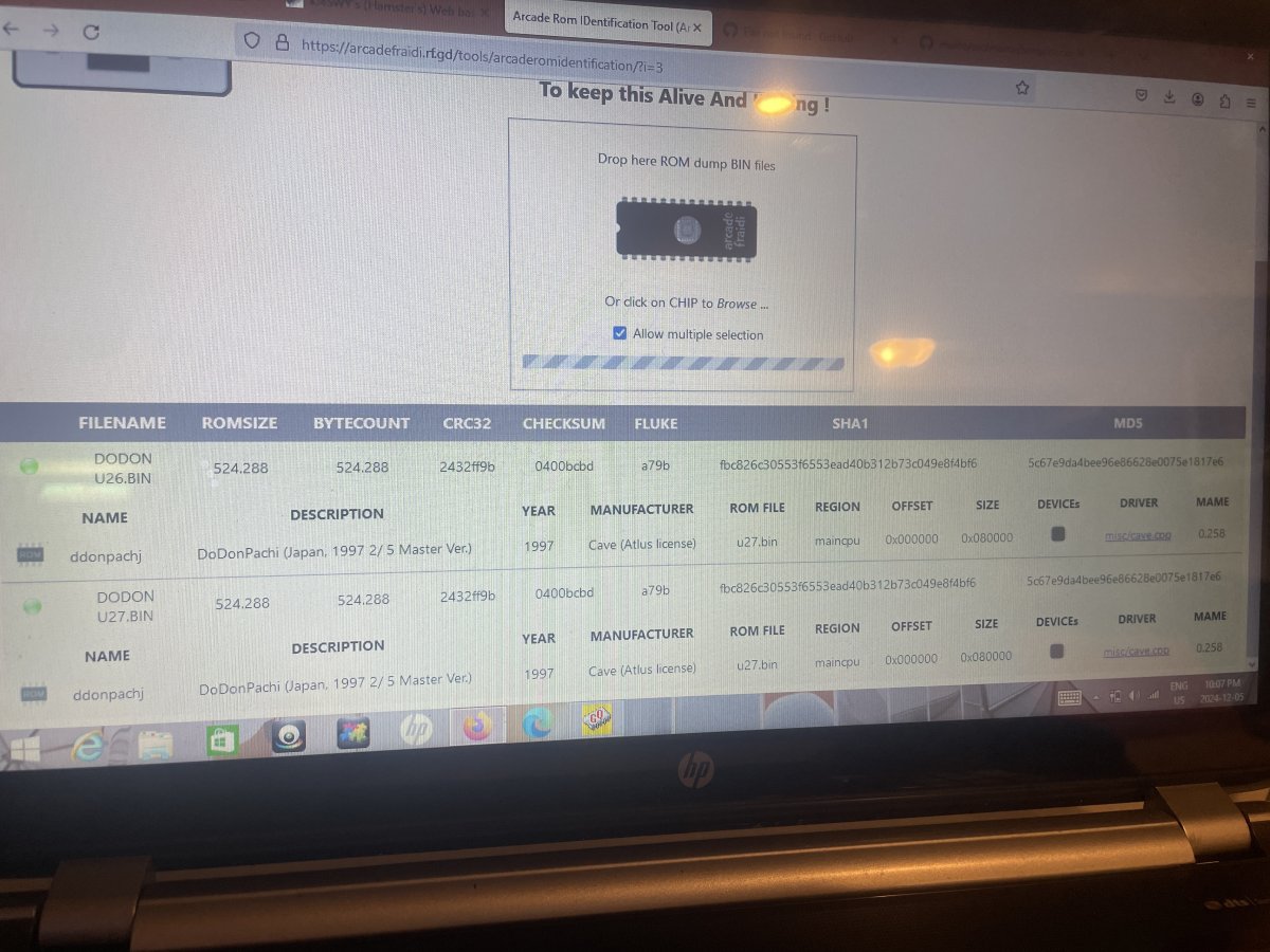

So I checked the roms and they both came up on the romident website.

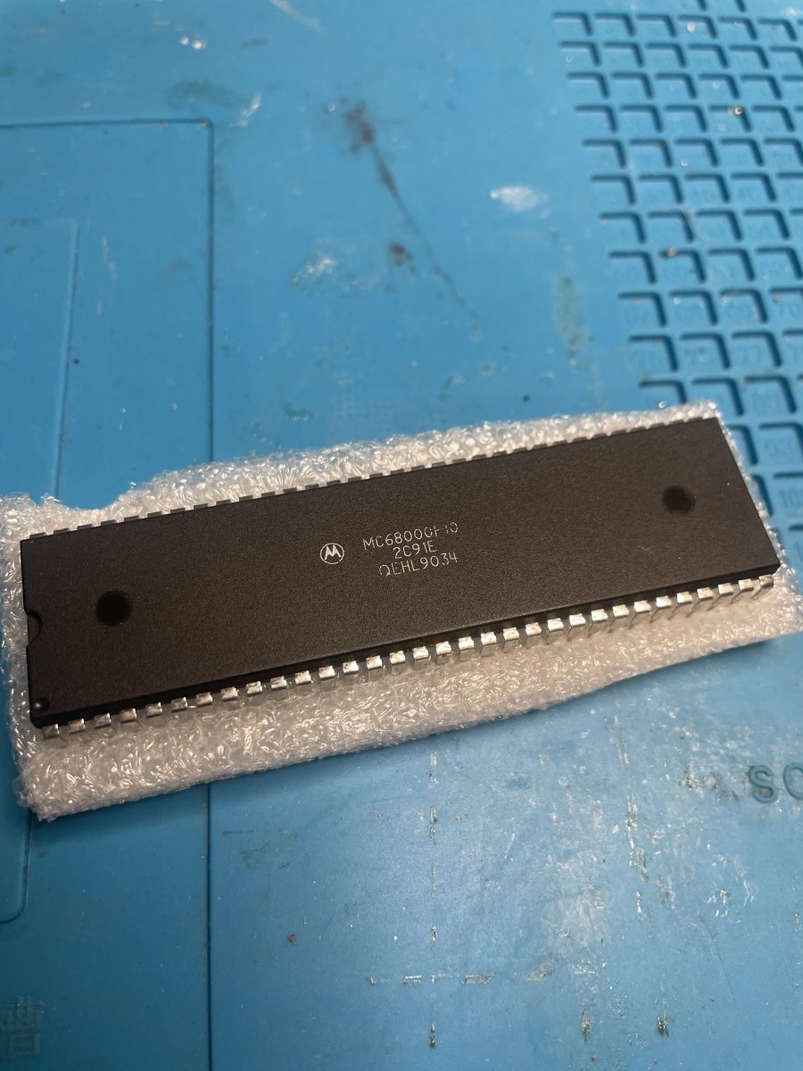

I have a Motorola 68000-10 as a spare and I tried that also and nothing :(

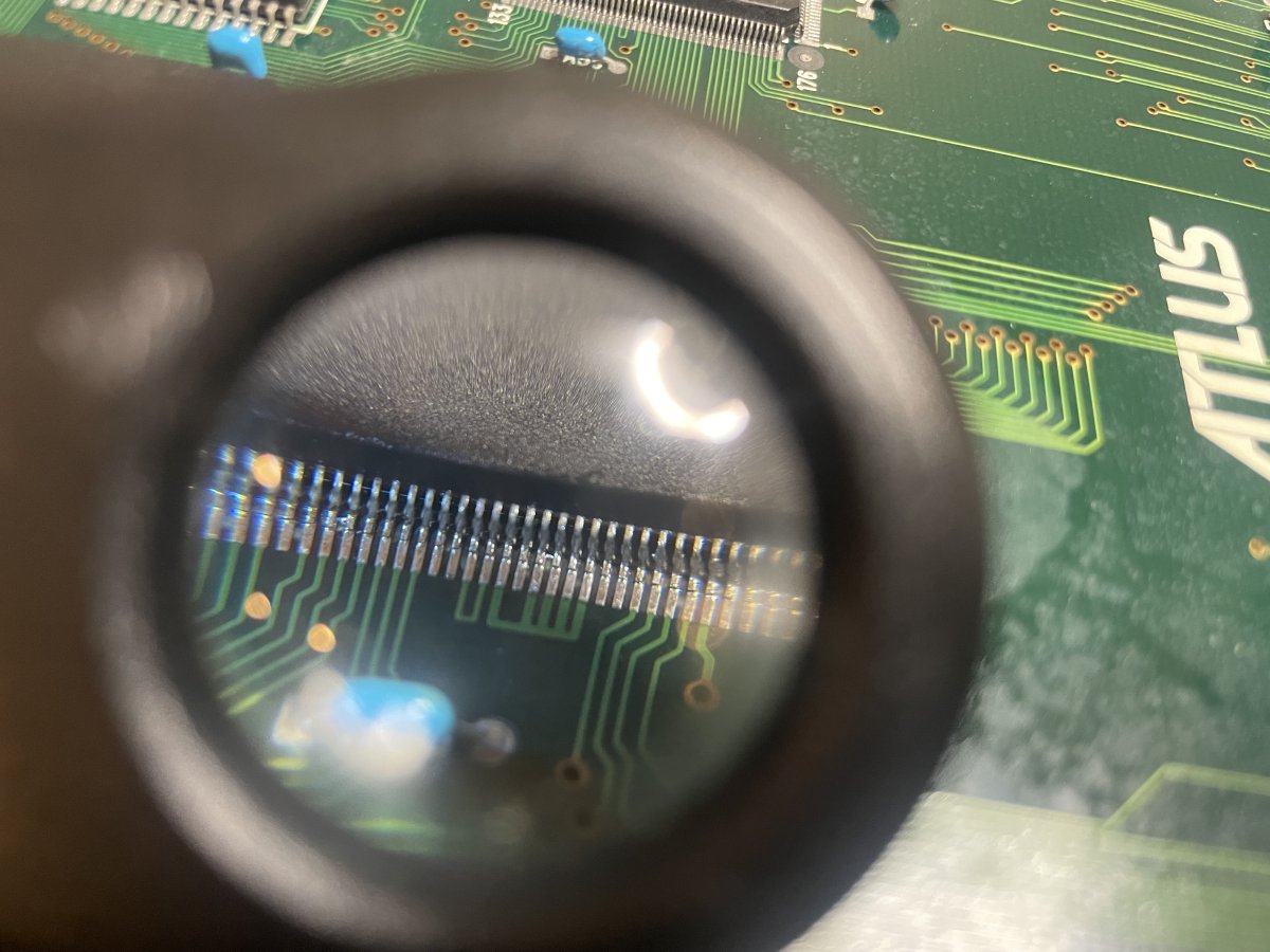

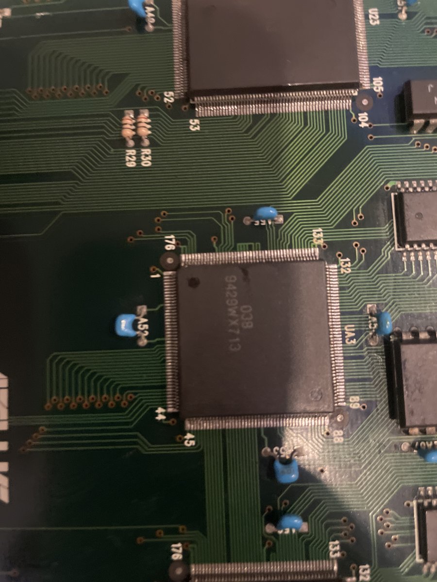

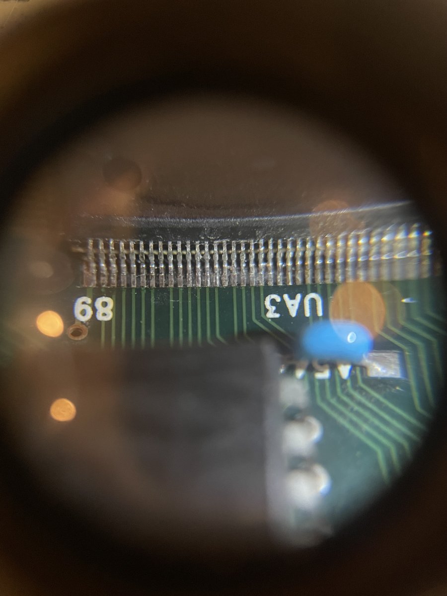

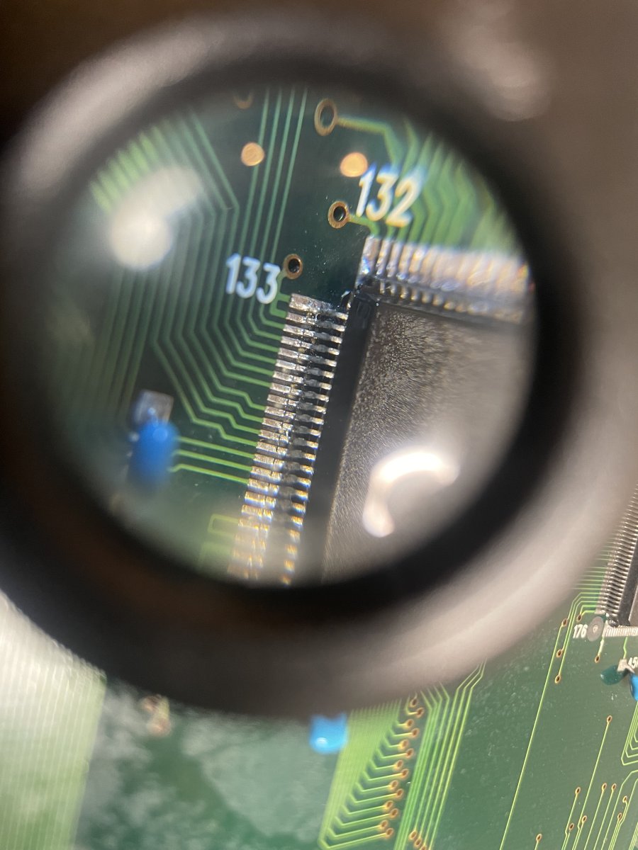

I also noticed that the first “038” custom had been reflowed so I went to check that over. I found 4-5 pins shorted and cleaned them up but that probably has nothing to do with the cpu

Yay for progress! Now you can write the CPU off your culprit list.
The all white screen is interesting. The DDP hardware draws three tile layers and a sprite layer. It looks like the top tile layer (FIX layer for high score and stats display) isn’t reading any data so it just draws all white (FF values) and covers up everything underneath.
Check the U62 ROM - it drives the FIX layer. If the ROM dumps clean and matches MAME then check the connections and traces for that ROM and the custom graphics chip it’s connected to.

You mentioned using the ROM Ident website before, which is fine for checking your ROM dumps. "Dump and compare against MAME" is slang for calculating the CRC32 checksum of a dumped ROM and comparing it against the CRC32 checksum that MAME has for its ROM dumps on that game. That's what the ROM Ident website does for you.

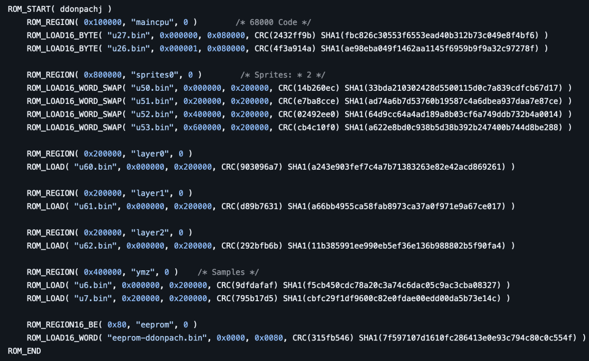

For instance, for the Japanese version of DDP, here is the MAME documentation for the ROMs, the subsystem they work with, and the CRC32 values for them:
You'll want to read U62 as a 27C1610 EPROM and you can use the same kind of EPROM for a replacement.

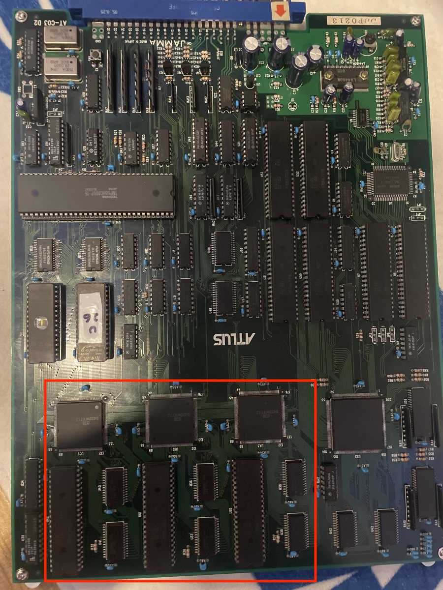

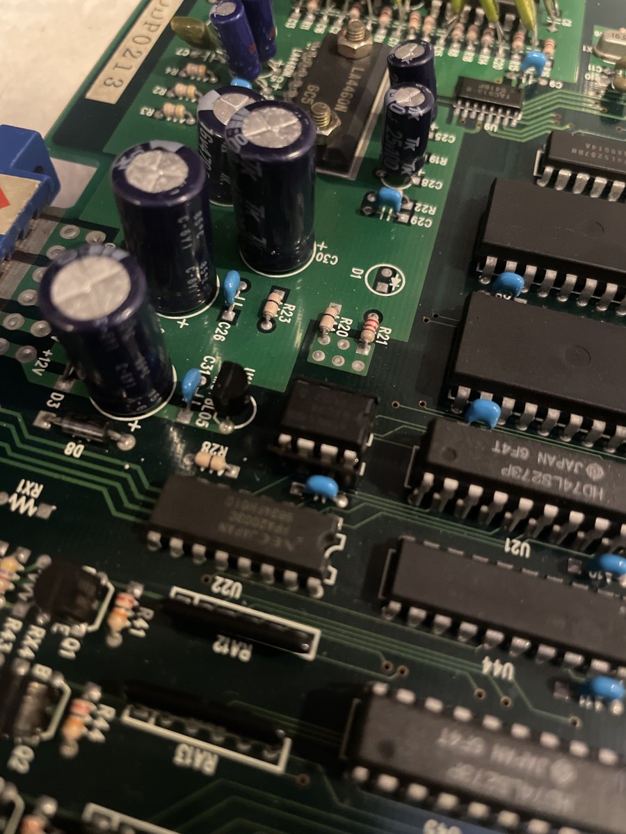

I haven’t posted a pic of the pcb yet so here’s one
The 8 pin Atmel chip is the EPROM - it stores high scores, game settings and bookkeeping data.
I think the solid background changing color is either a loose pin on one of the tile rendering custom chips, or a faulty tile ROM occasionally sending a different signal. Are the tile ROMs socketed on your board like the CPU ROMs were? If so, the wrong chips might be installed as you found with the CPU code ROMs.
This section of the board renders the three tile layers - focus on that. Each tile layer has its own dedicated custom graphics chip, ROM and RAM.
Check the pins on the three large custom chips for loose connections or solder bridges. Check the traces that connect each custom chip to its corresponding ROM and RAM. Dump the ROMs and use ROM Ident to check the dump against MAME. Sewing needles are common, cheap and useful for checking for loose pins on the custom chips. :D
Yep, I think swapping out the U62 part is a logical next step. Install a socket so that you can easily swap the original ROM back in if it ends up not being the culprit.
