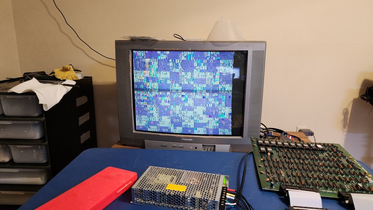

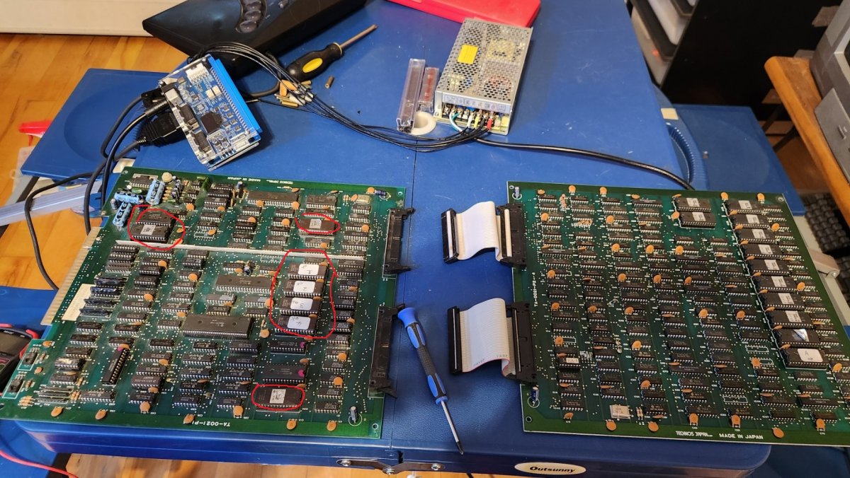

I just purchased a broken Double Dragon board from Ebay because I want to get into fixing arcade boards. I have a bunch of experience with consoles and most of the tools to do it. This is the first arcade board I ever attempted This board looks very clean and the seller said the problem is on the Jamma PCB because it was tested with a working set. What should I try next? I'm looking for broken traces while waiting for suggestions. I extracted the code from the roms circled in reg and replaced the files for those chips in the DDRAGON.ZIP MAME rom and boots as expected in MAME.

Hello!
welcome to the arcade repair world! First thing, I highly encourage you to check that the roms that you have are not in MAME. This is very simple to do, just open a CMD window and run mame with the file name that you want to check as parametere1 and give -romident as parameter 2. That will help you understand if your eproms are already dumped or not and if they are good. Some times you may have a bitrot and that will help you identify it.
i.e. mame.exe myfile01.bin -romident
Having said that, next thing I'd check would be the 68000 CPU. Make sure that it has a valid clock signal going in and that the address and data pins are oscillating correctly. If some of the address bits are stuck, that means that the code is in a loop and probably waiting for something that never happens.
Next, you can check the 74LS chips. If they are Fucjitsu, you can already suspect those as the culprit.
Check also for scratches or clear cold solders, etc. My guess is that some logic chips (aka 74LS) have gone south.

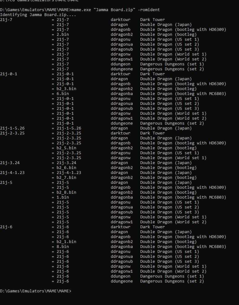

Thank you for the reply. This is my first day trying rom dumping. I actually checked the roms using this site https://romident.coinopflorida.com/ and they all came up valid Double Dragon ROMS on the Jamma PCB before replacing them in my MAME romset. There was one small MB7114H brom I couldn't test. I'll get a printout with the method you described.
I just used the method you suggested by only zipping the ROMs I dumped from the photo I attached in my initial post minus the MB7114H chip I can't dump. I think they look good. I ordered a logic testing prob from Amazon and it should be here later today. I also have an oscilloscope if somebody could tell where where to connect it.
That is for the color output. Shouldn't be related to your issue, which apparently is frozen screen with bad GFX. Obviously GFX are bad, because the CPU is not doing what it should and not telling properly to the graphic part what should be shown on screen.
Looks good.
