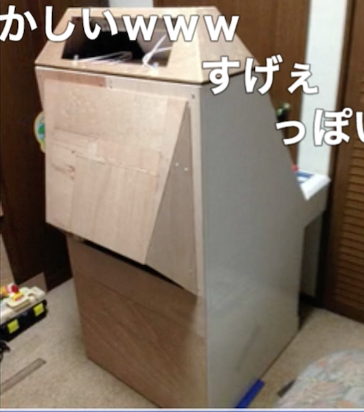

  • The housing for it all will be a sit down cab I intend to build custom from scratch myself. Similar to what is displayed in the project linked below, with some tweaks to suit my needs. I want to keep the build height as low to the ground as possible. It will essentially be a small cabinet shelf with a control panel hanging off of it. The tallest part will be the control panel. The number one design goal will be that it will support the monitor weight.
http://en.rocketnews24.com/2015/12/...cade-cabinet-full-of-nostalgic-feels-【video】/

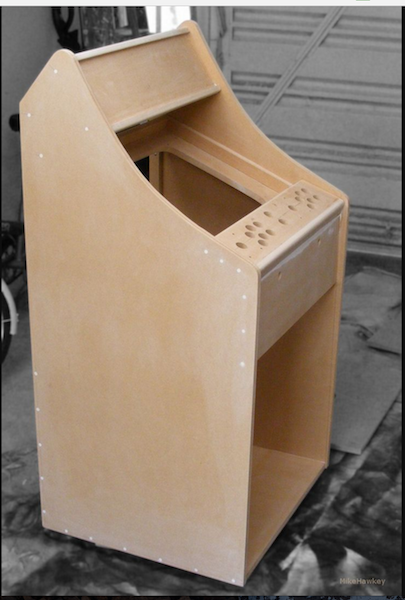

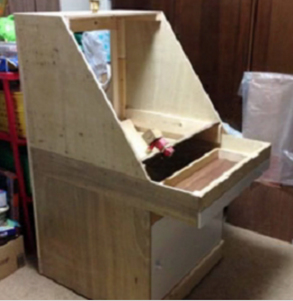

UPDATE Part 2: Cab design.
I have really been digging in researching different cab designs and my own project design goals and limits.
The kits from North Coast Custom Arcade seem cool, but I none of the kits are exactly what I am looking for and I am thrifty and feel I can build something better for less.
I am still formulating, I know some of these goals are aggressive but I think I can pull it off.
I have decided not to use the control panels listed in links above and build one from scratch along with an encoder solution, so it can control: jamma, dreamcast, saturn, genesis, snes, nes, pce.

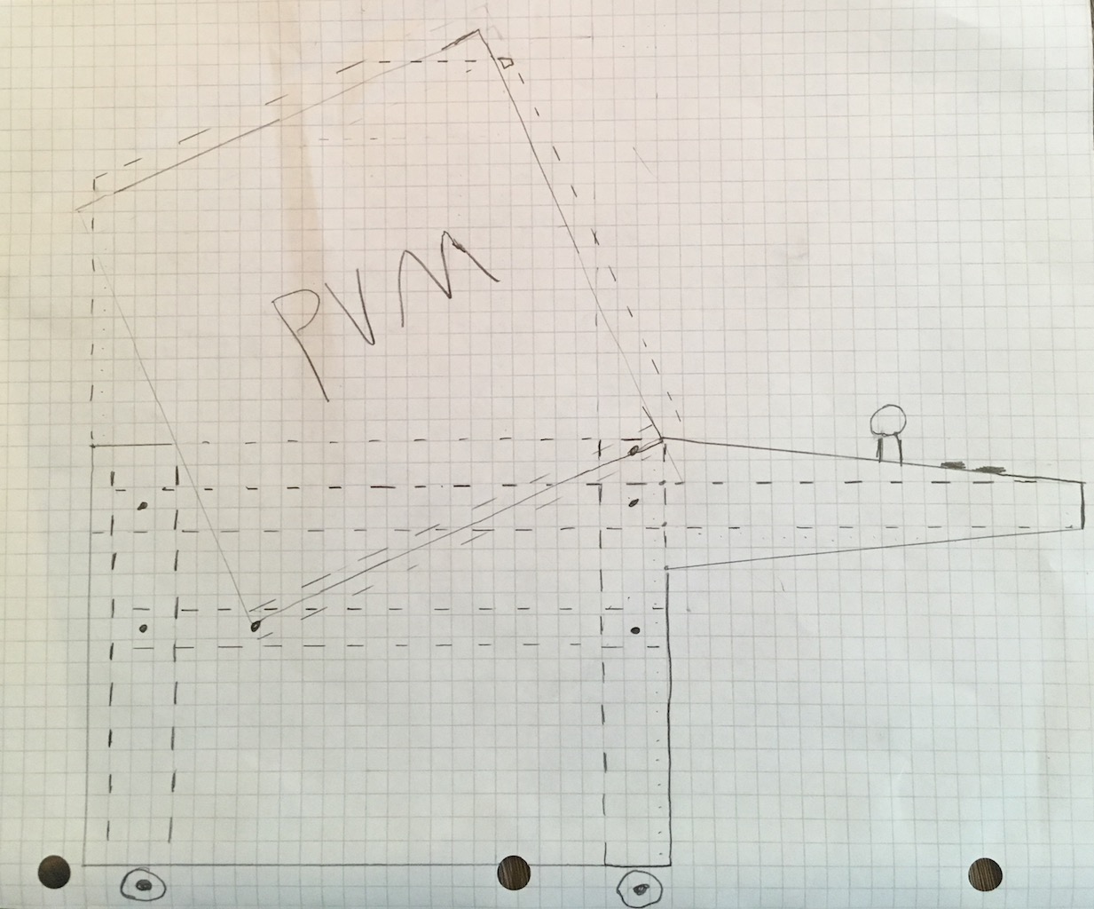

I want the cab to be a pseudo transformer with two modes. Cabinet and Case.
Cabinet mode - pretty self explanatory in this Mode I want all the same look and functionality you would get from an Astro City or an Egret II.
Case mode - this mode essentially removes or stores the PVM within. The video is sent to framemeister, and it becomes a big shelf, control panel, super gun thingy.
There will be an enclosure around the monitor on the sides and front, but no overhead hood. Once the monitor is removed the front and sides are on hinges and can be folded down and act as a table top surface. The speakers will be imbedded in the sides of the front enclosure of screen.
With this much transformability and need for access to the monitor, rotating for vertical games will be in mind for ease of use as well.

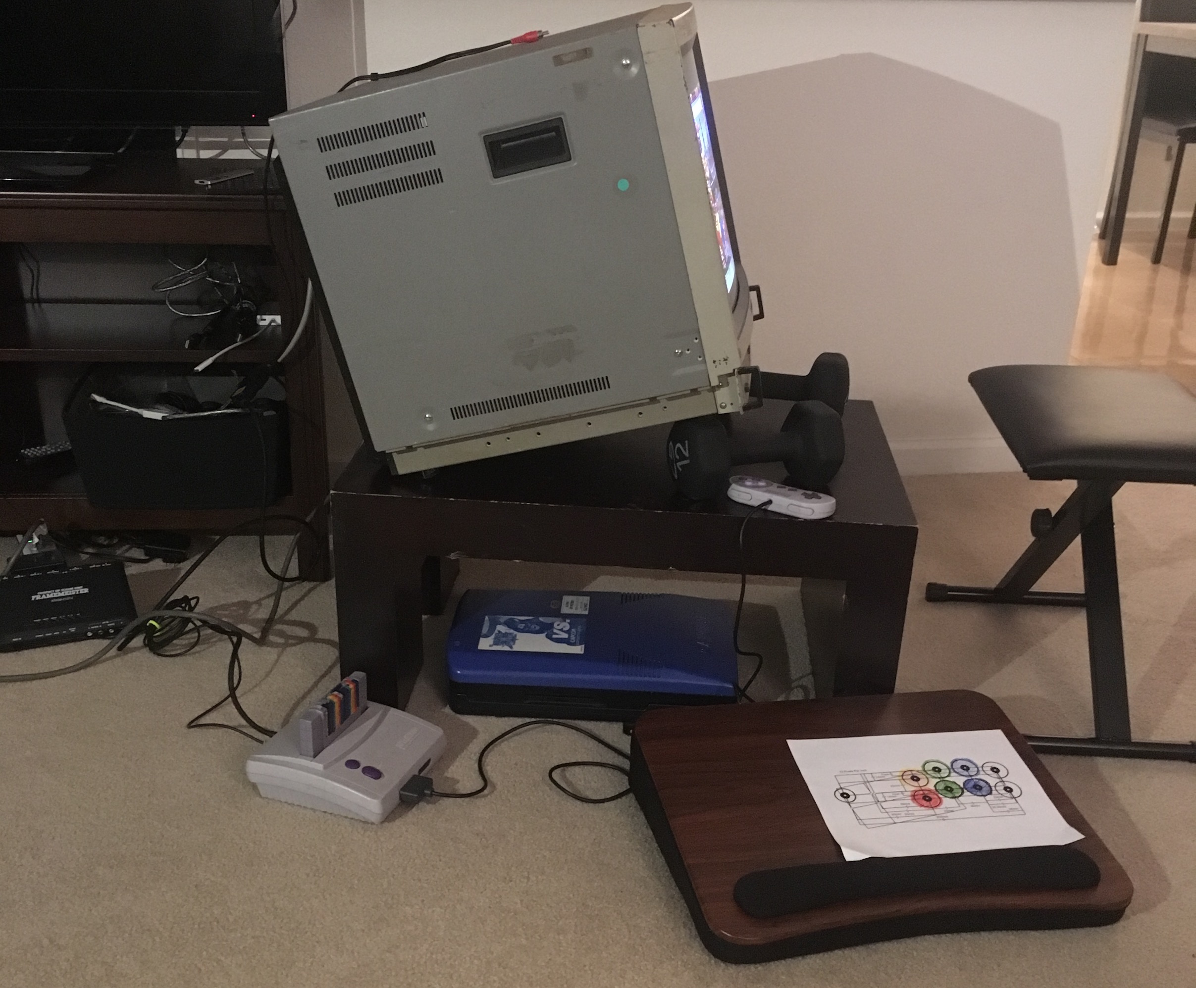

I could have one set up for use with framemeister on LCD and the other for use with my PVM. Build the front where the control goes modular so both the boardmaster or my custom sticks can just drop in. Build a base out of 2x4's with wheels.
I am still trying to figure: 1) how to allow for rotating the monitor. 2) speaker placement and 3) enclosure design and colors. Either match it to the boardmaster or get creative.

I have heard about the OSSC before, I thought it was budget version and that the framemeister had the fastest upscaling processors. I will look into. I mean I have this PVM so that's what I intend to use as my main display for Standard definition content. Scalers are option 2, but a nice option to have for sure.

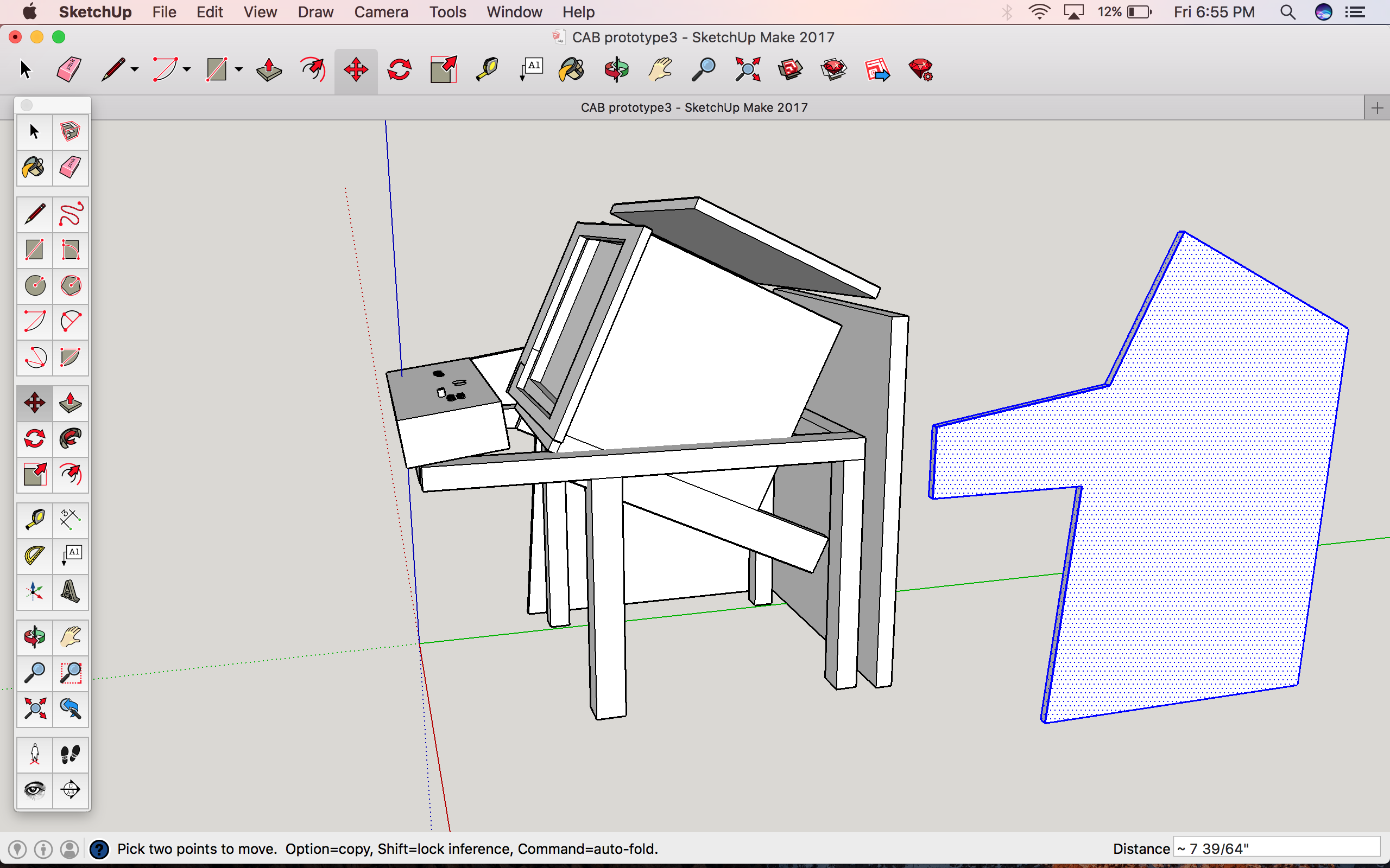

In other news, I found out about google sketchUp and drew up a prototype for my custom cab design. Modular for both the boardmaster or custom sticks and HAS when it gets sents.
I do not have the best grounding in structural design. Supporting a big heavy monitor like that and having it angled for a good user experience is difficult.
Any feedback is always appreciated. Thanks again fam.

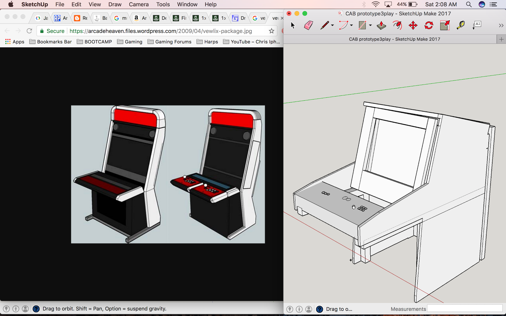

The Vewlix and other LCD cabs are laid out for the best user experience. they can be because the LCD allows them to place the screen and control panel at the optimum distance and angle where as CRT cabs generally have to compete with placing things comfortably and dealing wit the massive depth of the display. In general cabs angled the monitor back far not for the player but because it helped reduce cab depth. If you look at modern cabs there is an angle but it's very slight. also the top of the display should be positioned only slightly above your eye-level. (so if you look straight out at a line parallel with the ground that line should bisect the display such that 1/4 of the display is above that line and 3/4 of that display is below).
Also I would highly recommend you design your control panel box to simply accept a Standard Sega Panel (Astro City, Blast City, Net City, Versus City, etc) and perhaps even wire it with modular plugs similar to a Blast or Net city. This would give you access to LOTS of different panels that can be easily swapped out and if you ever did buy a real cab you'll be starting out with hardware you'll need anyway.
The design on the prototype was me kinda just trying different monitor positions trying to find what was comfortable, balancing with depth I actually found my design to be pretty economic. Making that sketch took awhile so when I have time I may try and draw up another draft implementing your tip of a less steep angle and a deeper cabinet.
EDIT: I toyed around trying to take the viewlix ergonomics into account. added pic.
