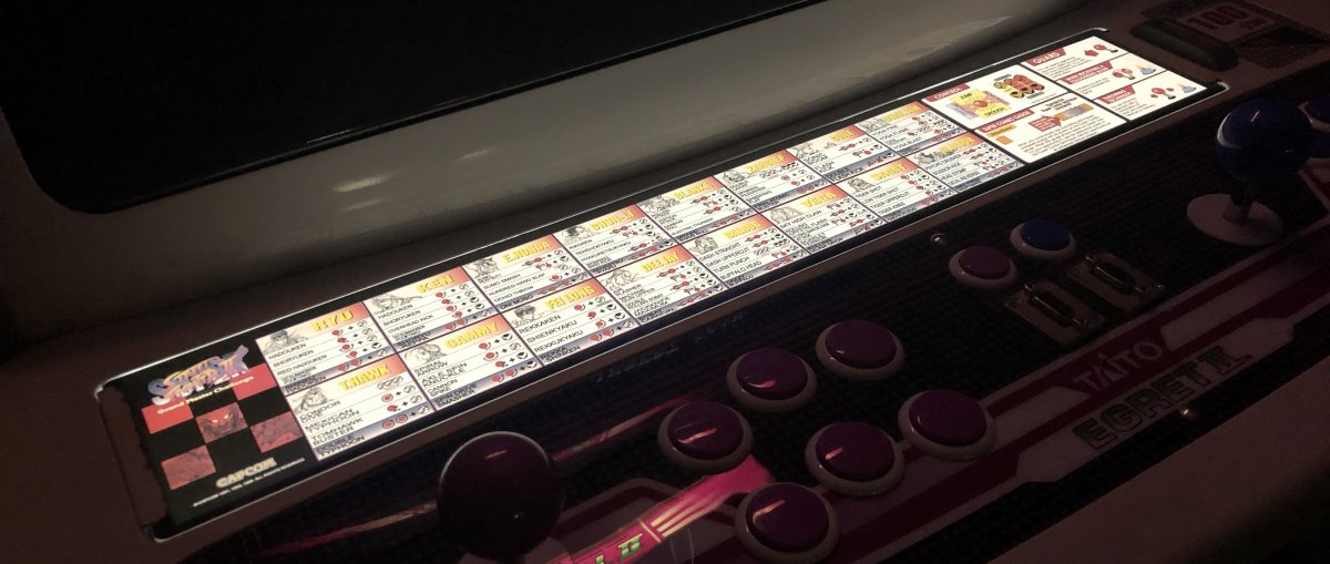

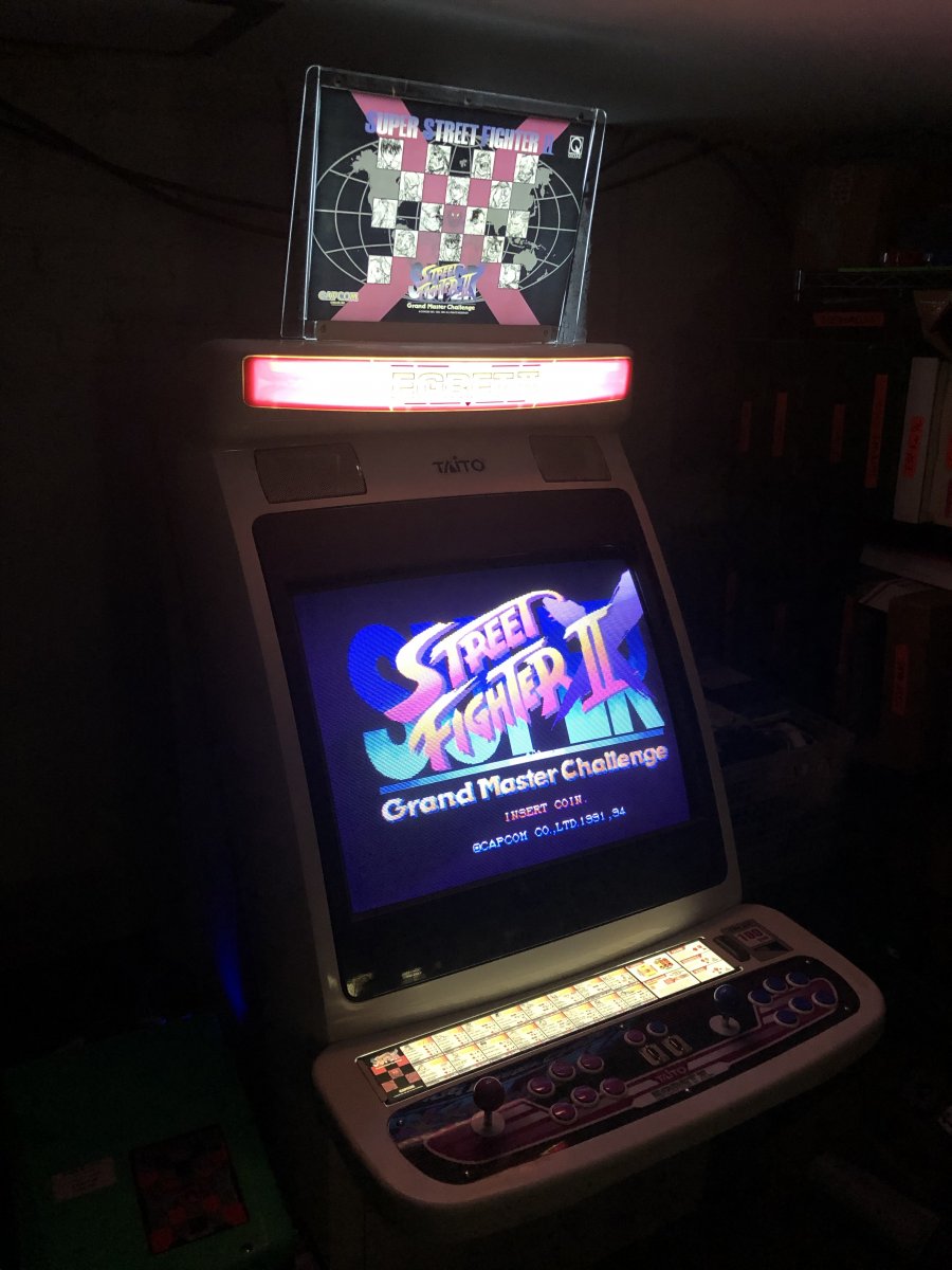

I've always been a fan of EL panels and it struck me that I could use them to backlight the move strip and marquee of my Egret 2, both of which I feel could use a little illumination.
The two panels are connected to the cab's PSU so when I flip it on everything powers up appropriately. The EL panel are connected to inverters that have built in dimmers so I can control the brightness. And I didn't drill any holes or modify the cab in any way to install everything. You think I'm some kind of animal? :P
I'm very happy with the result and can't see why this mod couldn't be applied to other types of cabs as well.

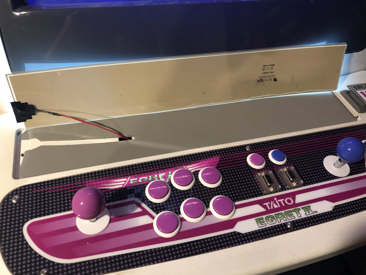

@emphatic Here are a few photos which should break it down.
The bottom layer is 1/16th foam with a recess cut out for the EL panel cable so everything sits flush. The cable has been modified to go behind the panel as most come out from the side. The EL wire runs through the (stock) hole in the move strip space.
I cut the EL Panel to the dimensions matching the move strip size and it goes over the foam.

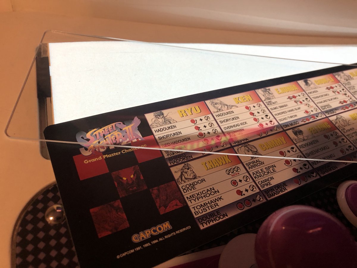

Movestrip printed on translight film goes over the EL, and a laser cut 1/16th plexi panel goes over the top (eps avail if anyone wants).

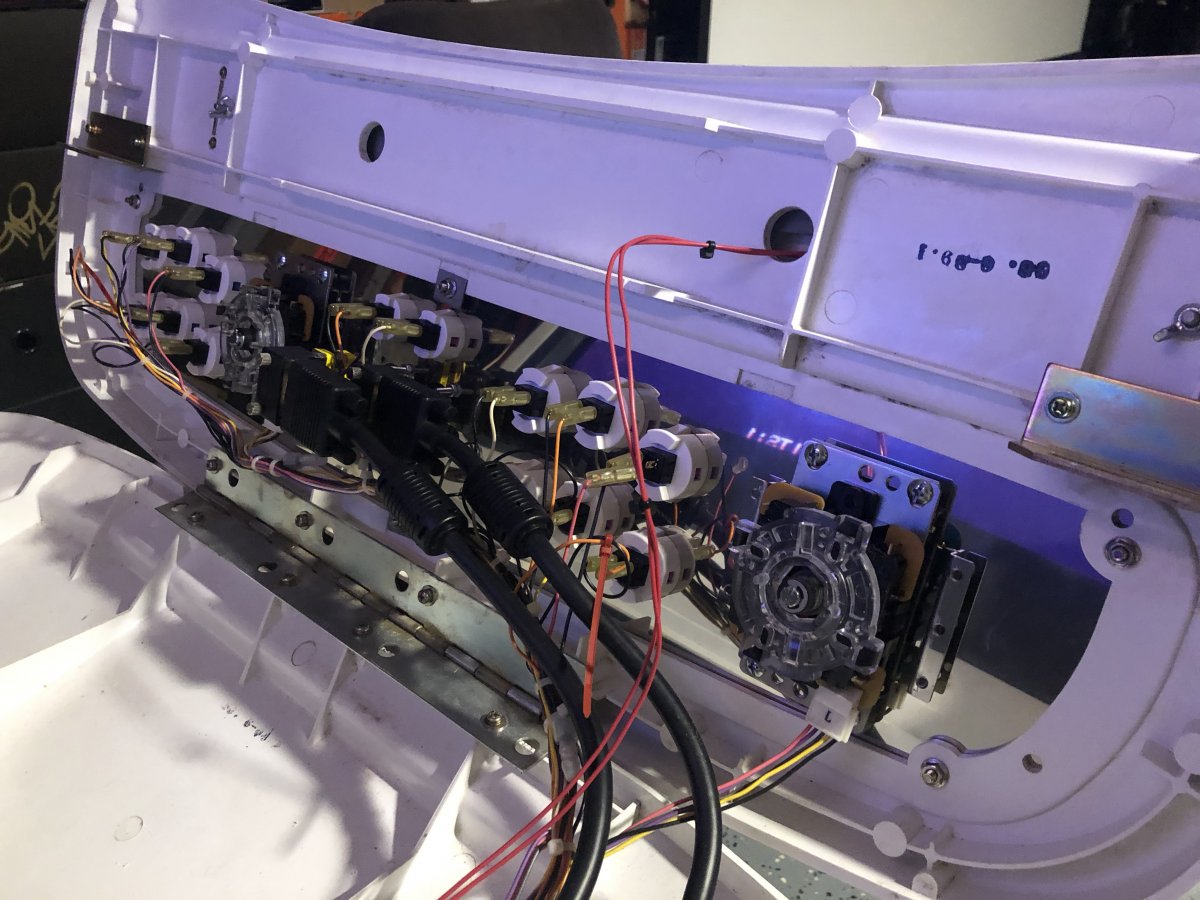

Here's a pic behind the panel. I'm very happy those holes came stock on the E2 as they were perfect for this mod. The wire runs into the cab where it connects to an inverter which has a dimmer for brightness. The inverter connects to the PSU and powers on when the cab turns on.
