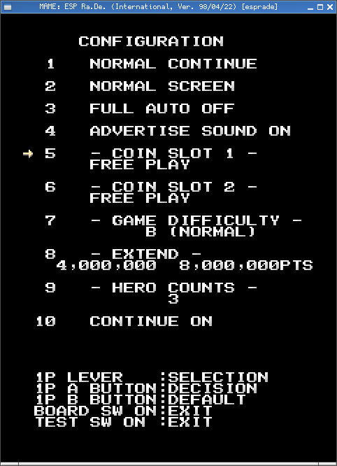

I was sick today so I took some of this home-bound time to finish up a ROM hack for ESP Ra. De. that replaces the "3 coins 1 credit" setting with "Free Play".
The source as well as IPS patches for the ROMs are available from this github repository.
https://github.com/Mikejmoffitt/esprade-freeplay
With some free time I may port this to the Japanese releases as well.

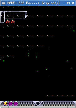

In case anyone was wondering this seems like it would be too much work to get running, even though the memory map is compatible:
Correct - that screenshot was just an aside.
However, the patch as-is won't work on the J version. At the very least the routines are in different locations, and the title screen code for the Japanese version has a few more subroutines related to the intro animation.
That intro animation routine isn't just disabled in the international version, I'm pretty sure it is outright missing.
