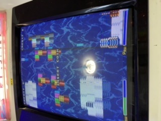

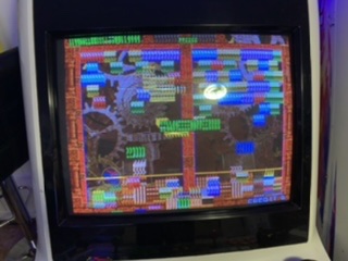

I put my F3 multi back in my cab today after being on a shelf for about a month and now I have graphical issues on all games on multi. I tried a few normal carts and they work fine without any issues so I am assuming it is the multi board and not main motherboard. I checked voltages and it’s fine. I also tried pressing lightly on random spots on mutli board in hopes that graphic issue fixes but nothing changed. I also reformatted sd card and wrote all games back to card and tried in a blast city and Astro city cab. All with no luck.
I’m kinda at a loss as to what else to try before I need to have it repaired. Anyone have any other ideas of what I can try or know anyone near NY that can repair this if all else fails?

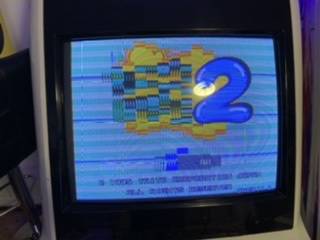

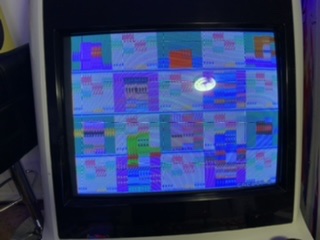

I downloaded both folders to test from here. Both passed and said “All done: Have fun!” then showed “Now playing:” along with each folder number and started showing garbled text and kept rebooting. I’m assuming that is normal behavior since it’s not really a game to be played. I then tried loading another game and was met with same result as before as seen in pic below
Is there anything else you guys recommend I check on this?
Definitely that means that the cart is mostly OK. I can only think of some buffers in the sprite bus gone broken.

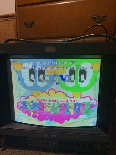

I tried a few original carts and they work fine. The issue only appears when using the multi board

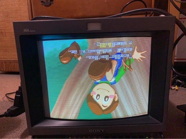

Spent a little more time looking at this today and notice something I didn’t see before. When I touch the chip at U9 the garbled graphics change up a bit. It does not fix it or make it look right but it’s the only place on the board that changes any graphics output when touched lightly. I see nothing that looks wrong with anything around area though. It all looks clean to me. Hopefully this is a good step in the right direction to have this working again.
You can try reworking this chip and the buffers that go with it. Just track to which 4245LV the data and address pins go and replace it.
I sent the board to a guy local to me to take a look. He reflowed chip at U9 which made an improvement but did not fix. Any recommendations on where to go next from here?
The guy I sent the board to for repair isn’t sure what to do anymore after reflowing the chip at U9. It helped some but did not fix
Is it possible you can tell which 4245LV it is so I may tell him which one to try to replace? If not may I send it to you for repair?
