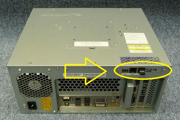

Also... does anyone have pics/info on the Fast I/O / JVS setup on TTX3 units?
I have only ever seen the back panel for it...
What does the rest of this look like? I assume there is a PCI board included...

The part you circled on the TTX3 is all there is, that connects directly to a Fast IO in your cab.

The TTX3 pic though - I was interested in what is installed in the TTX3 unit itself..
I assume that the part cirled is a hybrid of JVS (which will connect to the motherbaord) and Fast IO (which will connect via PCI).
Just haven't seen what those parts look like up close
No that panel connects to the pcie card to the left of the GPU with the big metal thing sticking out which then connects to a serial port header and front panel header on the motherboard for jvs/power control.
