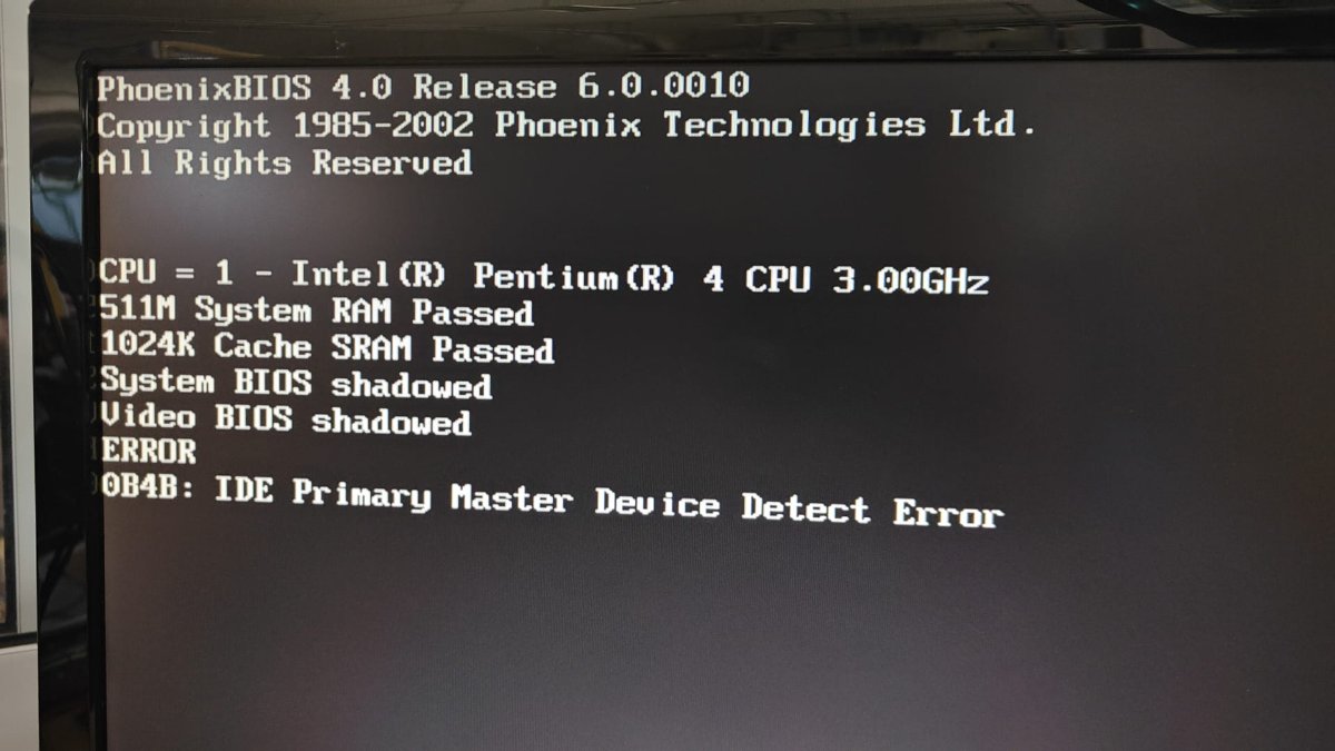

The problem consists of ANYTHING connected to the CF Slot/IDE1/IDE2 on the motherboard not getting recognized/seen by the system/BIOS.
Just boot up your Lindy and in the very first screen you will see something like "Fixed Disk: <CFCARD>", well that's not for me sadly... :thumbsup:

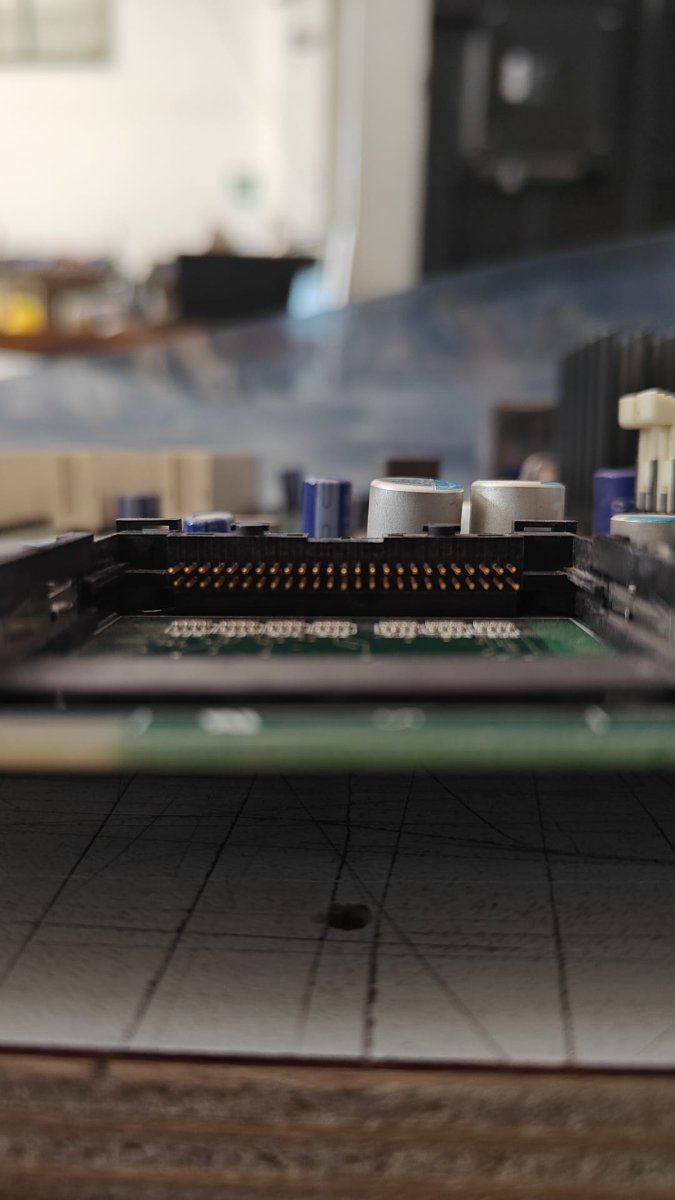

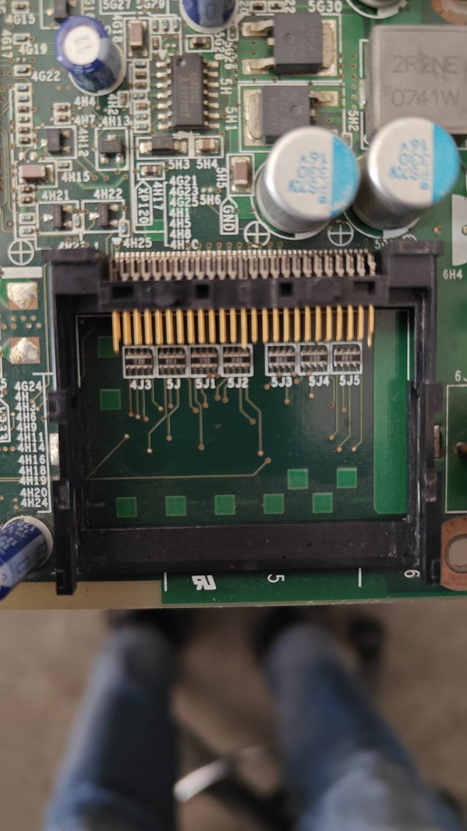

I've spent hours playing around with the CF pins on the motherboard, set to CF Slave (9-10)/CF Master (Default, 11-12), connecting HDDs (set them to Master/Slave, it doesn't matter) to IDE1/IDE2. There's no way to make anything be recognized if connected to these ports, and that's a problem.
Obviously I get to the point in the POST screen where it shows "Error 0B4B: IDE Primary Master Device Detect Error" and the boot process stops.

  8. Deep clean of the motherboard with isopropyl alcohol and inspect every single component that might look damaged from the outside, everything looks ok;

  1. I start thinking there could be some kind of PCI line connection damage considering that removing the heatsink the first time the CPU got ripped out with it.
