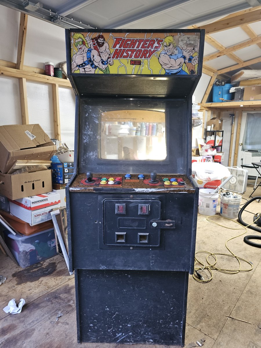

I can tell that Fighter's History isn't the most popular arcade out there by far but I came across this mess of an arcade machine and I had 10 days off of work. So with no idea what I was doing I've made real progress. I'm proud even know I still have not a clue what I'm doing most of the time.

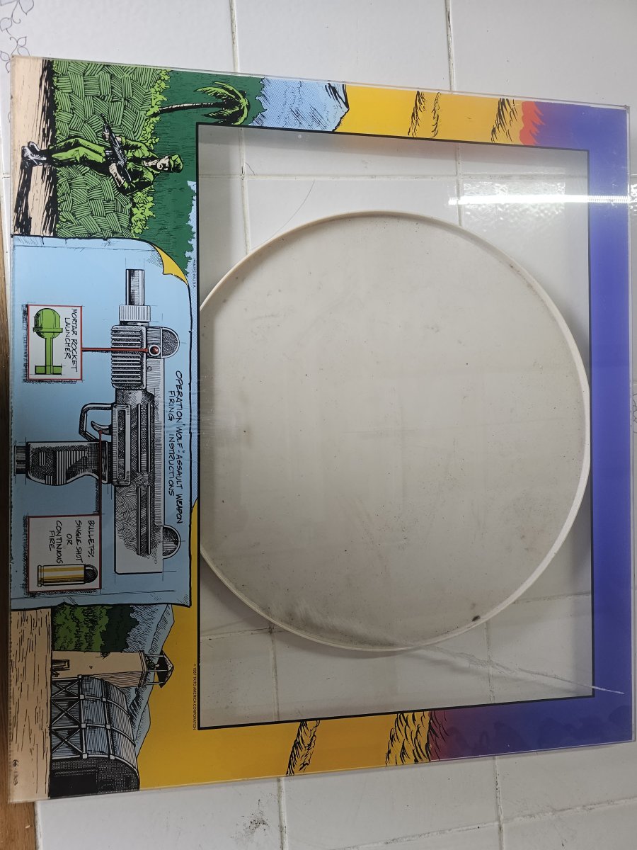

Yea I got some operation wolf stuff like the marquee and the frount glass and the gun. There in pretty good shape. I say they have been sitting in a semi trailer for years.

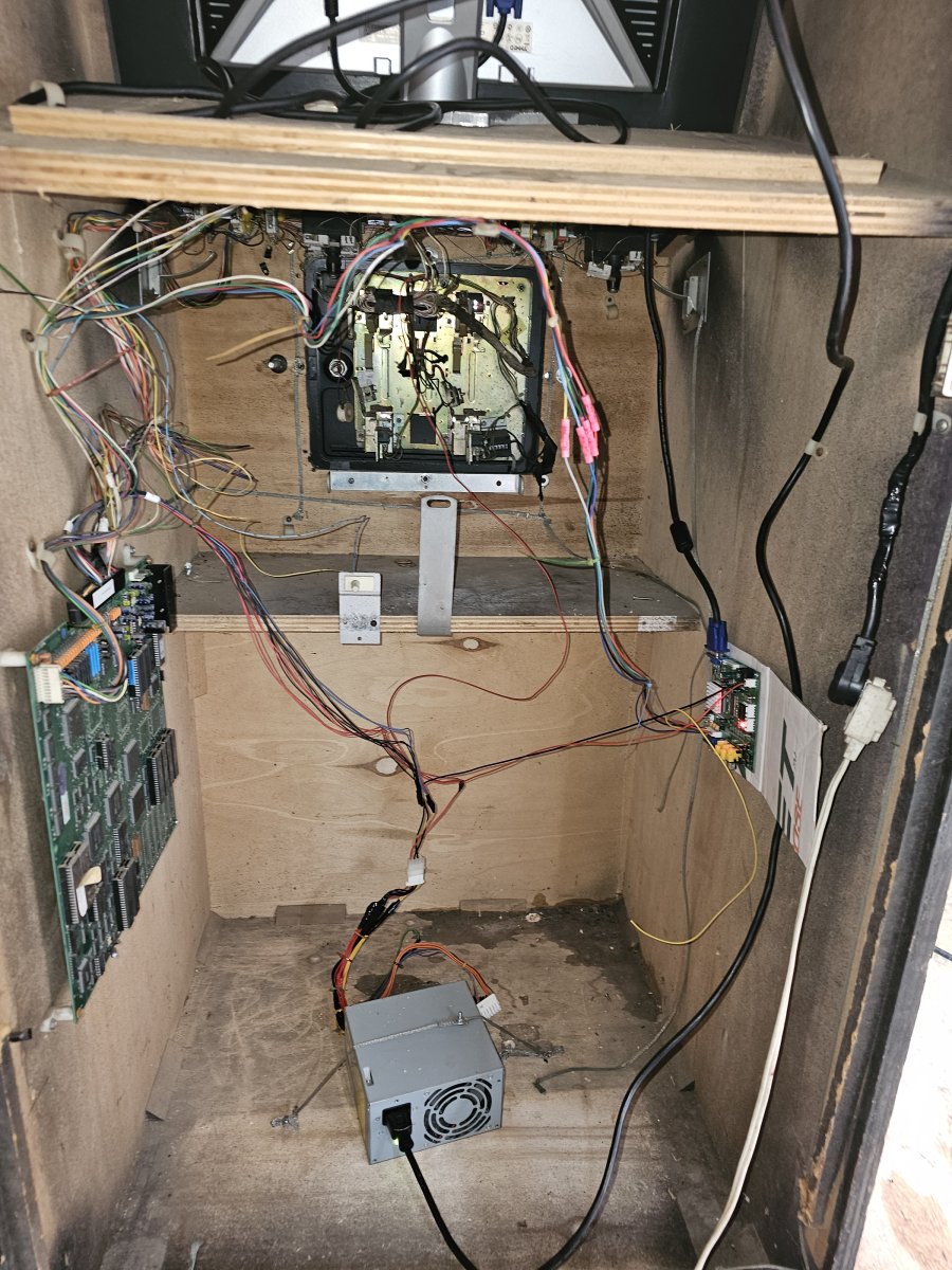

I am waiting on new limit switches now to redo the controls. i honestly do know if i am going to be able to do it. The arcade sat so long only a few of the limit switches work and its prob best to change them all out but it looks like a heck of a job.
What a great machine! Don't change the game exterior, but set it up so you can change games in and out.

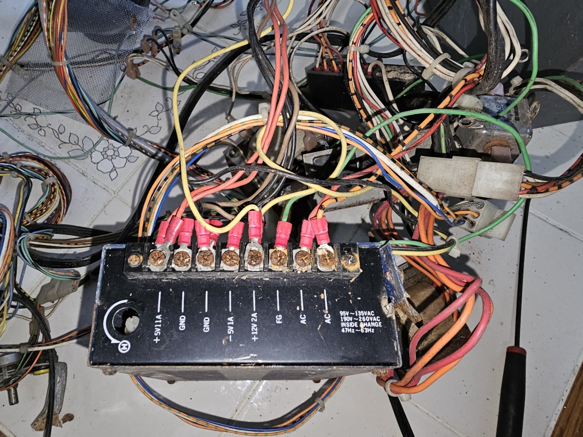

How much money vs work are you willing to do? If money isn't a major issue, I'd pull that wiring and get new wiring and a new PSU to start.
Is that a Defender cabinet?
IIRC Fighter's history originally came in something that looked like Data-East's version of a Z-Back.
Also those are the weirdest stubbiest joysticks I've ever seen, lol.
What are your goals with this cabinet?
Yeah, I was wondering if whatever that is supposed to mount them to the control panel (nuts, bolts) have come off and the sticks are just hanging there by the handles.

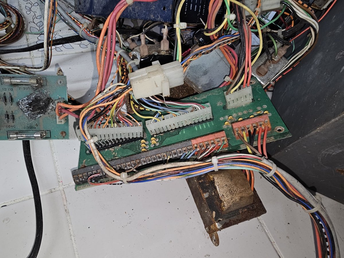

I don't mind to put time into it. I looked some stuff up on Amazon and none of its real expensive. I'd love to fix it up for my boy he's 17. I got a switching power supply but for the life of me don't understand the power because the wireing is a mess so I stripped it all out and just threw a old atx power supply in it to make sure the board wasent junk. There are a few things in it I don't have a clue what they do.

The cabnent and controls are just like I found them. It's says Data_East on the board. I'd like to restore it to as close as new as I can and give it to my son. I just don't understand what all the wireing and switches are for.

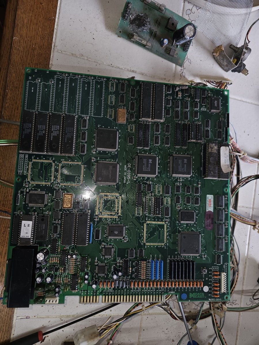

so do you guys think I should buy a Defender board and go that way or start over from scratch? It does not have an emulator inside it if that is what an emulator build. Please don't make to much fun of how I got it working I just did what I could to get it working so I knew if the board was any good.

Good job on getting it running.

Thank you man. Yea Defender isn't for me and your right my son and his friends are already in love with it. So this is maybe a dumb question but could I buy like some other arcade games and plug them into the jamma to play without having to tear the wireing apart?
Yeah, absolutely. Jamma is a standard. Anything that uses three action buttons per player will plug just right in.
