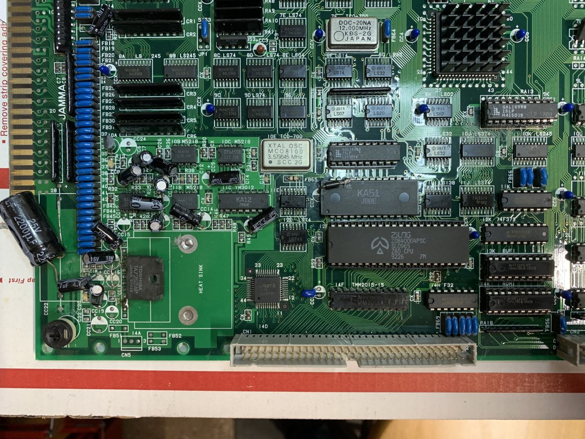

I picked up a forgotten worlds conversion from the eBay shop with the (cough) improvised audio sections. As expected the sound has stopped working properly. The attract mode sound effects work fine, but as soon as you coin up the audio stops working completely.

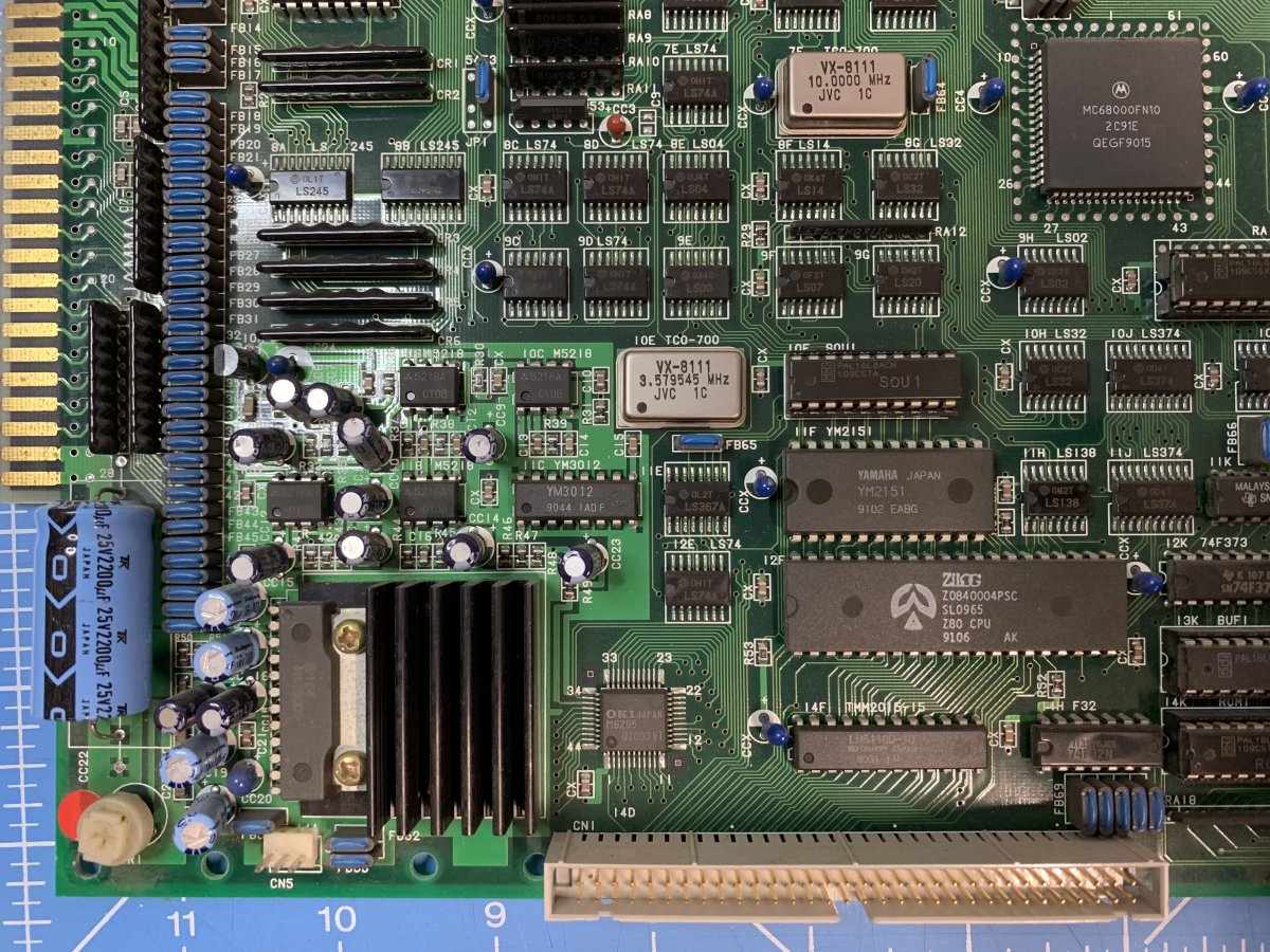

For those who didn’t know these boards are suspected as leftover CPS 1.5 boards (no mono audio section) that are salvaged and have the audio section populated with cheap parts.
troubleshooting this will prove difficult as the parts are not original. I believe someone has tried this, but my initial thought is to transplant over the audio section from a dead donor A-board. Thought I’d start a thread. Calling @RealMFnG and @Kujako if they has some insights.

Afrer the caps that what is missing? Maybe resistor array and transistor?
Missing caps, clone parts. Where to start? 😆

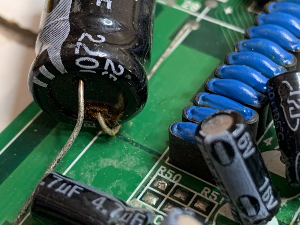

Leaky caps already. Geeze, these people have no shame.
Might just try replacing the capacitors? That's something I'd not gotten to on mine. Could be as simple as that...
Lets call em crapcom boards. Better yet , chapcom im honor of chamma. Doesnt look horrible. I would be curious to see the bottom as well.
I transplanted the 2200uF cap and the YM2151 IC to the bad board; no help. Man, these ICs are TOUGH to get off. A lot of flux and a lot of wicking. Desolder station isn't helping much; might need a narrower tip. I'm hoping it's not any of the surface mount chips; i've done one of these, but had to cut the old ones off. Might have to invest in some low-temp solder.

As is often the case with these rebuilt boards. It's all really strange. The diode on the KA51 is going in the wrong direction if I recall. There's been some major rewiring of the audio section, in ways that really make little sense. And there are a lot of boards like this, so it's something that's done often for reasons unknown.
