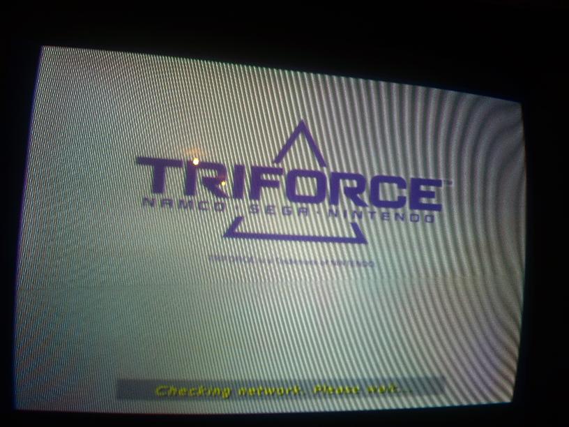

Boom!
Replacing the 19 caps on the baseboard did it.
