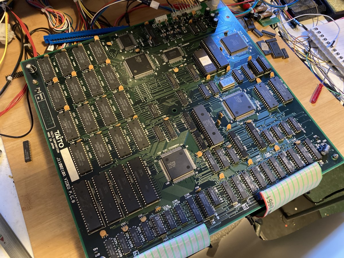

Got a Chase HQ SCI pcb in recently to fix up. Love this game and want to run it on my chase hq upright as an alternative to the v1 game. This one I played more int he arcade is think back in the day.

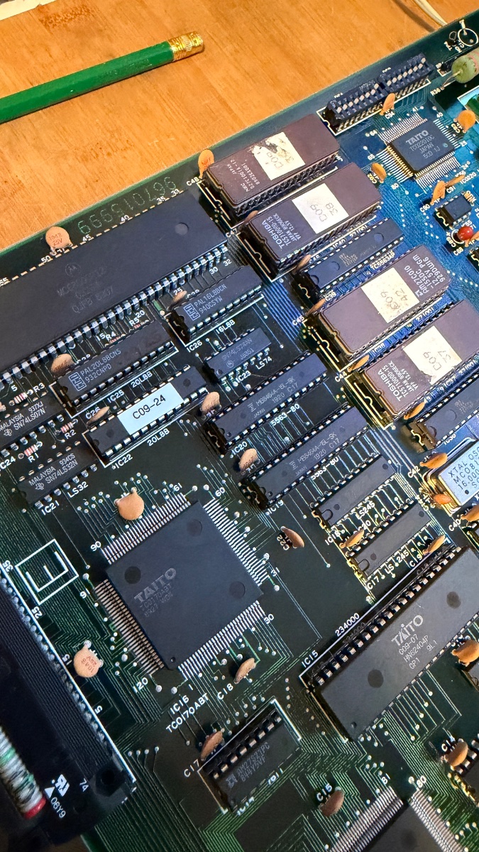

The thing is dead, so looking about in case anyone has fixed these before or has suggestions. I have a clock pulse to the main 68000, main roms (4 of verify ok). Reset chip is working. Reset line to main 68000 is watchdogging. I am trying some replacement pals C09-25, C09-24 and C09-26.

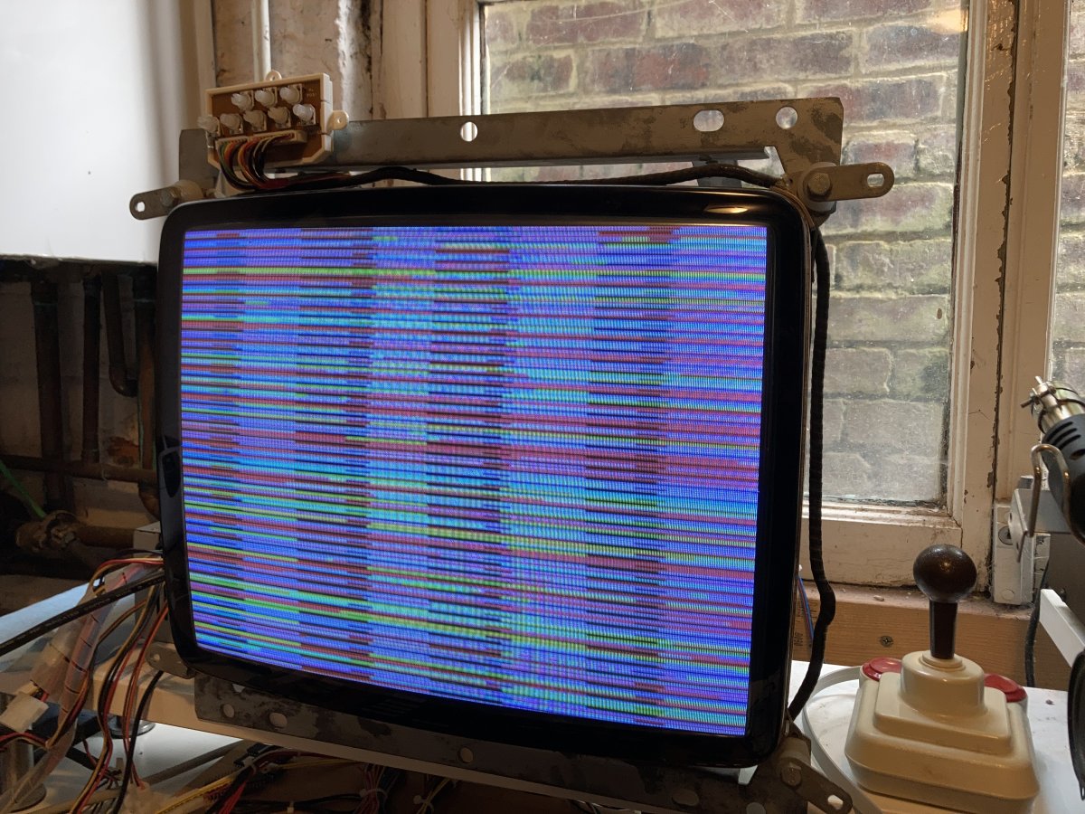

Update on my board. I am stuck and cannot get passed a watchdogging reset line :( I changed the TC0220IOC ic but it didn't cure the problem. :( I was hoping the reset part of the ic was simply to take a couple of inputs and then output a reset line if these were present but it seems its more complex than this. Frikin stupid design!

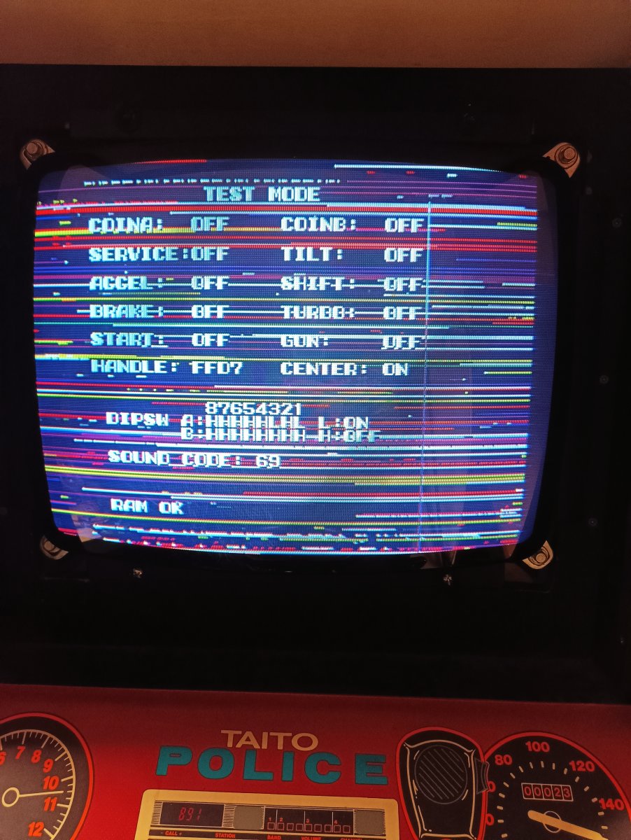

The only thing i get on screen is a bad sync screen as below

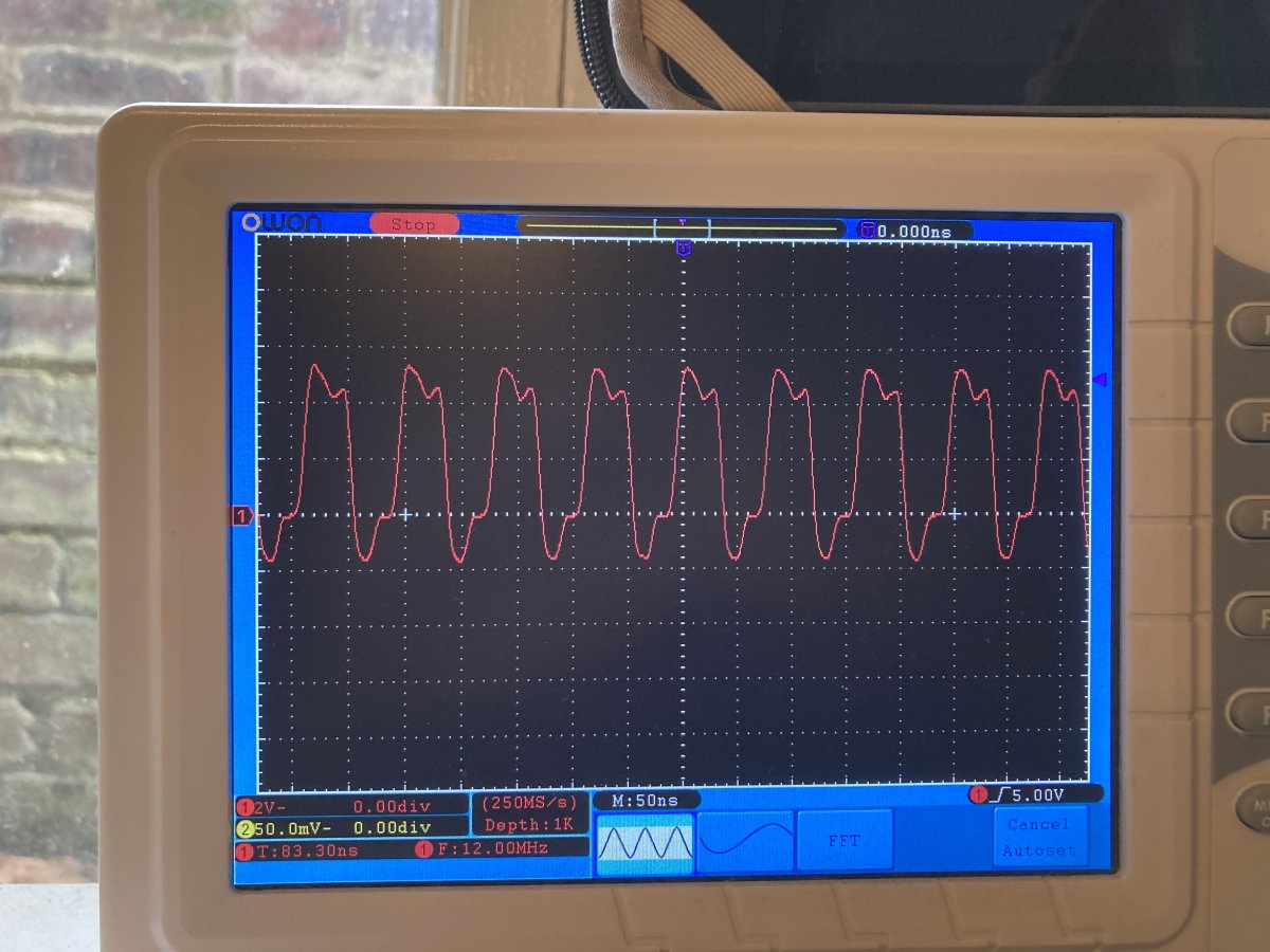

I scoped the clock signal which was ok to the cpu at 12mhz

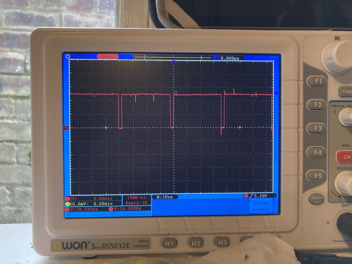

The reset output from the tc0220 looks like this
Not good, but i guess it shows the tc0220 is working
The only other thing inputted for reset is this video signal. Im not sure if this is ok or not. Hard to determine from the bad schematics what this is from.

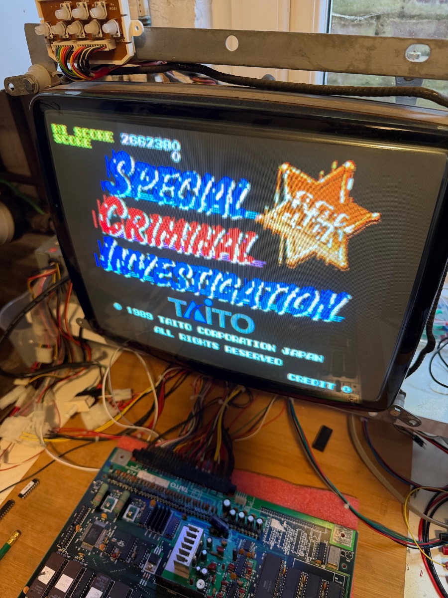

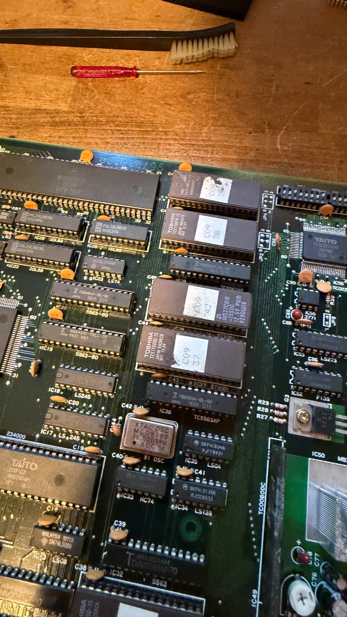

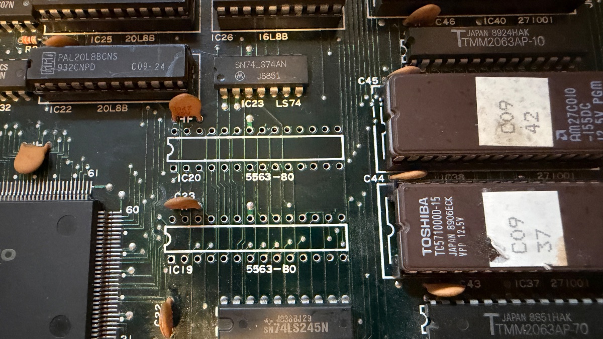

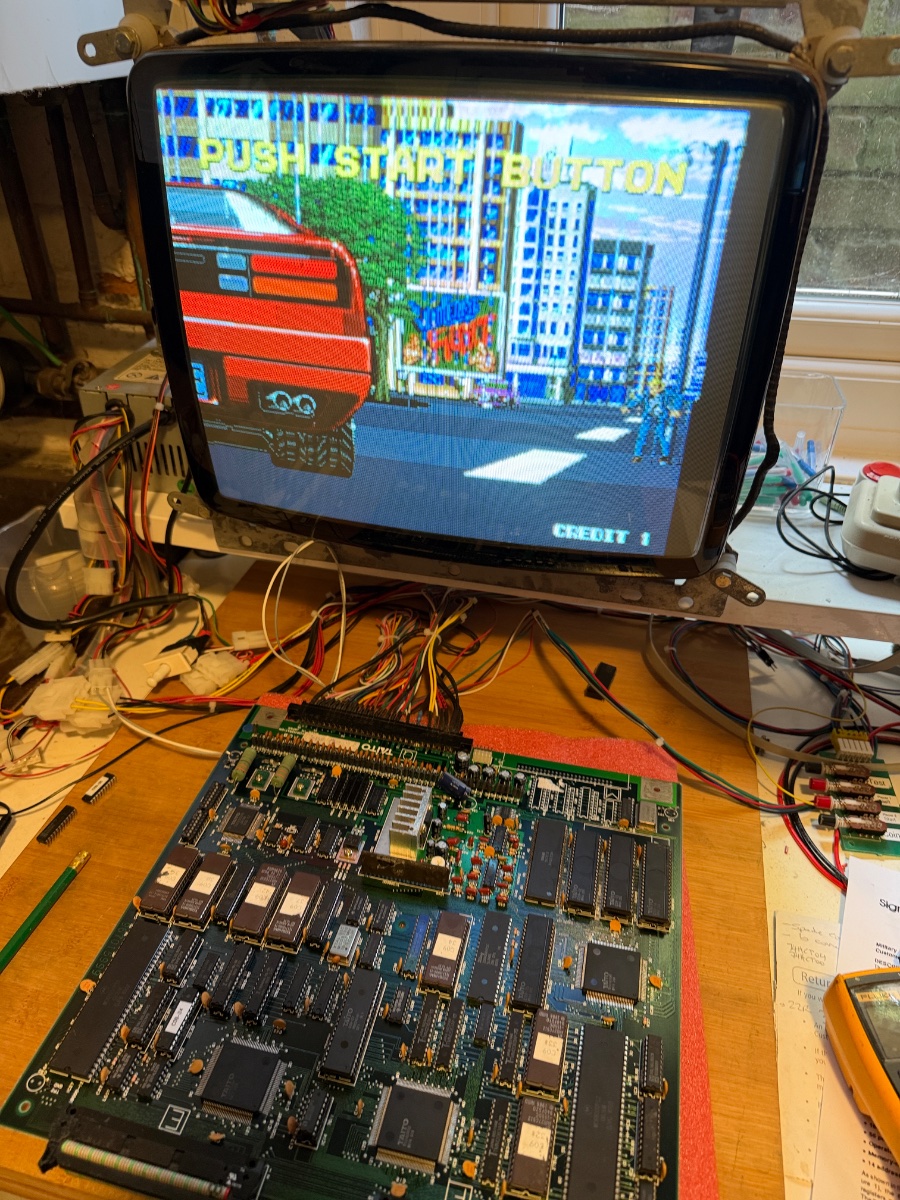

Mypinballs. We seem to have same symptom. Today I got my SCI to boot. Problem was a faulty TMM2063 which I think is used for the main program. That is why my board booted over and over, it read empty or corrupt data.
Have you tried to piggyback the RAMs at the main program ROMs?

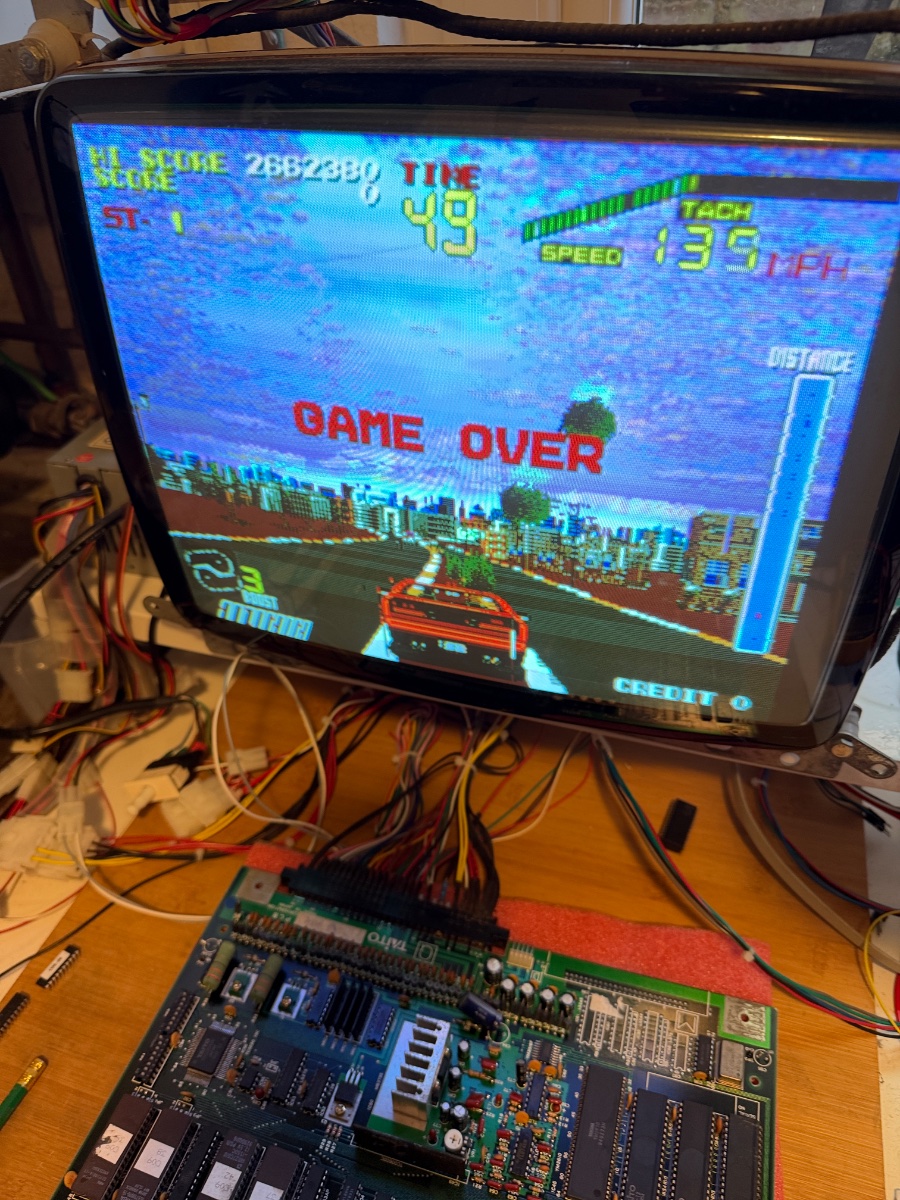

(Still some graphical issues. I know one ROM is bad and is waiting for some new 27C400 to arrive. I'll eventually start a new thread for updates)
