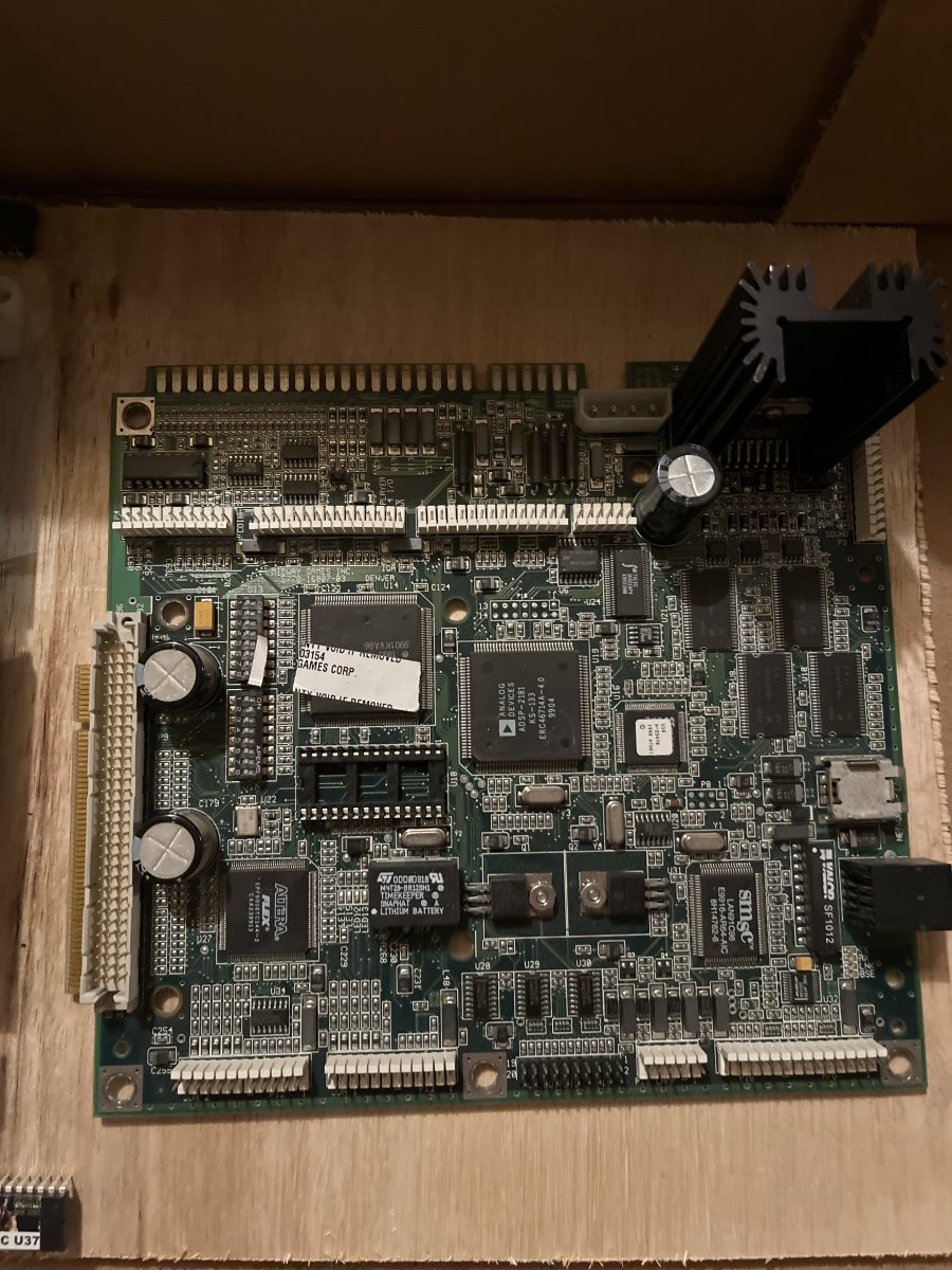

Hi all! Working on a frankenvegas, I ordered an I/O board for it, the person said it was a Vegas I/O, and I can’t tell what it’s from, but it doesn’t have a standard U37 PIC. Can anyone identify this IO and determine if it’s compatible with gauntlet dark legacy?

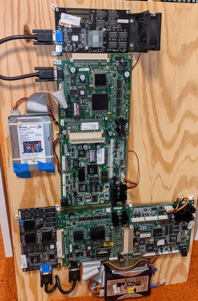

I don't have any intimate knowledge of Vegas hardware but these are my two Vegas setups if it helps. I can take closer pics if necessary.
The top one is an older Blitz/Showtime upgraded to Sport Station and the bottom one is Gauntlet Legends upgraded to Dark Legacy.
Your board says Denver above component C14.
I believe these were used with rush 2049, cart fury, and road burners 👍
Thanks. Anyone know if they can be used as I/O substitutes for the Vegas? I’m assuming no.

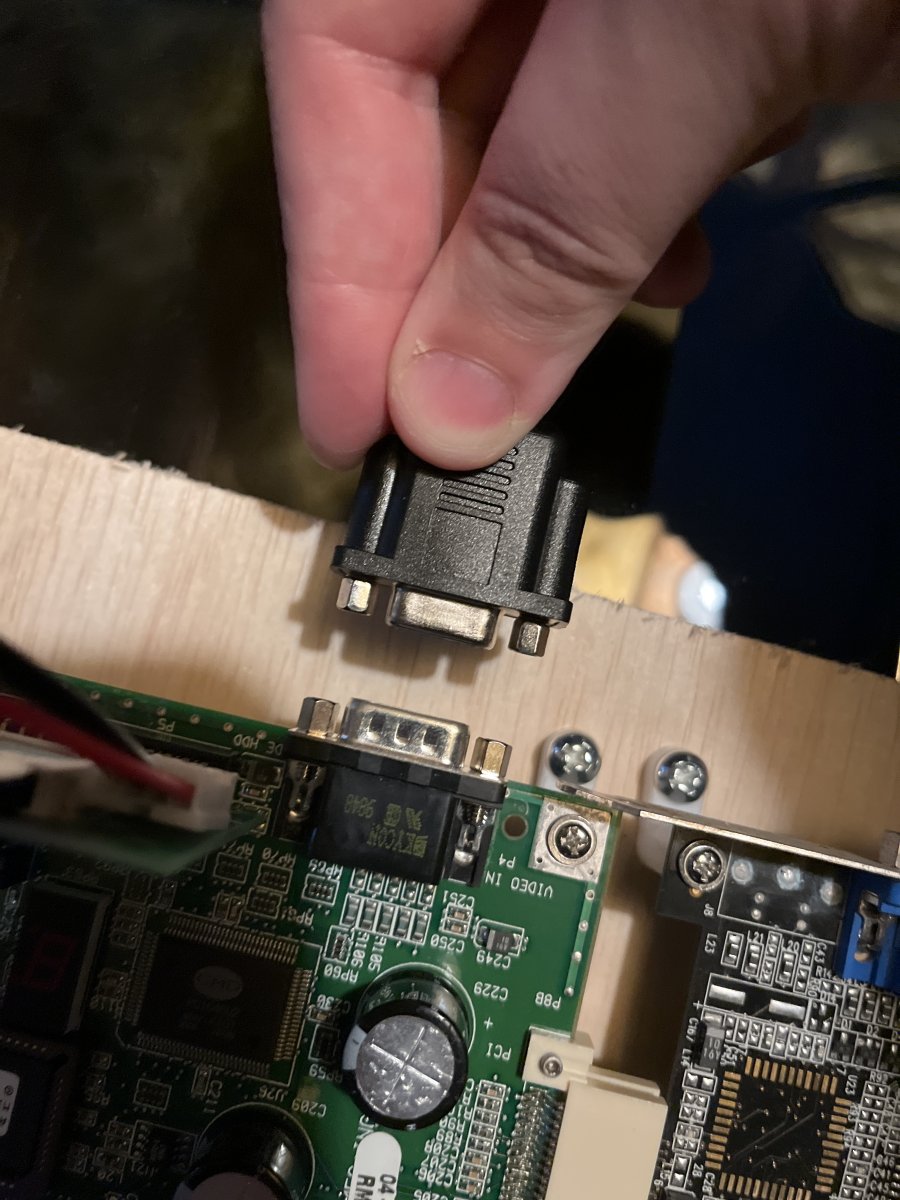

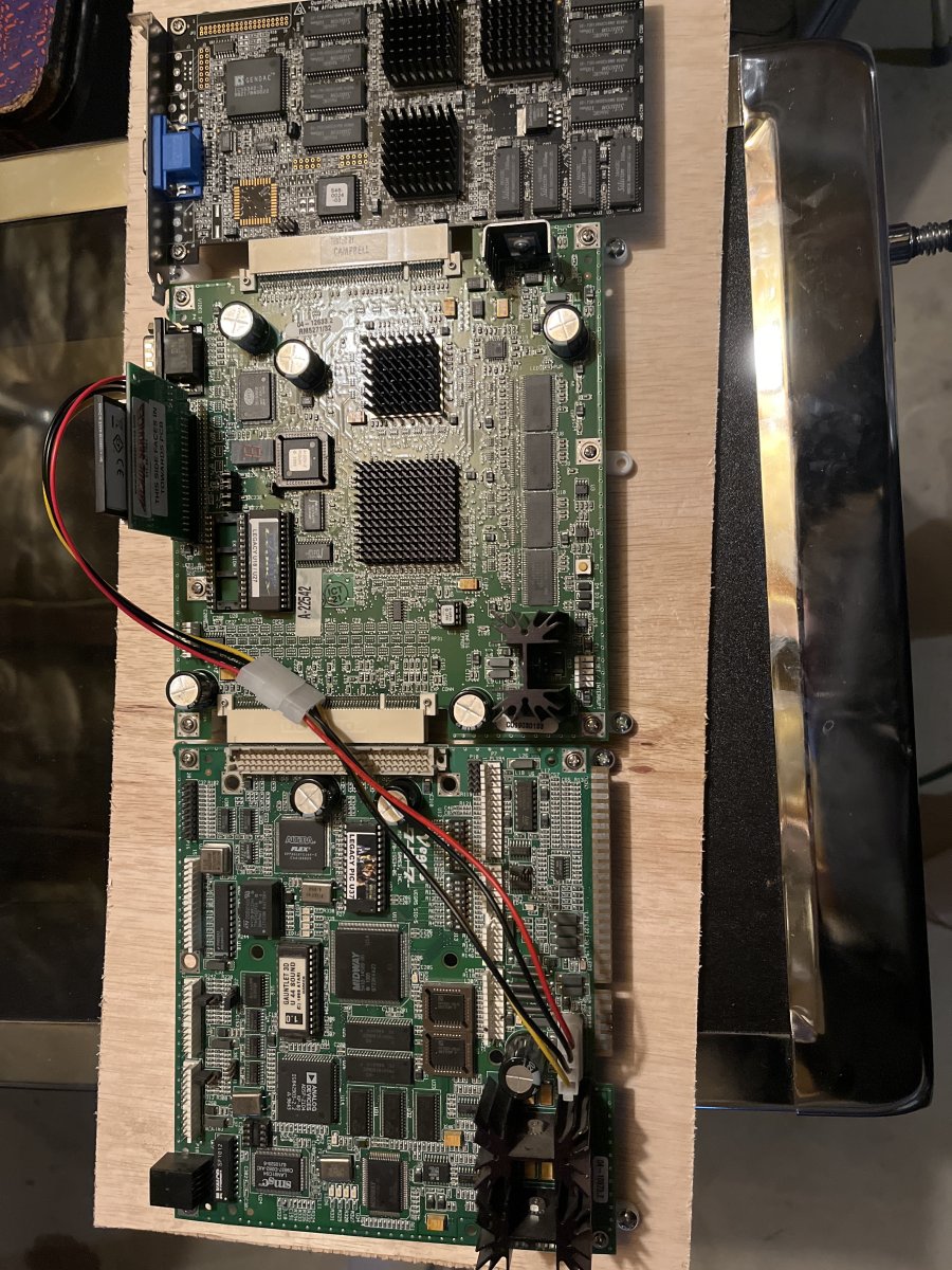

Got it ready to go except for the VGA connector and the fan/cooling solution.
Any suggestions for either? I have a 1 foot female to make VGA but it has the screw connects coming off it instead of the screws.
You could get another VGA cable or just unthread the nuts from the VGA port on the board. The specific VGA cable you're looking for is from a Voodoo card.
