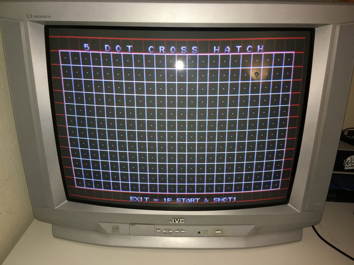

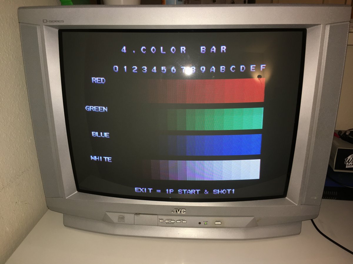

This one is a bit of a dud. It had a bad red tint when. I first got it. I turned down one of the red settings in the service menu to help. I couldn't get an acceptable black level without crushing the image.
The attached images are through s-video after eyeballing the brightness, picture, and color settings in the tv menu.
Maybe there's hope for it, maybe it's junk. I'm just ready to be rid of it.

Likely just need rejuvenating. I got great results rejuvenating a JVC tube recently.
