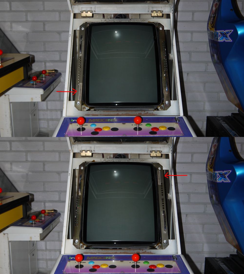

Sometimes I have the opposite problem with my Madonna. The screen rotates opposite of modern cabs so some boards don't have a reverse option and I can't flip it the other way
I have a Madonna as well. What do you mean the screen rotates opposite of modern cabs? Counter-clockwise is standard rotation.
And what's stopping the Madonna from rotating both ways?
The rotation problem should only affect cabs with rotation mechs.
The Madonna rotates clockwise if you want to go vertical. You can't rotate it the other way because of the design of the frame.
I just rotated mine both ways for you:
Has that just been some long-standing myth then?
Do the Exceleenas also rotate both ways?

Think of the better ventilation you have with the back out?
Anyway, my bad. It's been a while since I messed with this cab.
There's two positions for the support bars on the monitor. You have to swap them for counter clockwise rotation. You also have to mount the chassis and remote in a slightly different way.

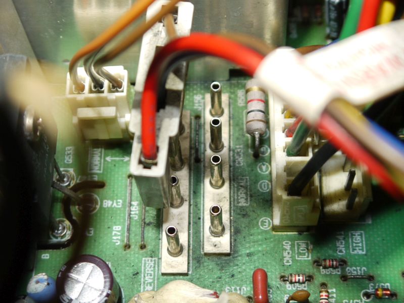

This said, don't do this. It's dumb, and I'm dumb for ever doing it. Just swap over the yoke leads from 'Normal' to 'Reverse'. The connectors are perfectly accessible from the back:
Just mind the heatsink, that can get pretty hot if you had the cab just turned on before doing this.
Yes i also switched the yoke leads from the "normal" position no "reverse" on my Aero City with MS8-26
same here... i have both of my vertical aeros in CCW tate, but I put one of the yoke connectors on the reverse option for Namco games.
