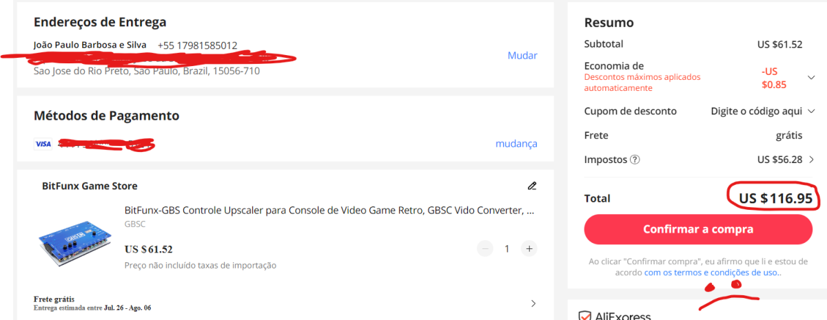

Very expensive for Brazilians 92% tax :cursing:
