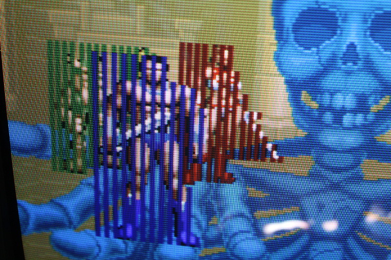

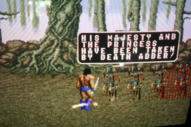

Golden Axe with faulty sprites repair log
pacoarcade
Oct 16, 2018
518
474
Spain
Got this golden axe with wrong sprites. My first thought was faulty custom chip or faulty rams so I ran the tests but it showed GOOD. Since this is not conclusive I used a working B board with this A board and I was happy to check that it worked flawlessly, whoohoo! 8o
Then I extracted B1...B3 and B4...B7 roms (27C020) and compared MD5 checksum against the mame set. B2 and B7 were bad, so I burned new eproms:
  • mpr-12380.ic10 for B2
  • mpr-12383.ic14 for B7
It fully fixed the problem. Repair done! :)
