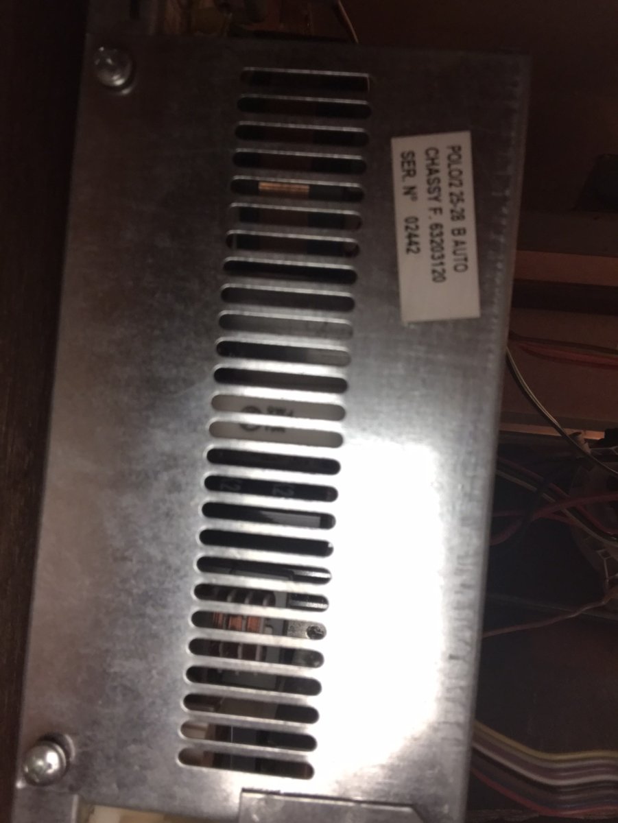

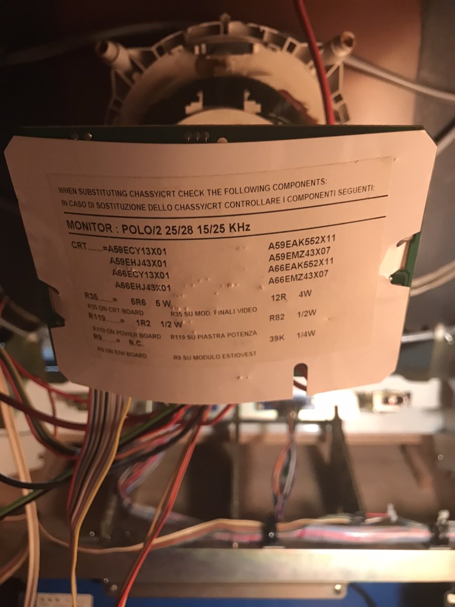

Hello there,
I 'd like to maintain my Hantarex Polo/2 25-28 15/25kHz AUTO Monitor (which giving issues - i ll create a separate post for this) by changing at least the components that are aging over time, mostly capacitors, on the main, control, crt socket, switch and e-w boards.
Do you have a couple of good references/websites/vendors from which we can directly buy a reliable and relevant set of components (aka capkit) for this specific version of the hantarex polo monitor (/2 25-28 15/25kHz AUTO Monitor)?
Cheers
Regards
Eric

So many revisions of this chassis that I personally wouldn't trust a cap kit. All of the caps are numbered, so just jot down the values of each and order replacements from TME, Digikey or Mouser?
