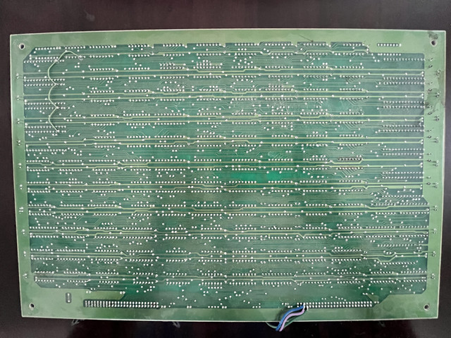

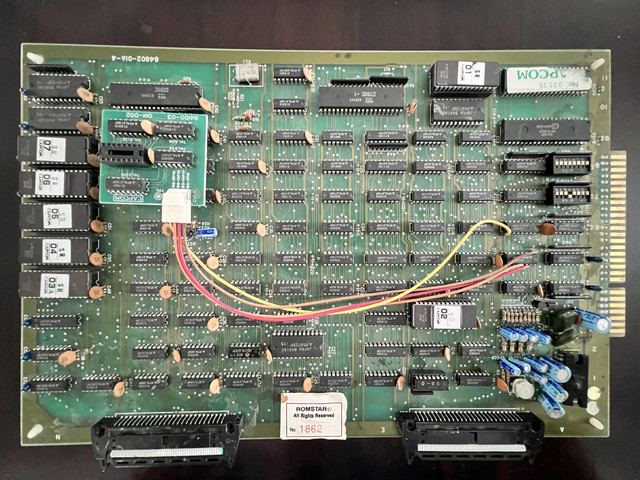

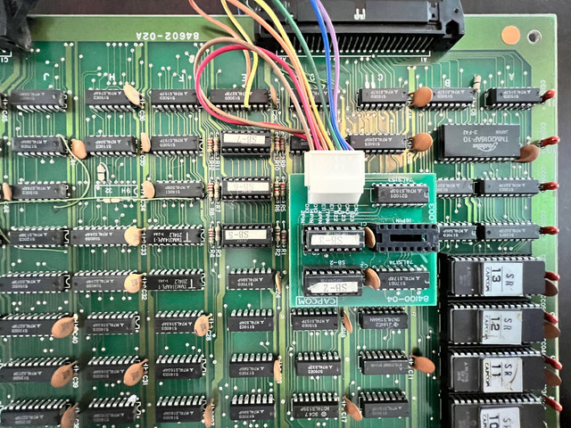

Has anyone seen a Capcom 1942 PCB that looks like this?

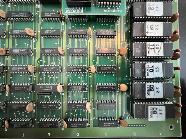

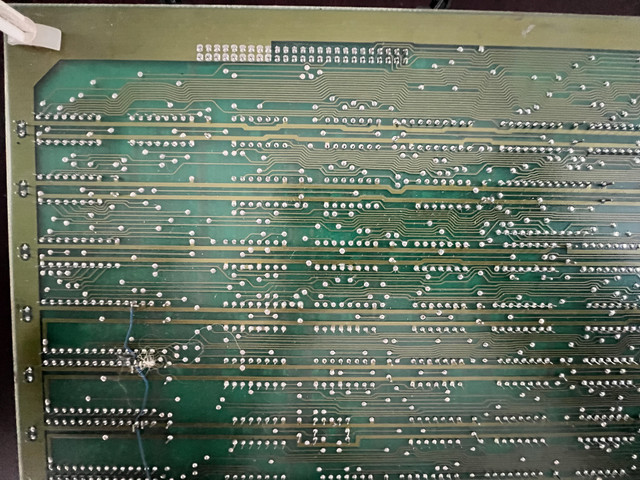

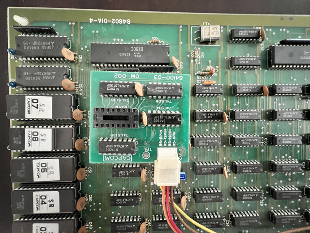

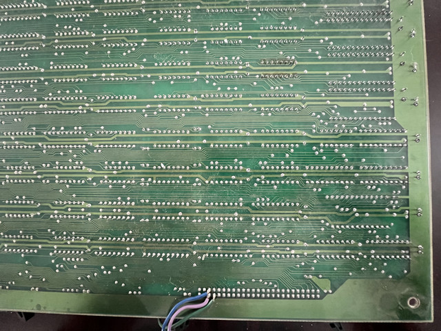

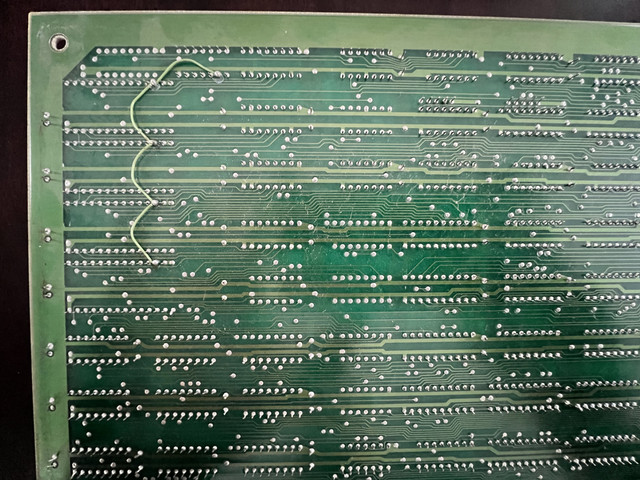

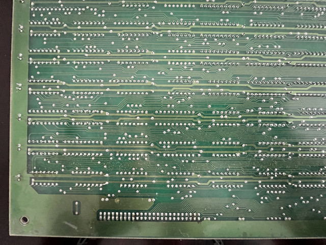

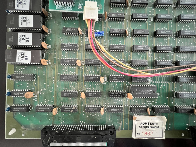

Got this in a pickup, an I can't currently test b/c I don't have a JAMMA adapter for it, but it's got a bunch of extra things added to it, like chips, boards, and wires. Is this a major repair job or is something else going on here?
pretty confident mine doesn't look like that. Is that a regular jamma edge, 1942 isn't jamma...
Can verify later
I have a 1942 that looks the same, figured it was legit as it seems factory. Vulgus makes sense, I can check with my own
Can verify later
The edge is JAMMA sized but NOT JAMMA, don't mistake it as it's bad juju to plug it direct into JAMMA.
Now I have to source an adapter to see if this PCB works.
