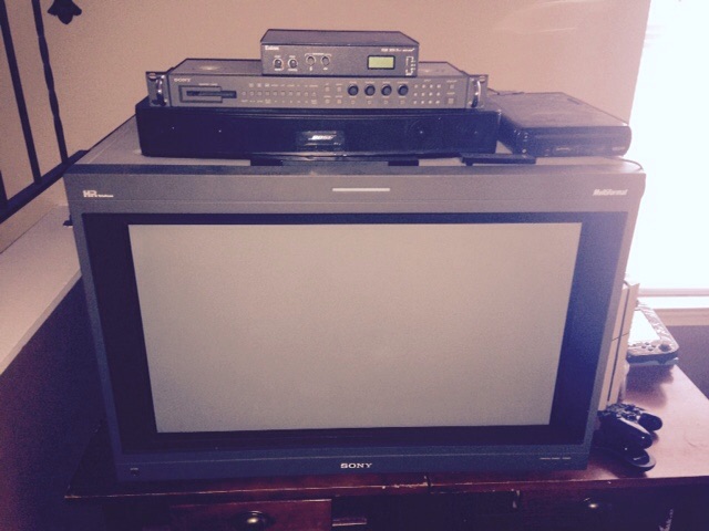

I was not able to get it working for the PS4 but every other console on the planet was a good to go.. You need an HDFury2 and rgb 20x like the one you see there.. The HDfury2 will convert the signal from digital to analog and the RGB 20x will sinc the signal to your PVM and according to the shmups guys there is no lag. The input will be to the RGB card in your PVM. This will give you the best picture..If you buy those cheap ass HDMI to VGA you get artifacts in the picture.. Trust me I did that first...The PS4 seem to be a difference beast no matter what I did I could not get a signal.. I tried disabling the security signal feature dhcp, going into the video out put and trying all the settings.. Someone suggested to boot into safe mode and disable the dhcp video settings from there and setting the ps4 to 720p.. I have not try that. Try it on and see what happens.. And Maybe start a tread at the shmups and ask about this.. I sure would like to know..
