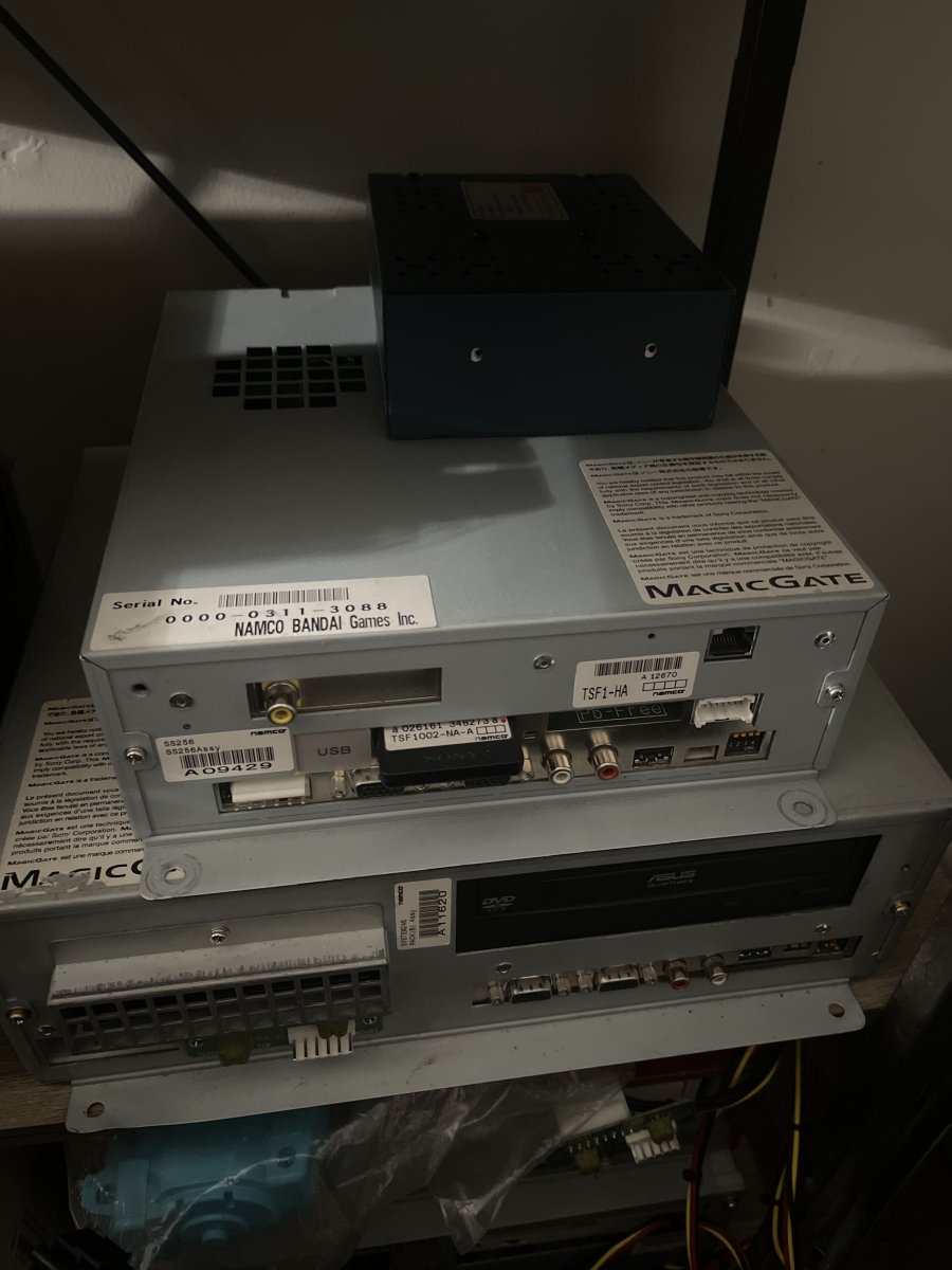

I want to buy a system 256 and play time crisis 4 . Anyone know which parts I should buy together with system 256? how to connect the parts (eg io ...), which gun can use for it .
I can help as I was like you and wanted a complete set! :) you need quite a few stuff and it can be costly but with enough hunting around, you can find some deals!
You will need:
Namco System Super 256 (the only system that can run TC4 unless you have the patched HDD file made for the normal 256)

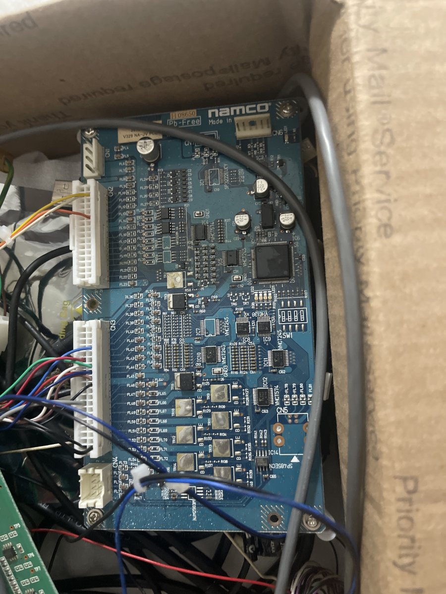

Namco V329 NA-JV I/O pcb. I haven’t tested if other versions work but the FCA2 I/O pcb that Cobra the Arcade used also works.
OMC-GZH200 Gun/IR led I/O pcb.

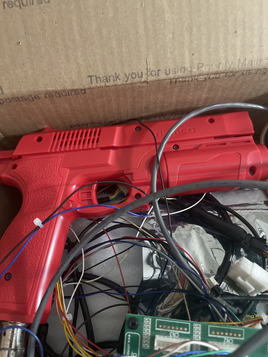

And the 10 IR LED pcbs, the complete gun assembly and the wiring. I had to do the wiring my self and it was a pain in the ass lmao! The arcade pdf manual is online and I recommend you follow the Standard cabinet manual as the Deluxe version is a bit hard to understand the schematic.
