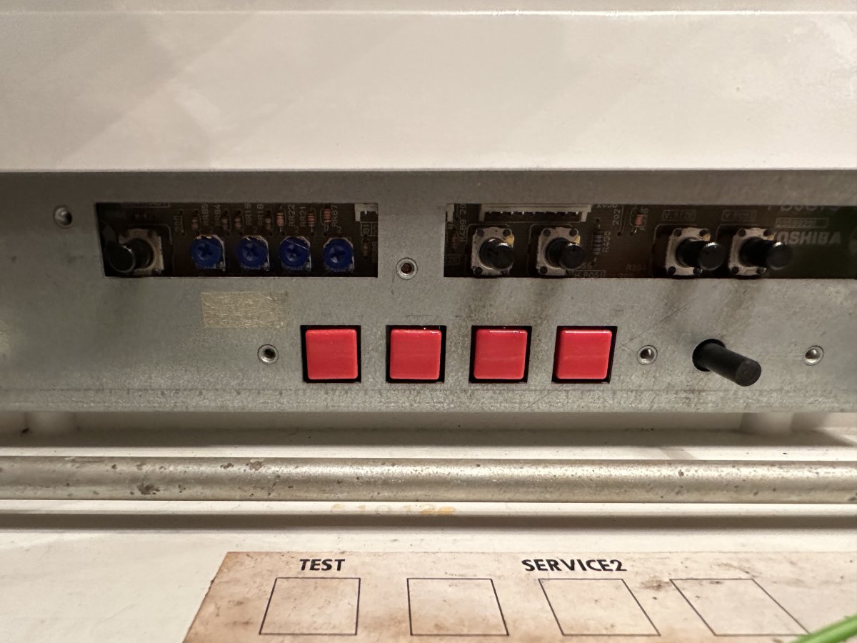

I recently bought a New Net City cabinet a few days ago, and it’s my first cabinet. I bought it for use with both 15K and 31K, and 15K works like a charm… however, it seems to not be able to take a 31K signal for some reason, even though it’s a Net City :p
Above is the image that results when I put in a 31K signal (Naomi). From what I’ve searched of online, this cabinet should be tri-sync, and auto-detects the resolution :(( I also can’t find any dip-switches to change the resolution like the Blast City. Any help whatsoever would be highly appreciated. Thanks

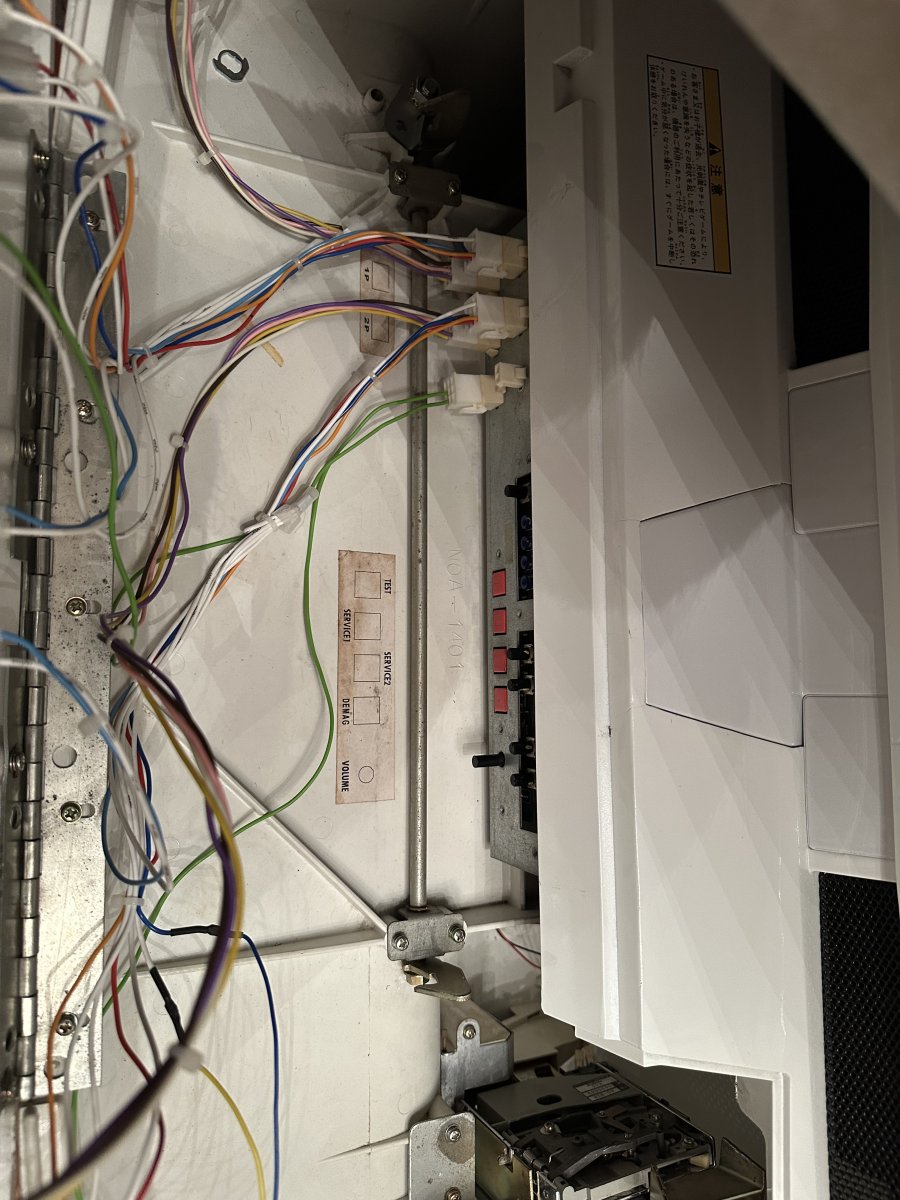

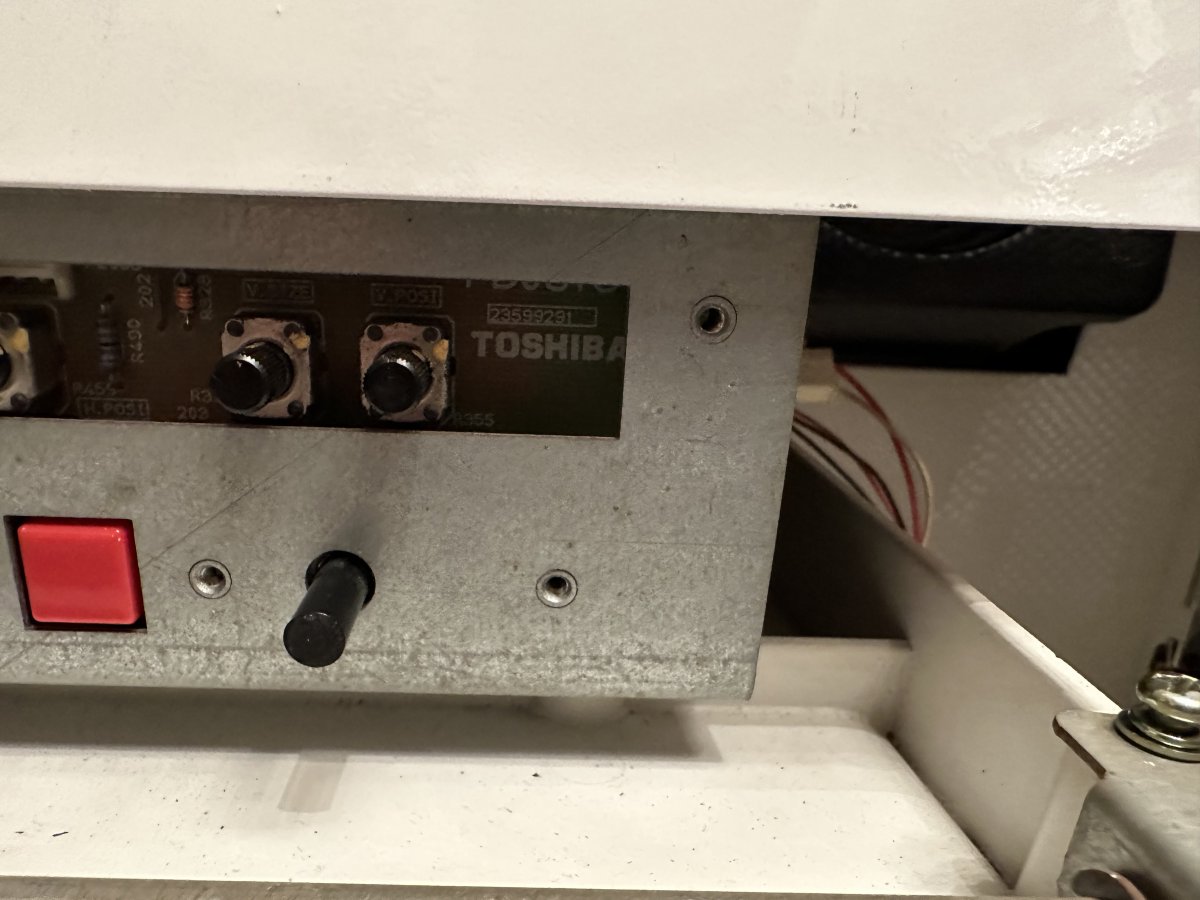

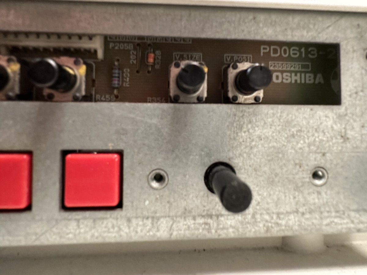

If its using a Pureflat chassis like factory (D29) it wont have dip switches to change that stuff it automatically finds the correct setting.
The remote board on this cabinet seems different from a normal D29 though can you get a better photo of it?
If this was a blast chassis (Ms2930/31) for example the dip switches for resolution would be where I marked.
Here it is. No dip switches in sight 😔

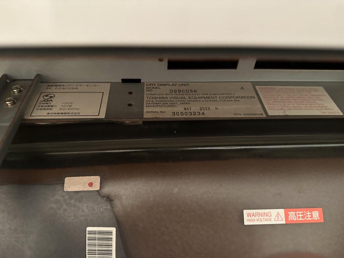

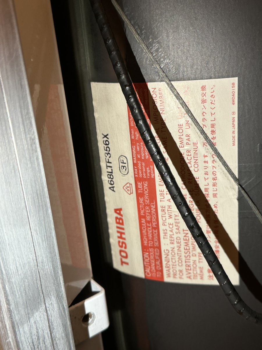

If the tube is a flat tube though theres hope. Check the part number on the tube and if its still the original flat tube you can just source a D29 and put in the cabinet.
Thanks a lot! Though I’m still a complete beginner to this, so I’m not too sure exactly where to look for the part number of the tube. It looks very flat and not curved at all from the outside though, so I think it’s the D29. I also sent this picture before, these stickers are found on the top metal part of the CRT, not sure if that’s the part number though. Are you saying it would work if I changed the chassis to the default New Net City chassis, given that the tube is the D29?
D29 isn't a tube designation of any sort.
The part number would be on the tube. It's a big sticker usually going up and down on one side of the neck or the other.
The sticker on the frame just tells you what shipped attached to the frame, won't tell you a thing about what's happened the past 20 years unfortunately.
https://wiki.arcadeotaku.com/images/6/6e/Toshiba_bonded.jpg
Expect something like this (though may or may not be Toshiba). You want the long Axxxxxxxxx number.

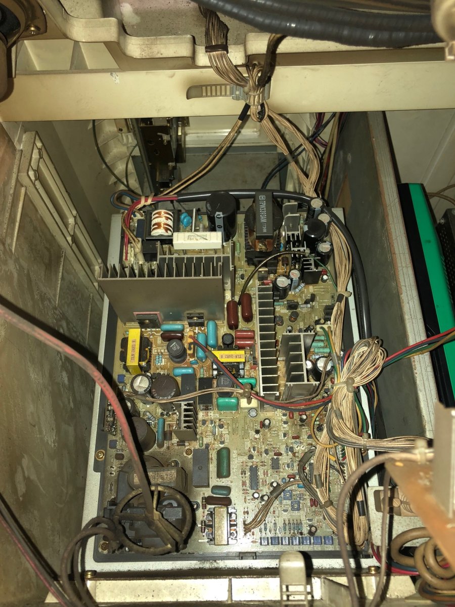

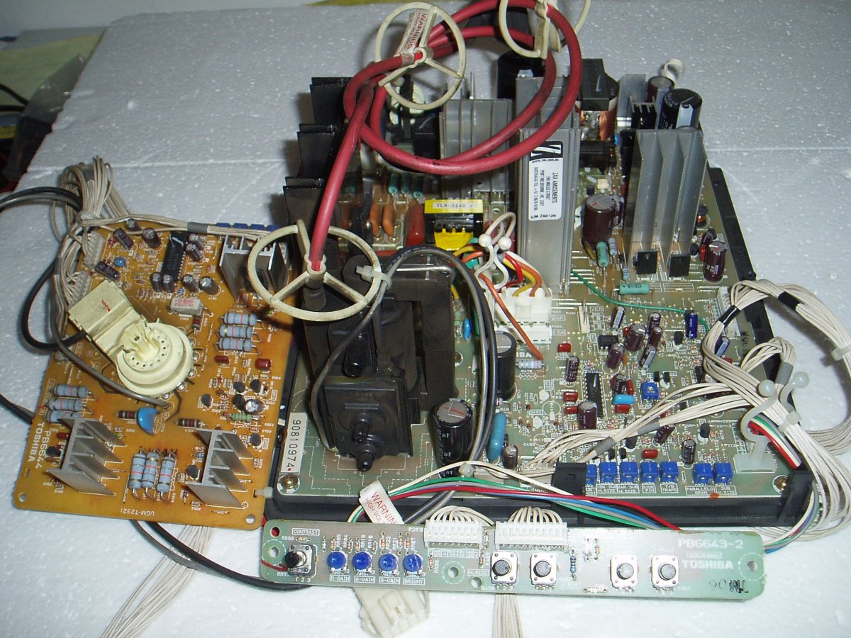

Does your chassis look like this?
Top view of Toshiba PB 7534 chassis (Best I could find….)

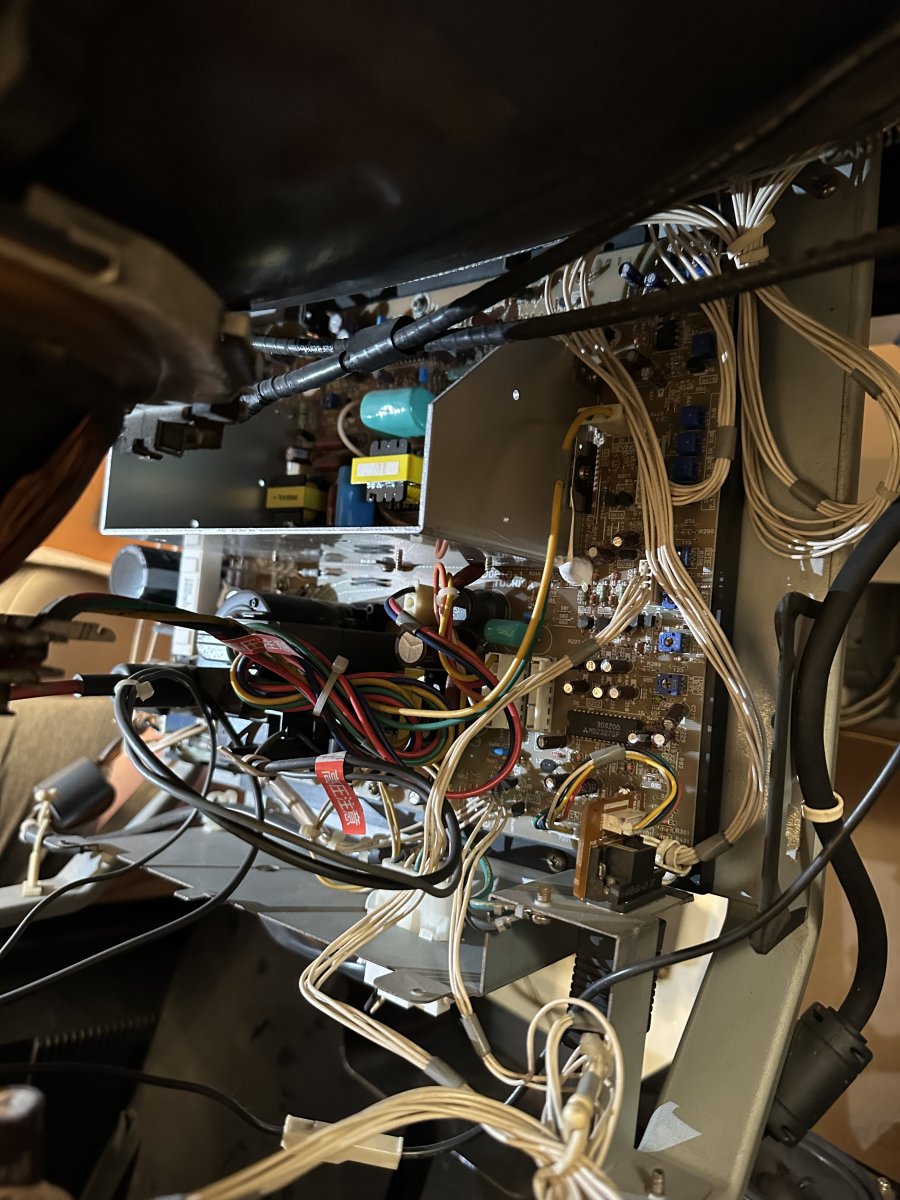

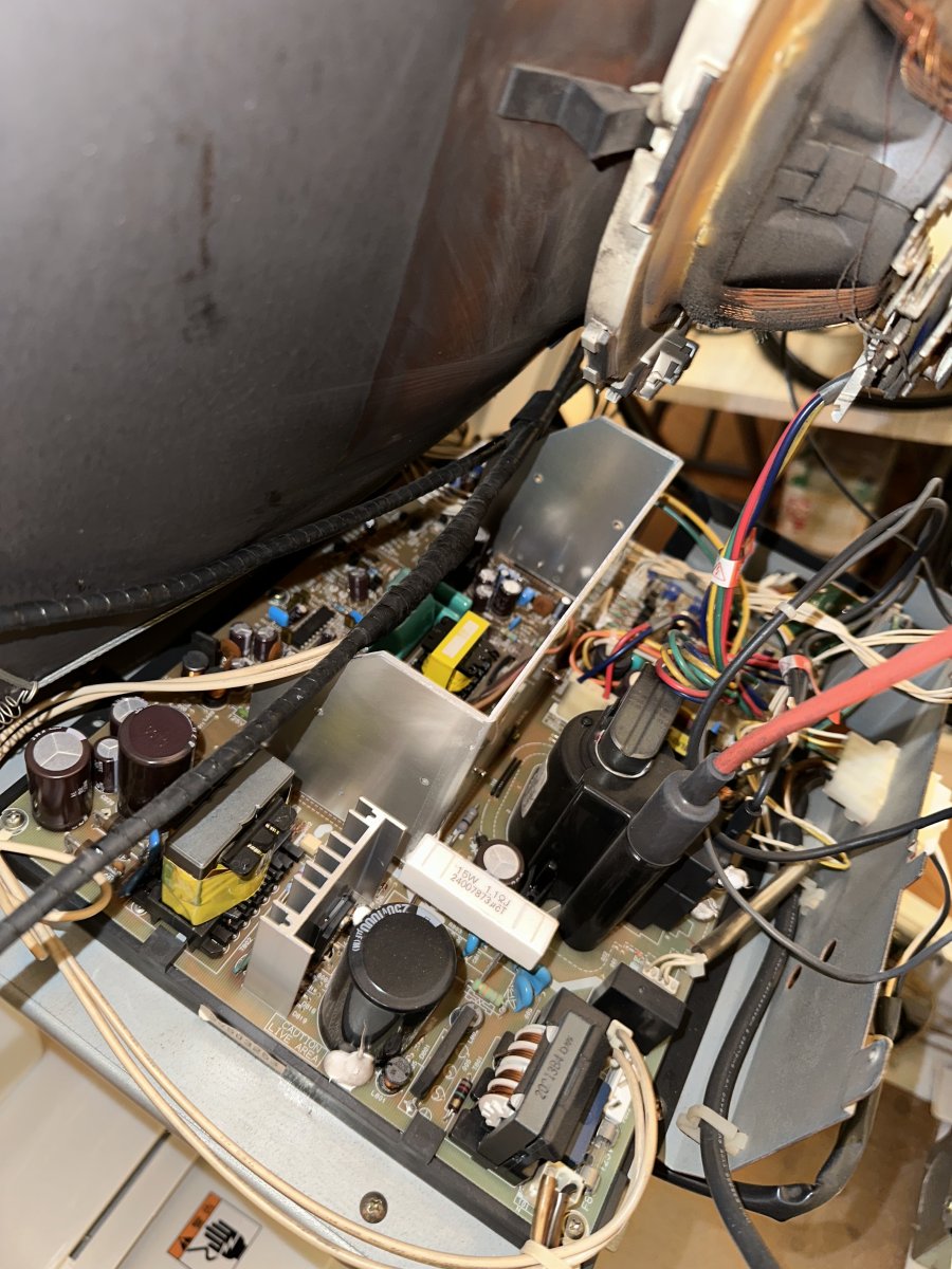

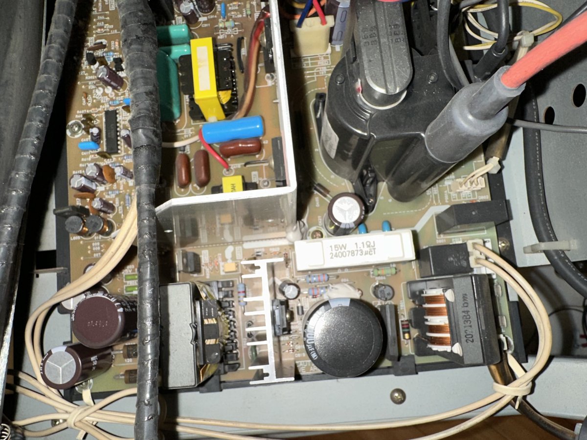

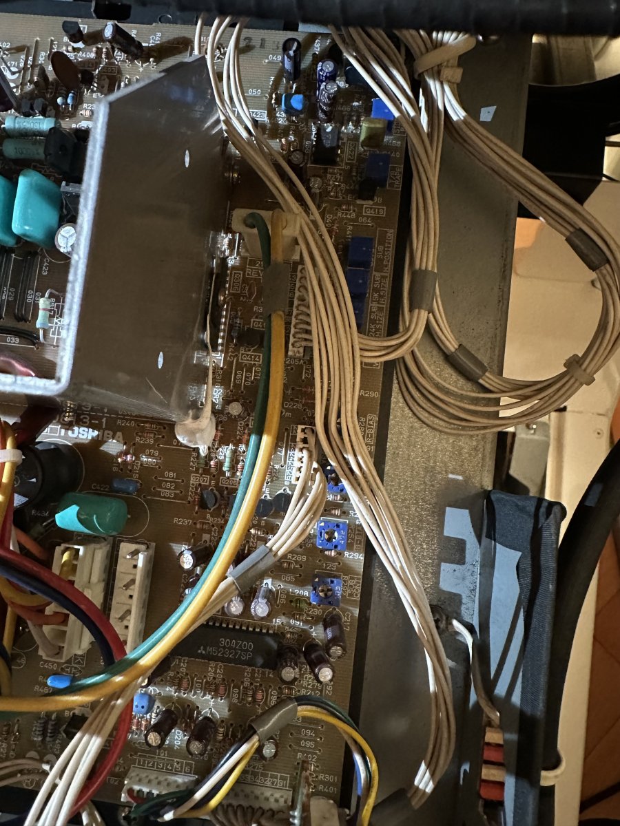

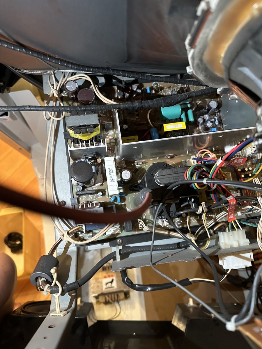

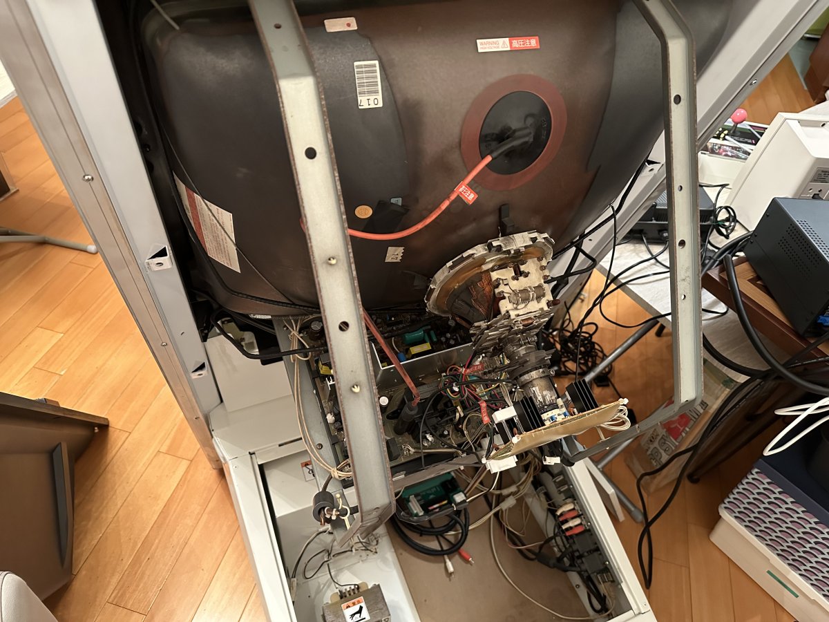

Sorry for the long wait! Here are some pictures I took. Is this the D29? And is the “chassis” supposed to be the pcb under the electron gun like my photos here? I’m not too sure

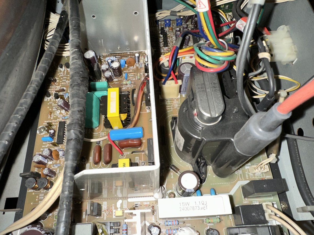

Chassis is the PCB under the electron gun, but I need bigger pictures ,closer up to the PCB to ID this chassis.
Sorry for the crappy pictures 😅

Your tube number is original to that cabinet though as far as I know. So If you want to restore the cabinet back to a tri sync D29 monitor you need to find one of the Toshiba chassis's to pair with it.
Otherwise you cant run 31khz signals into that monitor chassis you have now.
If your using something like a Naomi you can change the resolution mode to 15khz and still use it you just wont have 31khz high res
So one of these should work.
Toshiba PB9929
Toshiba PD1843
Toshiba PD2367
Toshiba PE0493

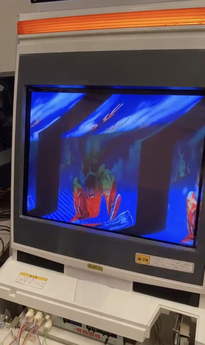

Thanks a lot for all the help guys! I really appreciate it! I contacted the seller and he’ll try to find the New Net City chassis for me. In the meantime, I’ll enjoy myself some 15K content! You guys really saved me as I was feeling desperate.
