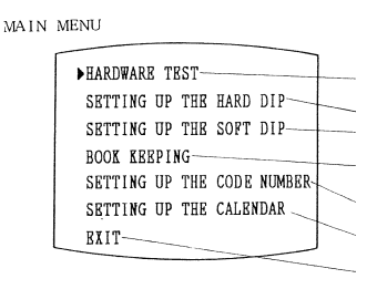

ok, so i got the board to a state where there is just a calendar error. I believe the D4990 needs to be replaced. With Unibios i can get to the cross hatch and all the tests run fine now. I replaced all work and backup rams and 1 video ram. The palette rams were fine. No failures are reported in any of the tests with Unibios or the Diagnostic BIOS 0.19.
However, when i put a game in, i can do all CRC checks which report back fine, but i am unable to get past the mode setting screen. When i select exit, the board reboots with Unibios and back to the mode setting screen.

yes i've verified that through multimeter as well as from the unibios hardware DIP test screens
@xodaraP Thanks for the hint. That completely makes sense now why unibios was showing me the test screen. Checked Pin# 14 on the solder side (Service Button) and it was low. Compared it to the other buttons like up, down etc. They switched to low when pressed, so you were right, the service button was stuck low.
Traced it to the resistor pack just next to the clock chip D4990, and noticed that I had soldered the resistor pack backwards. I had originally removed all chips and components around the battery area when i was trying to access the damage on the board. I put a socket in and corrected the orientation of the resistor pack and now with Unibios, the game boots. All buttons work and there are no failures reported by the Unibios tests or the SMKDAN diagnostics 0.19.
