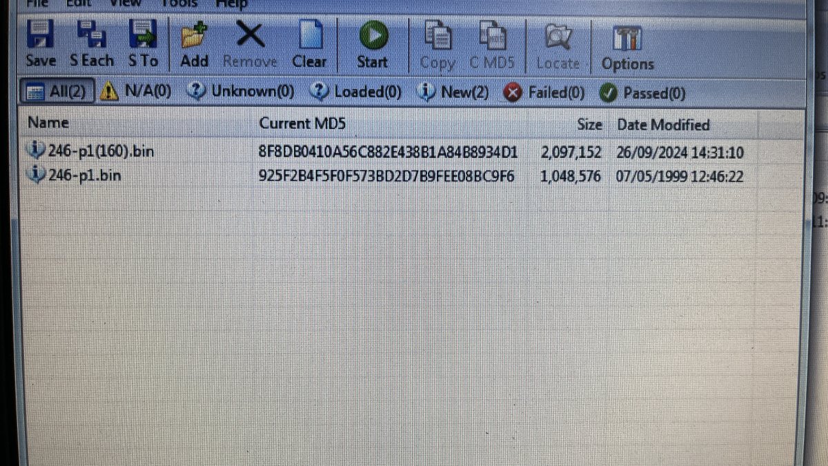

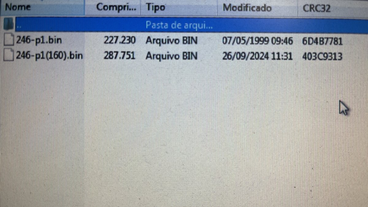

Tried romwak and copy /b but I can’t get the same crc for both files, at least not the same md5, winrar crc32 not the same crc too
