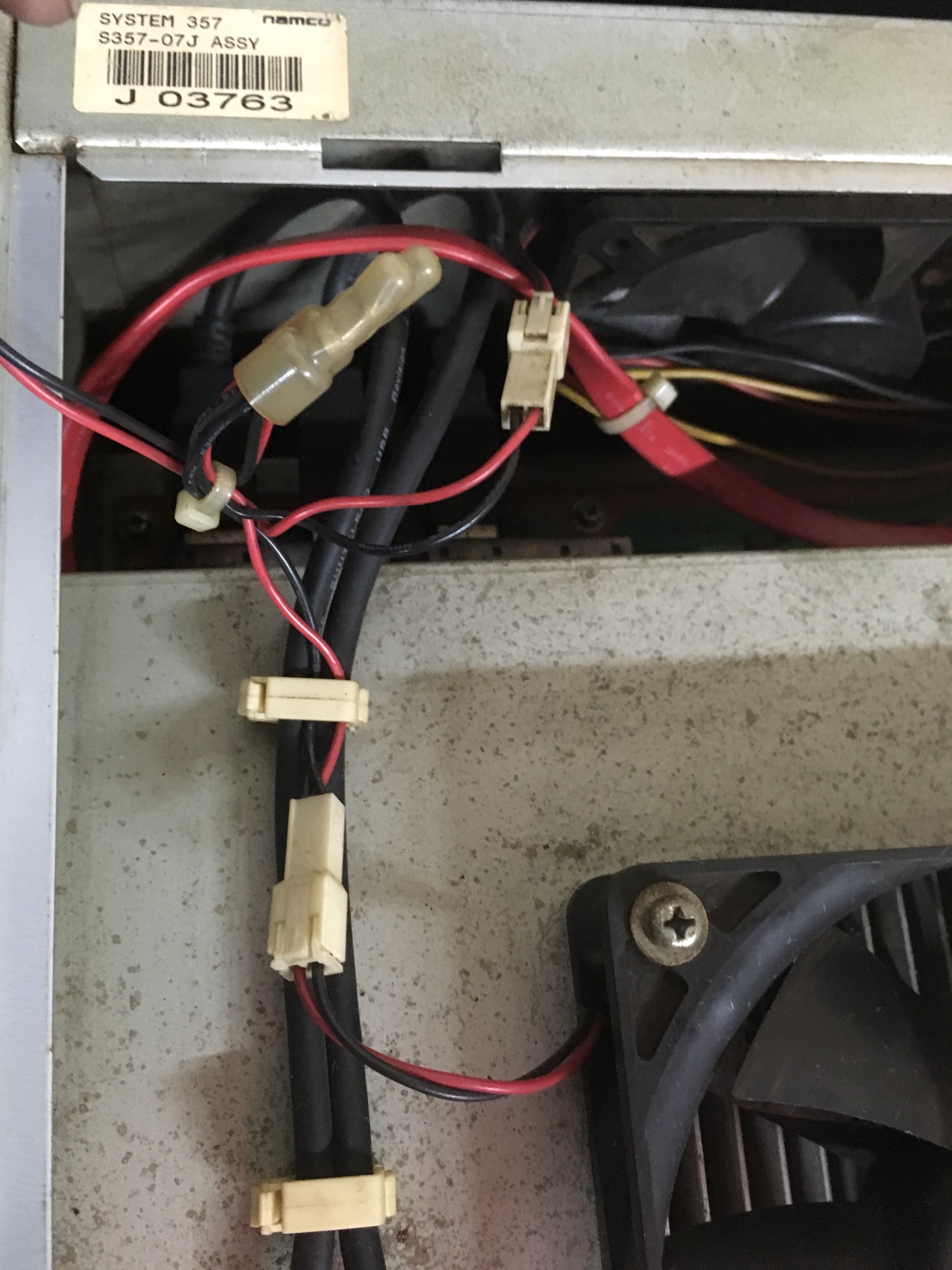

Howdy,
I picked up a System 357 Bloodline Rebellion system. I'm sure the thing is dead, but I took it apart hoping to learn a thing or two. I took the thing apart, and discovered that a +12v header seems to have been ripped of a PCB somewhere, but I could not find where it should have been attached. This prevents supplying the fans with any power. The Bloodline Rebellion manual I found online doesn't really indicate where this should be mounted. Does anyone know where this is supposed to go to?
Thanks for the reply @Mitsurugi-w. I'll get better pictures tonight. But that connector leads to a bundle of crimped wires, that then lead to the 2 120mm fans. But I took the system apart and went over the different PCBs but didn't see a spot where that header was separated from.
I had a look at my 357 that is waiting to be re-balled last night but couldn't see the header that you have pictured anywhere. I will have another look but I could see any obvious place it could have come from without pulling it apart further.
Thank you Mr. @Blackfish. That’s what I found as well. No obvious place where it leads to. When I get home I’ll take better pictures. If you do take it apart, can follow the fan leads and see where they go?

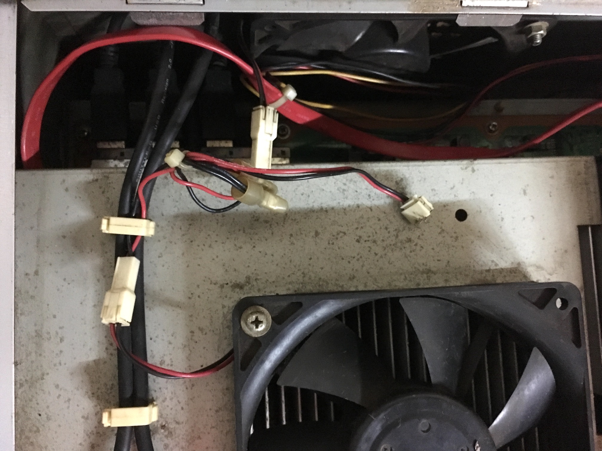

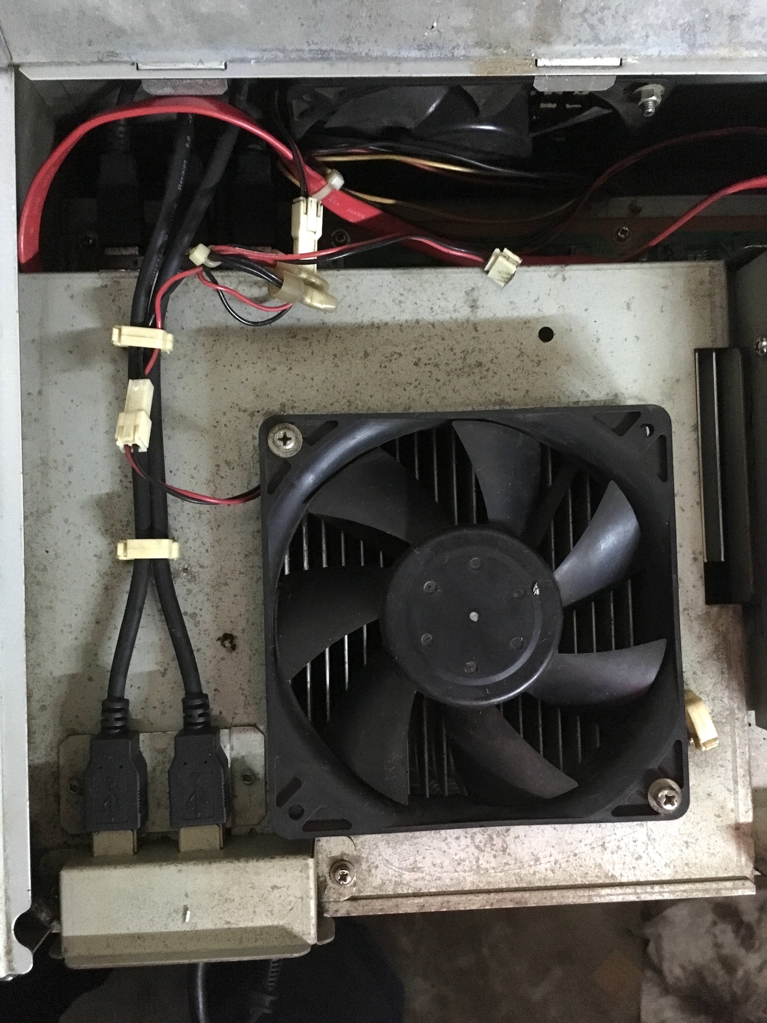

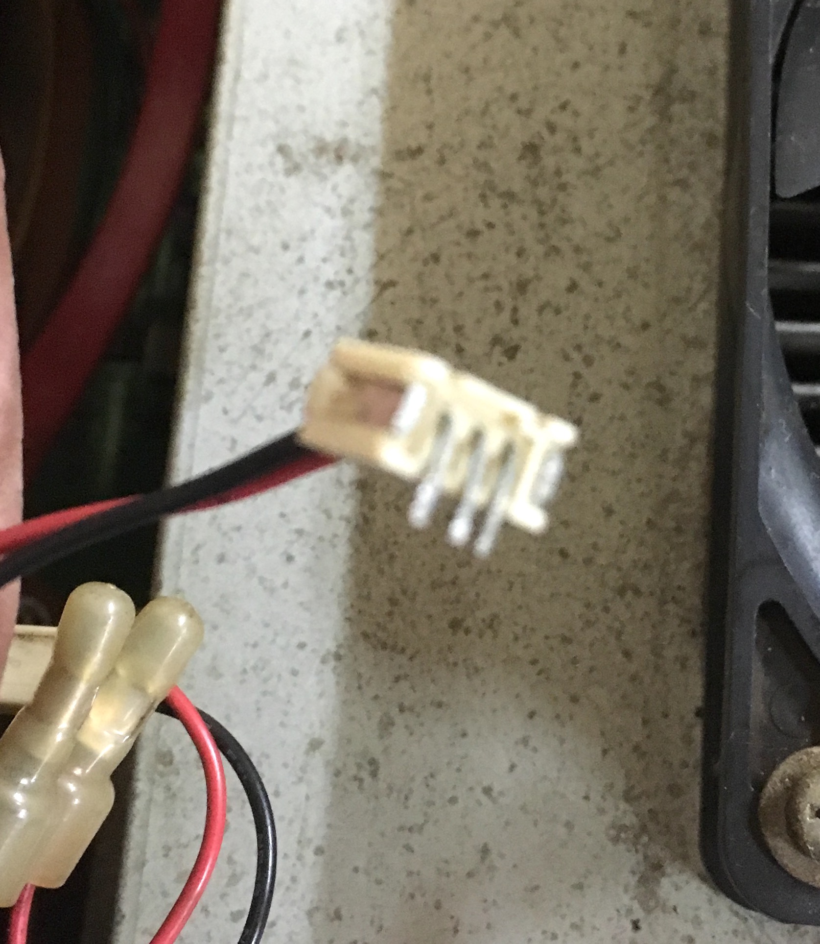

Here are more pictures of the fan wires and the loose header:

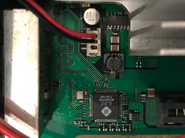

@Blackfish were you able to look at your system to determine the power source for the fans?
Sorry I got sidetracked and totally forgot I was going to do this.
It is from directly behind the USB connections. Here's a couple of photo's.
