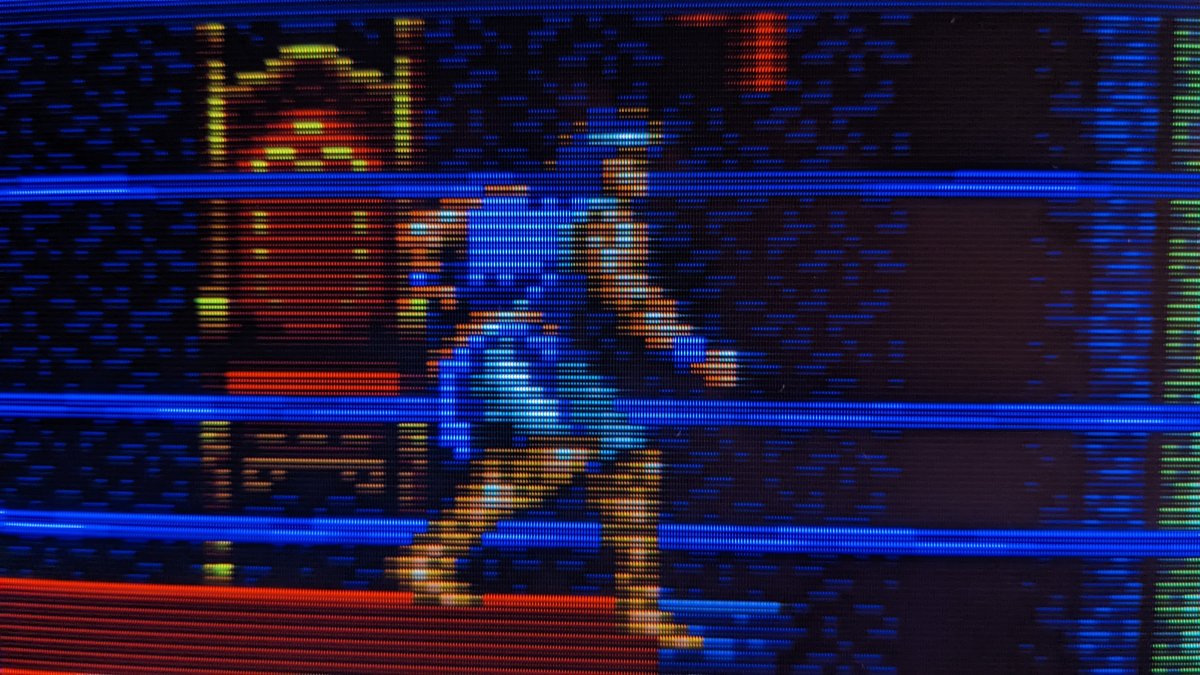

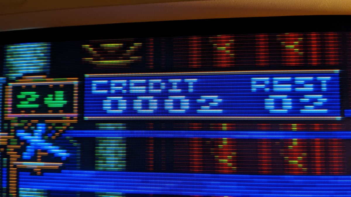

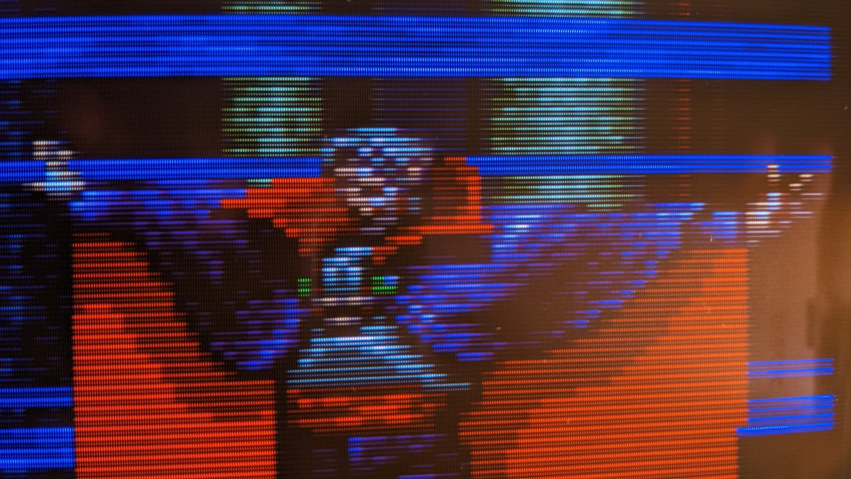

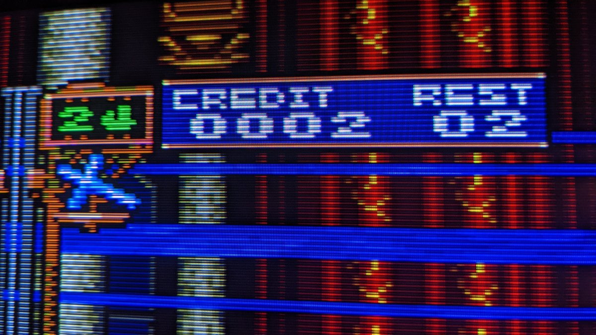

I thought it'd be interesting to share pics of my XRGB2+ vs Retro Scaler A1, now that this adapter came and it finally works!
Nice VGA monitor
A1 on top (1st scanline setting) , XRGB on bottom (calibrated long ago)
The A1 is weirdly dark/muted, and jacking up the monitor brightness doesn't really fix it.
It's a SLIGHTLY more clear & stable picture. But the color flickers now and then on certain screens.
The XRGB pixels are slightly more meshed together. But I can only tell a difference if I'm this close to the monitor and doing a side-by-side test like this.
Overall I'll probably keep the XRGB as my main because of the versatility of the image settings.

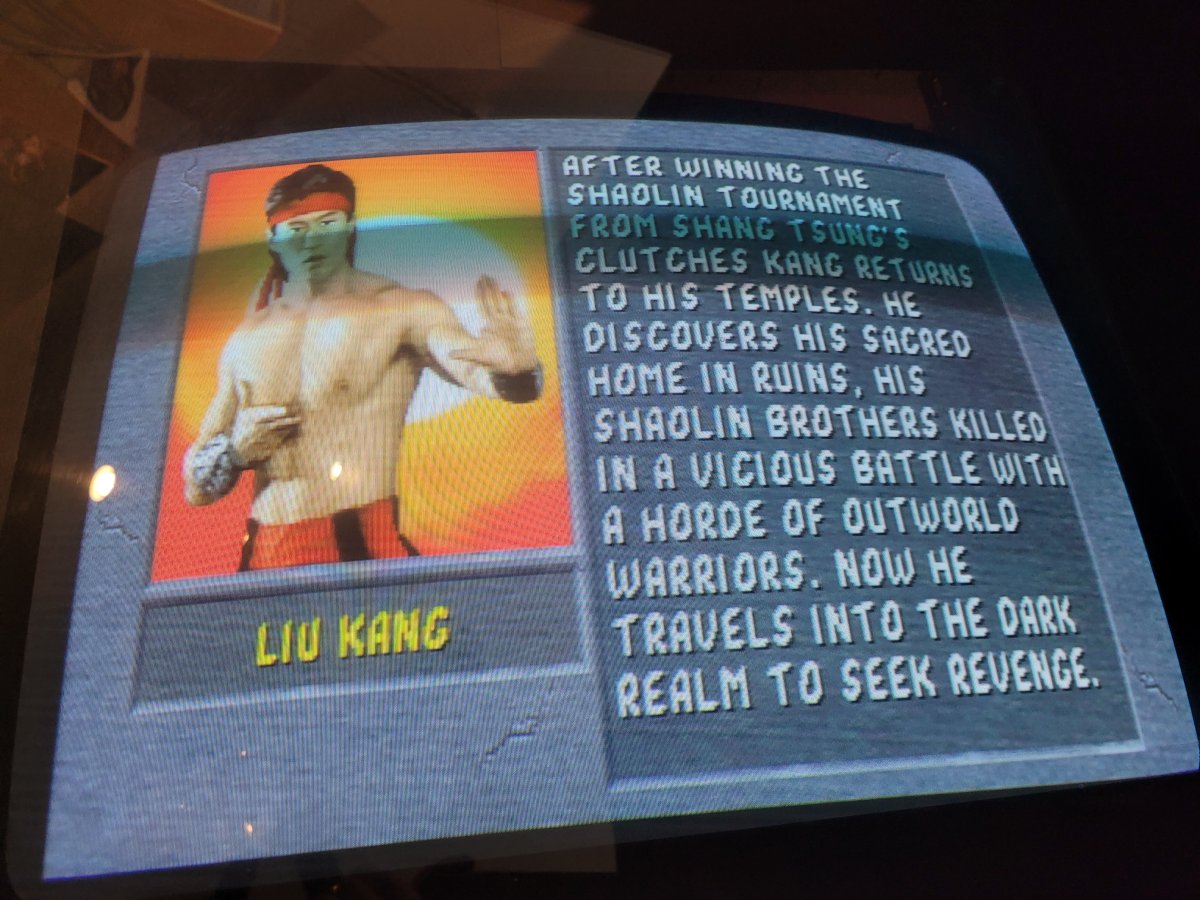

@GhaleonUnlimited finally had a little bandwidth to do some testing. Here is a Midway board (MK2 in this case) operating on 31Khz via Retro Scaler A1:
Did not think to tweak settings on the A1 and further, I didn't even have an SD card installed into the device as of yet. As you can tell, the image looks really dark and similar results with everything else I've done preliminary testing with on the same monitor up to this point.
I tossed in a spare SD card, restarted the A1 to create the .ini file and the image was much improved this time:

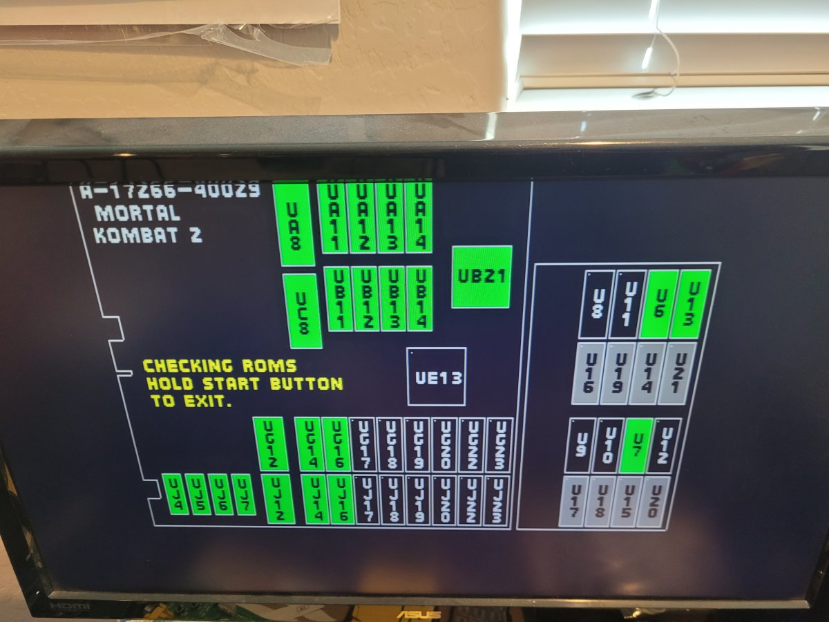

As a bonus, I'm running the video through a VGA distribution device, one output to this monitor and another to an LCD monitor. Picture looks good on the LCD also, aside from the v position a bit off initially:
Thankfully it's not the resolution being cut off as I would normally expect when capturing Midway arcade video. Shifting the picture down via monitor settings fixed it, so nothing is actually lost in this case - I'm curious if this is a viable streaming solution now because that was always an issue with Midway boards. I'll have to test that eventually as well.

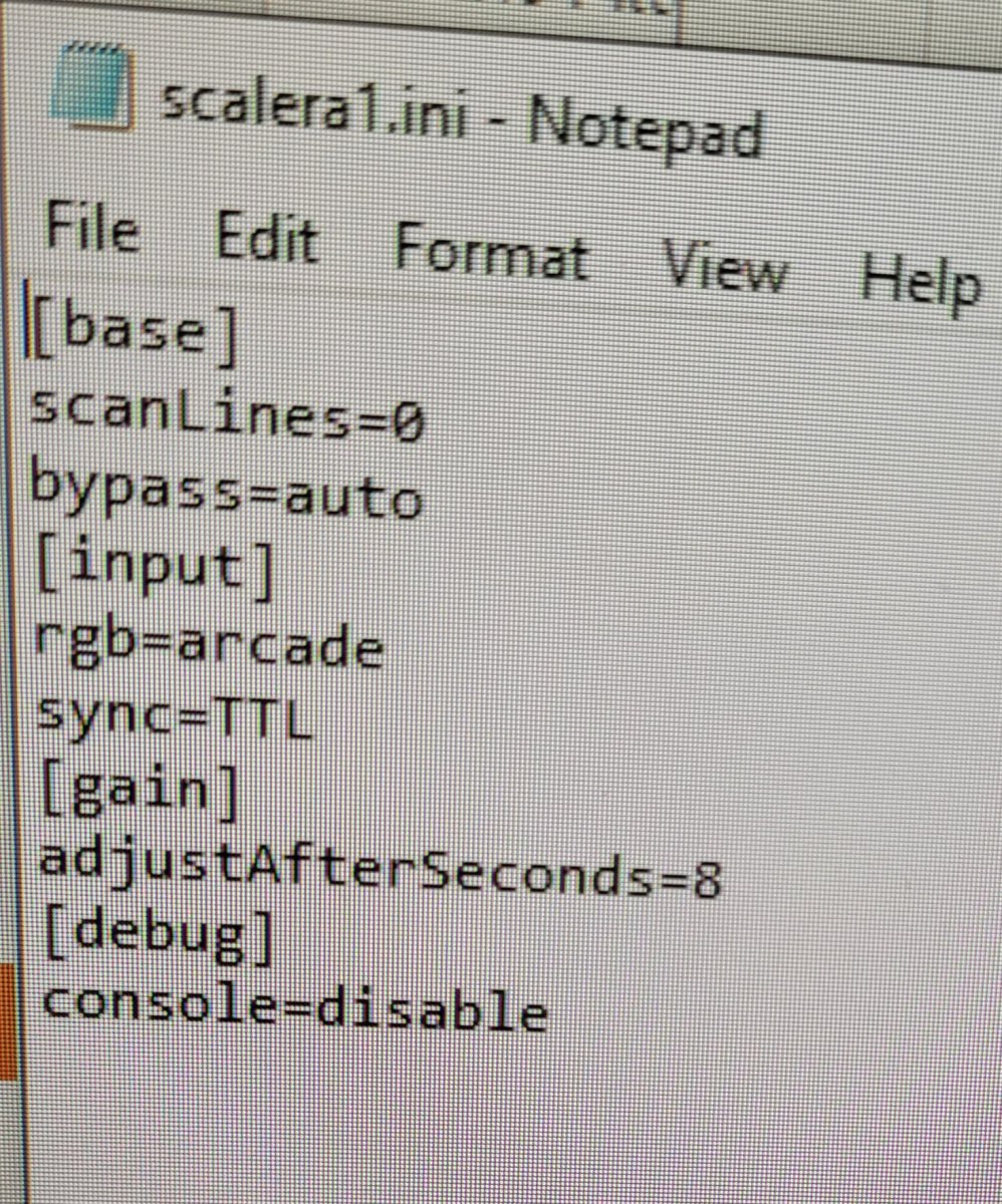

Here are the default settings in the .ini file - I did not tweak anything here yet:
Finally, the other bit of possibly useful info is that I get my arcade video in this chain through the HD15 output of a Splitfire passthrough board. I don't know if it there is any attenuation performed there for the video but I'm assuming there is. That's probably going affect how the A1 settings deal with my setup.
It's all anecdotal because everyone's configuration is likely unique but hopefully something in my testing above might help.

The A1 has an analog gain stage on R,G and B. It automatically adjusts this every time there is clipping, also after 8 seconds. If you want to manually trigger a re-adjust of analog gain, you can press the B button.
If the input is from a supergun, RGB should probably be set to 75-ohm in the .ini file, as the signal is likely already attenuated - leaving it on defaul arcade will result in double attenuation, and there is not enough head-room in the analog stage to make up for this.
EDIT: reading up on the splitfire, it seems this attenuates and re-amplifies the signal, so definitely 75-ohm for rgb in the .ini file when using this.
