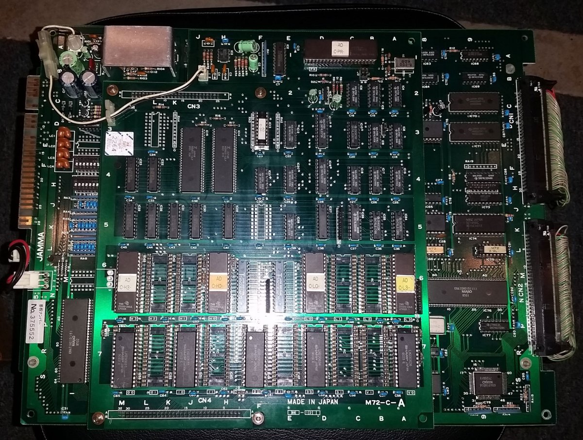

M72 = 3 PCB stack, JAMMA edge on center board, upper PCB is smaller and has a notch in the corner for the heat sync, also has 2 large ribon cables on one end and a 2 smaller harnesses on the other.
Original games on M72 hardware:
  • Air Duel (Also found on M82 hardware)
  • Battle Chopper/Mr HELI no Daibouken
  • Daiku no Gensan <Hammerin Harry> (Also found on M81, M82, and M84 hardware)
  • Dragon Breed (Also found on M81 hardware)
  • Gallop: Armed Police Unit <Cosmic Cop> (Also found on M84 hardware)
  • Image Fight
  • Legend of Hero Tonma
  • Ninja Spirit/Saigo no Nindou
  • R-Type [Not Viable for Conversion or Multi due to different ROM board]
  • X-Multiply (Also found on M81 hardware)

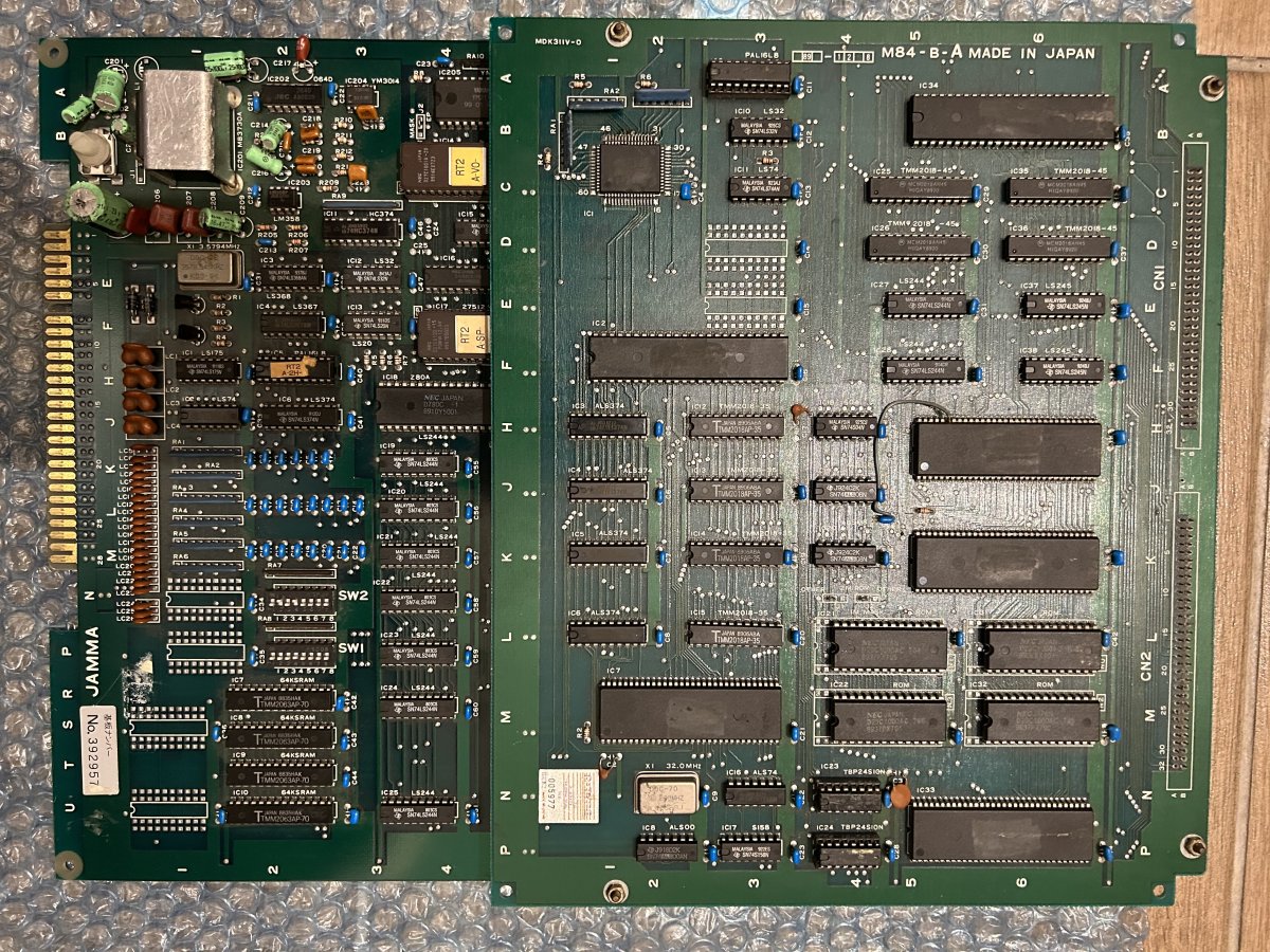

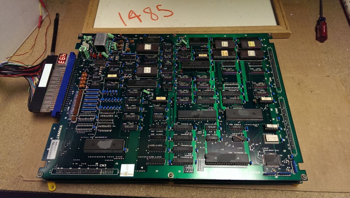

M81 = (looks nearly identical to M82) 2 board stack JAMMA edge is on the upper board and both boards are the same size, no cables between boards, note that there are 3 PCB connectors, 2 on the back edge, and unlike M82 there is one on the side near the front edge.
Original games on M81 hardware:
  • Dragon Breed (Also found on M72 hardware)
  • Hammerin Harry (Also found on M72, M82, and M84 hardware)
  • X-Multiply (Also found on M72 hardware)

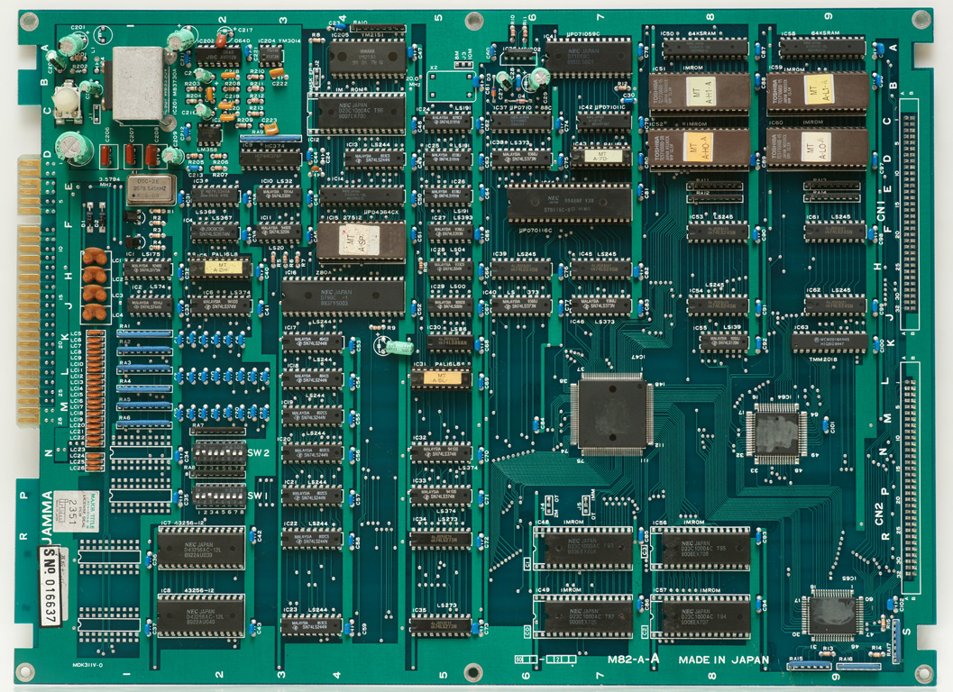

M82 = (looks nearly identical to M81) 2 board stack JAMMA edge is on the upper board and both boards are the same size, no cables between boards, note that there are 2 PCB connectors, 2 on the back edge, and unlike M81 there is none on the side near the front edge.
Original games on M82 hardware:
  • Air Duel (Also found on M72 hardware)
  • Daiku no Gensan <Hammerin Harry> (Also found on M72, M81, and M84 hardware)
  • Major Title
M84 = (looks nearly identical to M85) 2 board stack, JAMMA edge is on the lower board, upper board is half the size of the lower board, no cables between boards. note that there are 2 PCB connectors on the back edge, unlike M85 which are on either side
Original games on M84 hardware:
  • Cosmic Cop <Gallop: Armed Police Unit> [M84-D-B Bottom Board, M84-B-B Top Board] (Also found on M72 hardware)
  • Hammerin Harry/Daiku no Gensan [M84-A-A Bottom Board, M84-C-A Top Board] (Also found on M72, M81, and M82 hardware)
  • Lightning Swords/Ken-Go [M84-D-B Bottom Board, M84-B-B Top Board]
  • R-Type II [M84-A-A Bottom Board, M84-B-A Top Board]

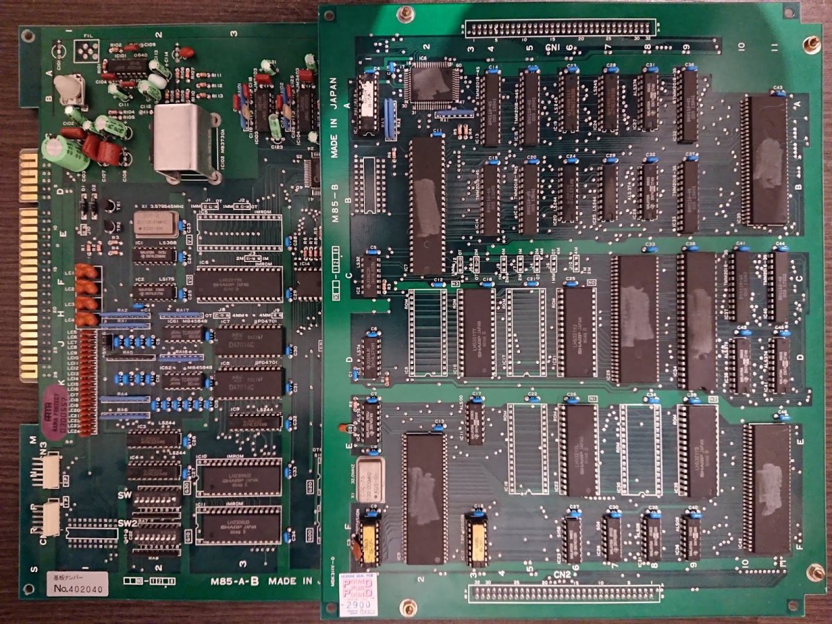

M85 = looks nearly identical to M84) 2 board stack, JAMMA edge is on the lower board, upper board is half the size of the lower board, no cables between boards. note that there are 2 PCB connectors on either side, unlike M84 which are both on the back edge
Original games on M85 hardware:
  • Pound for Pound

What about M85? There are at least 2 conversions available (R-Type and R-Type II) and more could be done. It's clearly the cheapest hardware amongst M72/M81/M82/M84/M85.

Following this topic I'm now wondering if the extra playfield supported by M82 wouldn't be supported by M84 or M85 too. I don't see Irem going backwards with the chips they used. Does anyone have hi-res pics of the bottom M82 board? Maybe M84/M85 (and even M81, who knows?) use the same chips but the additional ROM bank isn't wired.
The other possibility is Irem doubled the sprites circuitry on M82.
Here’s a nice photo of the bottom M82 board, kudos to StefanL

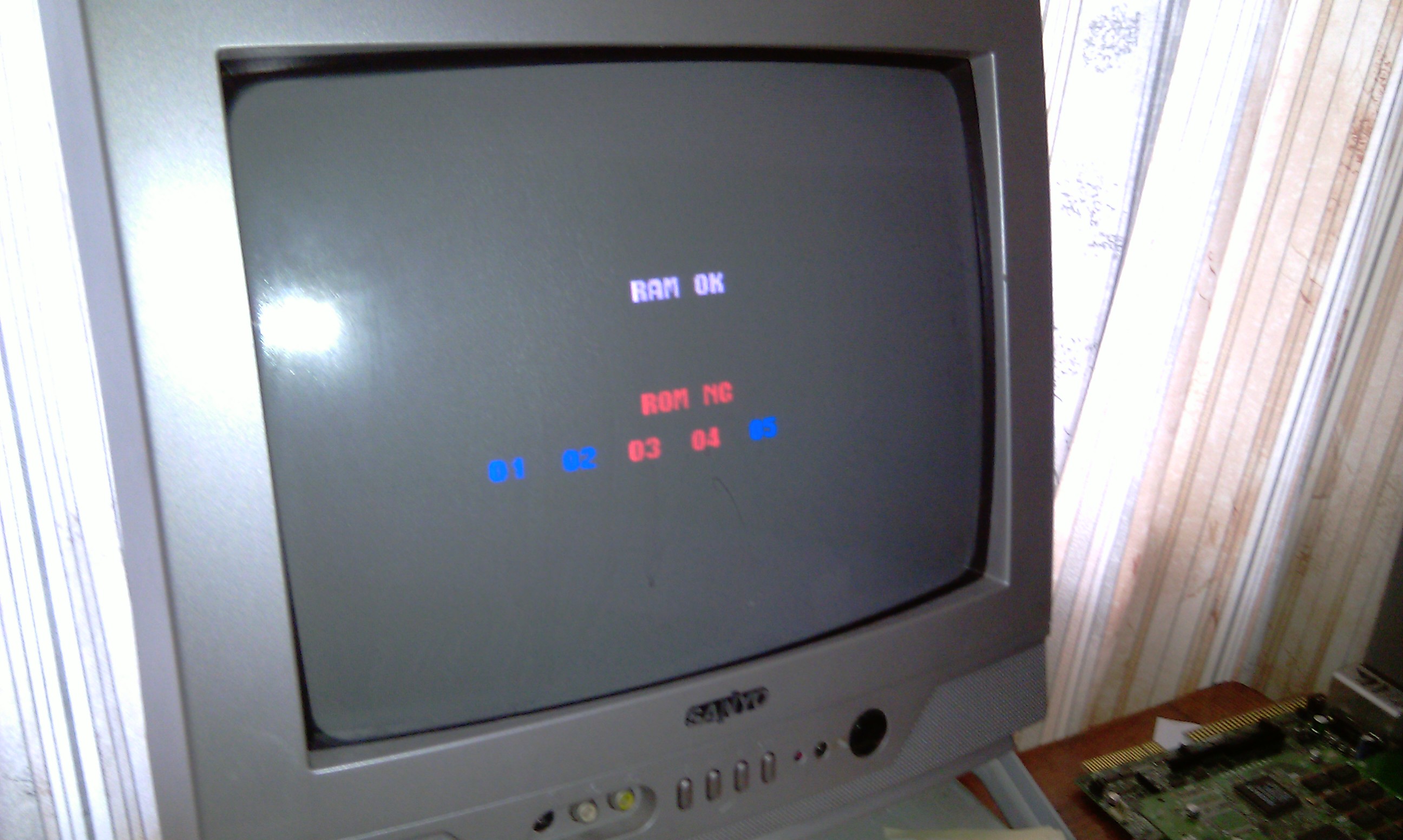

I tested cosmic on the kengo hardware.
Close, maybe a jumper problem, it's not line damage as kengo still runs.
EDIT : kengo factory pal cannot handle 2m program roms :/
EDIT 2 : tried splitting the rom and patched the rom test out of curiosity, game just hangs. so yeah pal issues.
