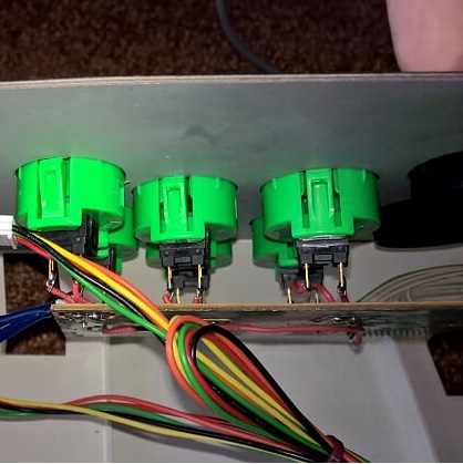

@mukurofish ... sir , i want just to replace my buttons on my HSS0130 , and i need an artwork moves like yours , but i don't know where to start. I intend to use my stick with Saturn HAS adapters. Maybe i didn't read and understand well , but i want to try to change the buttons because mine are in a poor shape :( . Thanks in advance. :whistling: (Anyway , after that maybe i'll try to do your mod on my stick too...)
To replace the buttons you will have to de-solder the old ones from the PCB, and then solder wires onto the PCB to connect to the new buttons. It’s a royal pain in the ass, but that was the first mod I did to the stick five years ago. New Sanwa buttons will also not fit into the panel perfectly; they wiggle ever so slightly (barely noticeable, but it’s there). If you reuse the old PCB though you’ll be able to connect to HAS using the adapters no problem.
If you decide to go with Brook boards you can always run wires out the terminal post to a DB15 breakout connector too seeing how 20 pin to DB15 PCBs are not available right now (this is what I’m doing on a second project I have yet to show).

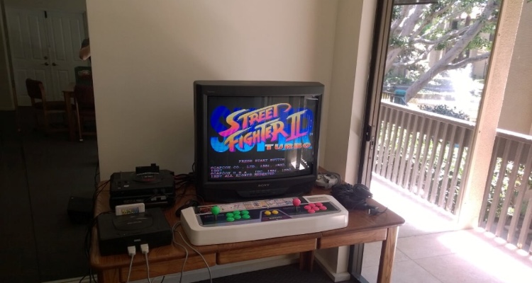

@AlxUnderBase This is what it looked like in early 2014. Was still using the factory panel. You can see the little wires going from the PCB to the buttons. I was such a newbie then I didn’t even know about quick connects, so I actually soldered the wires onto the buttons too haha.
