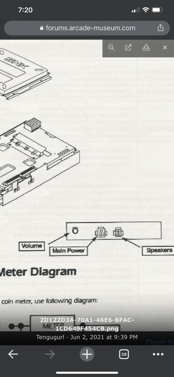

I recently purchased a revision 1 fighting pcb and I have the pot on the front of the IO Board and the jst connectors for sound and powering the amp.
I am trying to get sound out of the board but the pin outs cia the manual are kinda hard to see…

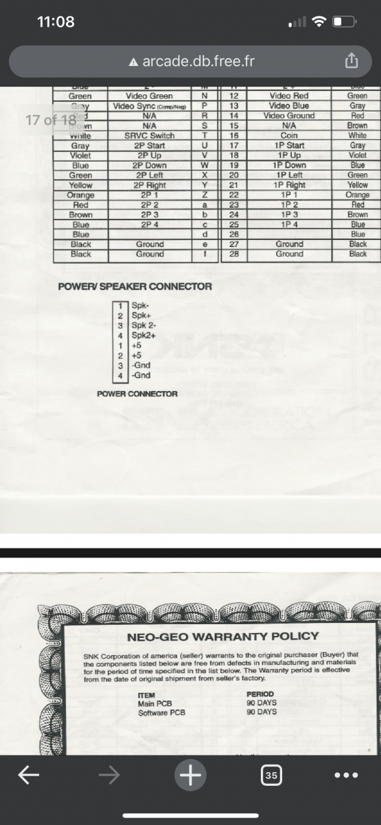

It's on the following page of that manual:
1 SPK-
2 SPK+
3 SPK2-
4 SPK2+
(haven't personally verified this)
You are so right! Thanks
I was being too literal and saw that in the manual and was like “well that jst connection doesn’t look like that so I better ask”
appreciate it

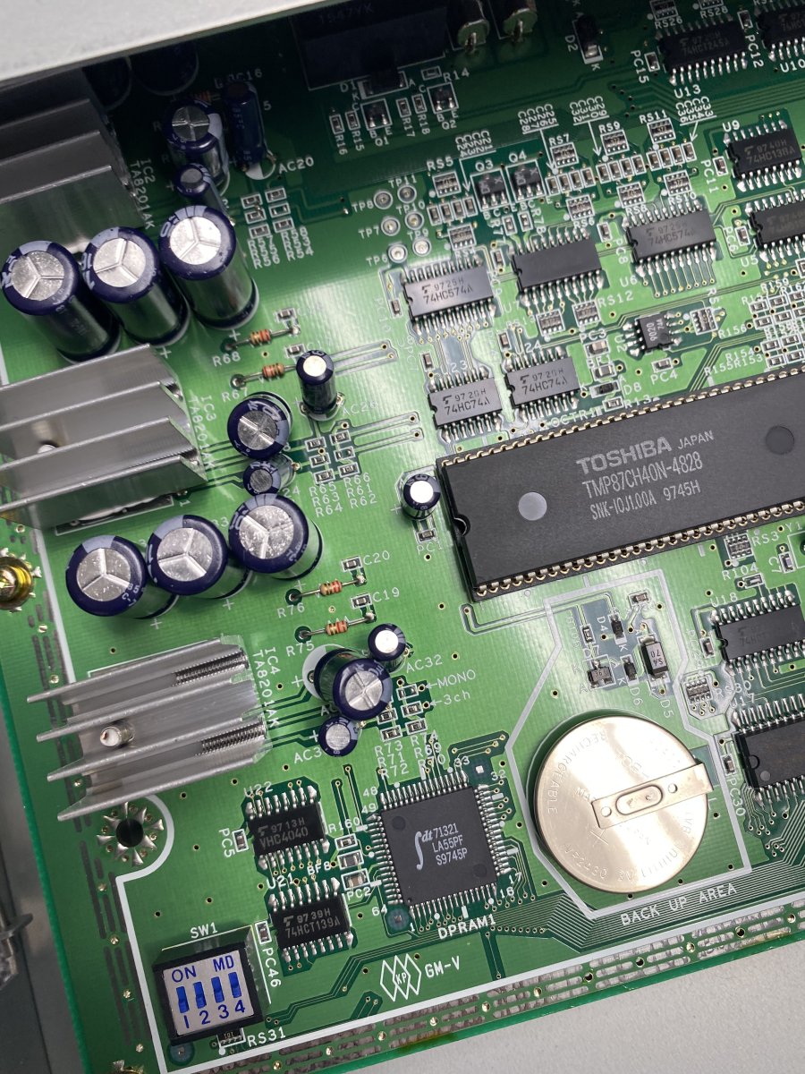

So this is interesting, I have a Rev1 fighting mobo - and the sound works via the JAMMA edge, and the pot controls volume. I just got a NIB unit, and am looking to do the same mod, but wanted to pass it by the smart folks here on AP. According to the jamma-nation post above, you just remove a resistor and jumper two points, but then you have a single volume level. Here is a picture of the Rev1 I got that was modded (seems like two cap's removed, and two wires removed from the pot to those spots (4670). For reference - here is my pristine new Rev1 board. (4671).

I can tell you that it works on the board I already have where this mod was done! I will try and look for some schematics later today and see what circuit those two capacitors are in.
So the wires aren't off the pot - they are just cut from the back of the speaker connector.
The pink wire (I assume that is pin 1, so SPKR -) is hooked up to negative pad of AC33 cap (normally a 1000uf cap)
the purple wire (I assume that is pin 4, so SPKR2 +) is hooked up to negative pad of AC35 cap (1000 uf cap)
With it hooked up this way, I get both left and right sounds (mixed) through the JAMMA edge in mono.
I wasn't able to find any sort of IO board circuit diagram to see what circuits these are for.
If this is a valid modification (and it does seem to work on my first board) - we should tell Jamma nation about it.

I just performed this easy mod on my NOS HyperNeoGeo64 (remove 2 capacitors, tap into the wires on the front and solder one each to the negative pad of AC35 and AC33). This does indeed give you POT controlled audio out the JAMMA edge. When I go and do a sound test, I get sound for right/left/center.

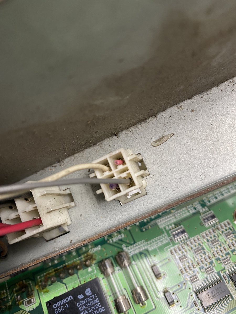

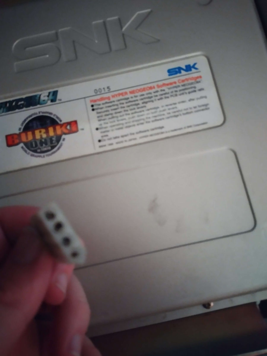

Sorry for the bump but I don't see a need to make another HNG64 Rev 1 Audio thread for this question.
I bought one last week and my board already has a speaker cable set wired in. What's the name of this connector a previous owner's installed and are there adaptors so I can just easily plug it into RCA or something?
