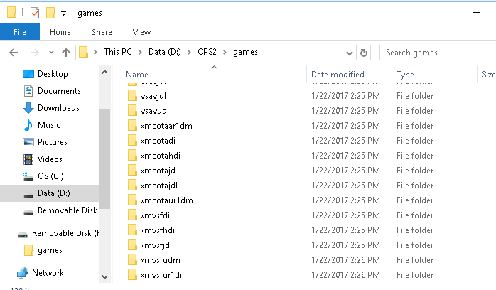

out of curiosity open a command prompt in the root folder for the rollup pack and do a "dir /x" command, see if there are duplicate folders for XvsSFU
I had this problem with my 8gb card the other week with the full pack. It wasn't just xvs though. It was every game after a certain point. I ended up using the US only pack and it worked fine. My other cards seemed to work fine.
yeah no dupes. I think I'll just delete the roms I'll never play. This too is an 8GB card.
