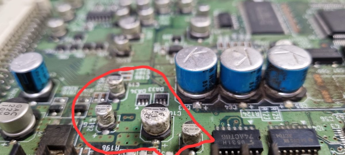

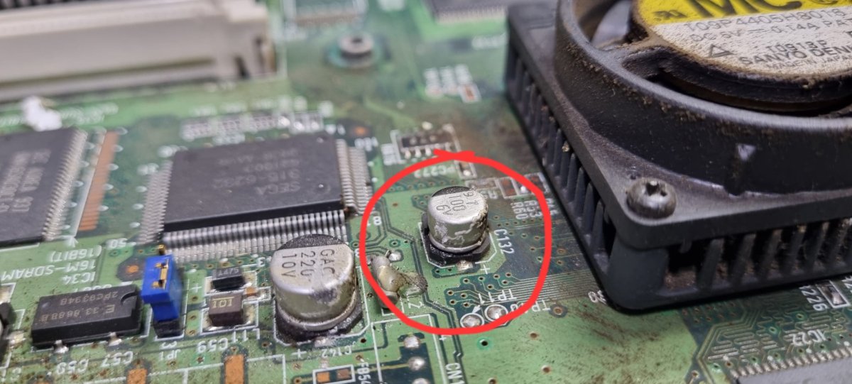

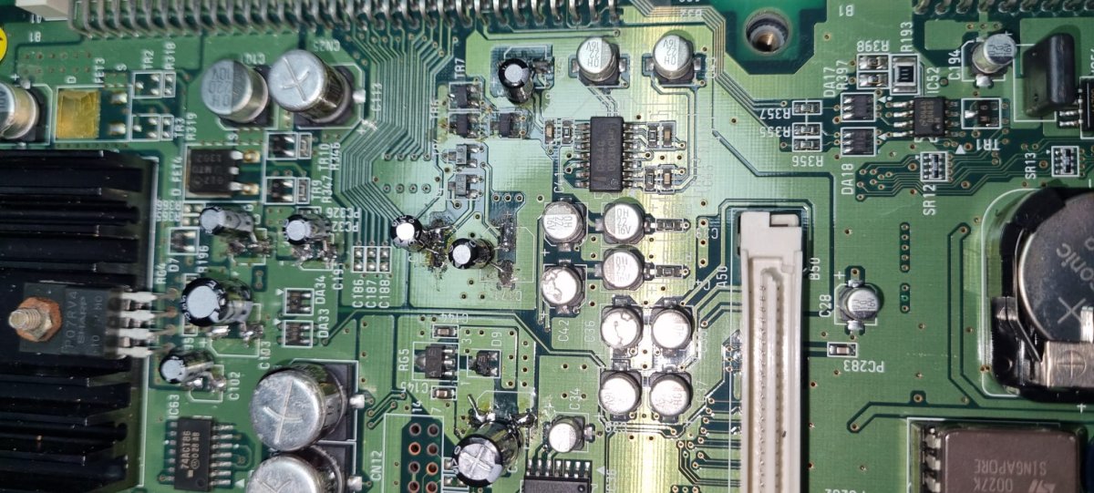

There are some caps with something white that I don't know what it is. These capacitors are not shorted, so I can consider them to be fine. What do you think?

Hay unas gorras con algo blanco que no sé qué es. Estos condensadores no están en cortocircuito, por lo que puedo considerar que están bien. ¿Qué opinas? Tengo que naomi 1 que no funciona con una gorra.
They don't look great, but also, it is more important to check and adjust the 5v and 3.3v from the supply than to change it for another supply.
i have 4.97v in 5v line, 12v in 12v line and 3.24 in 3.3v line.

That board looks like it got some rust, any water/moisture damage? You might need to raise your 5v & 3.3v lines a little. Also check if your bios is compatible/good.

This board arrived from a city with many humedity.

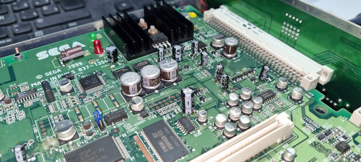

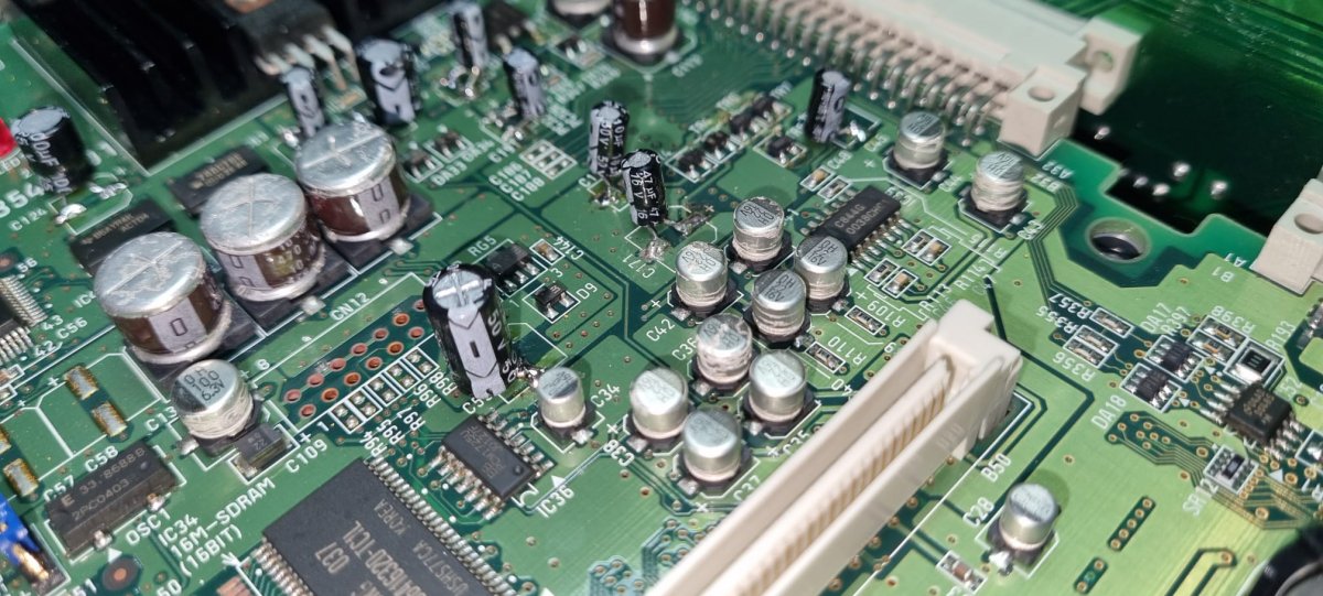

14 capacitors replaced and nothing changed.

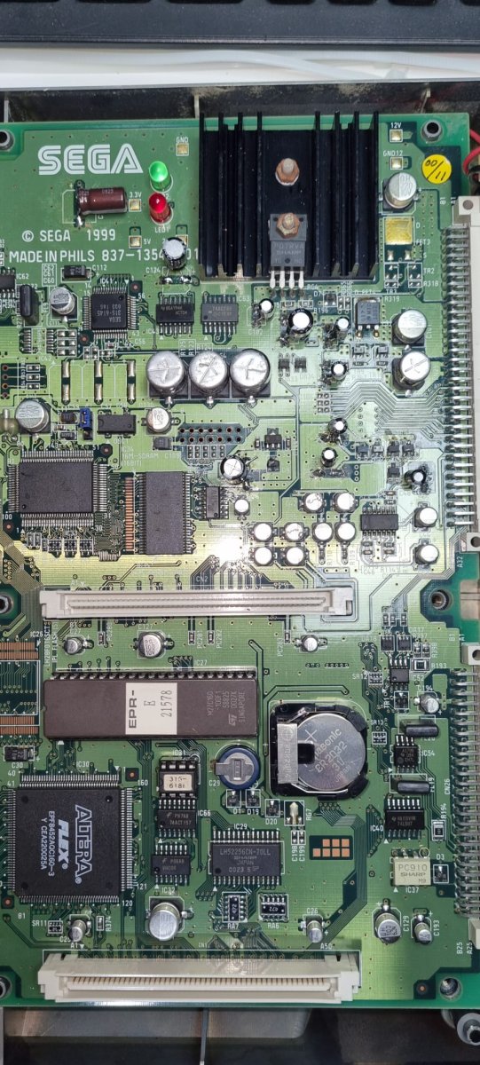

Only having those few pictures - there seems to be significant rust damage to the board - there could be continuity issues all over the place. Not sure how bad the damage is, but it could be very difficult to track down and resolve.

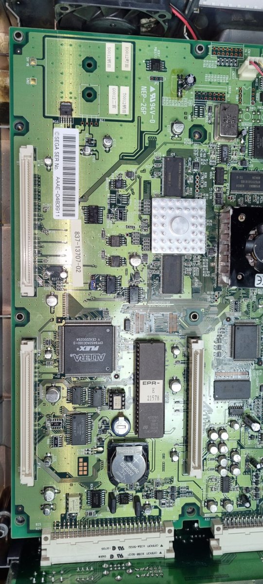

Chek now. But there isnt corrosion in the board, only flux i have used.
