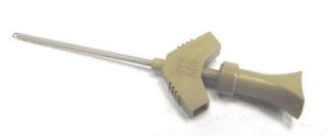

Yeah, I was really wanting to avoid people having to do any soldering on the original boards.
No solder solution, use a probe / grabber :P
Really too risky, it's easy to connect to the wrong spot and you have to now where to connect for every revision of every PCB supporting a multi.
