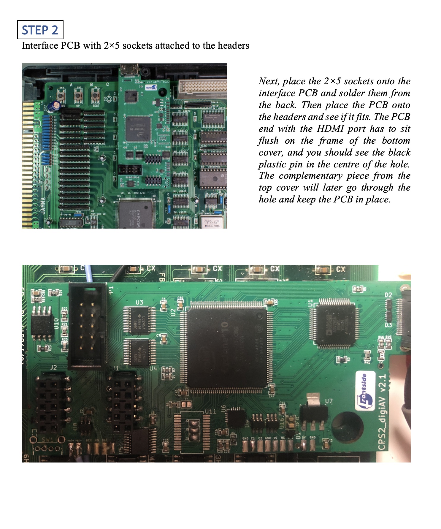

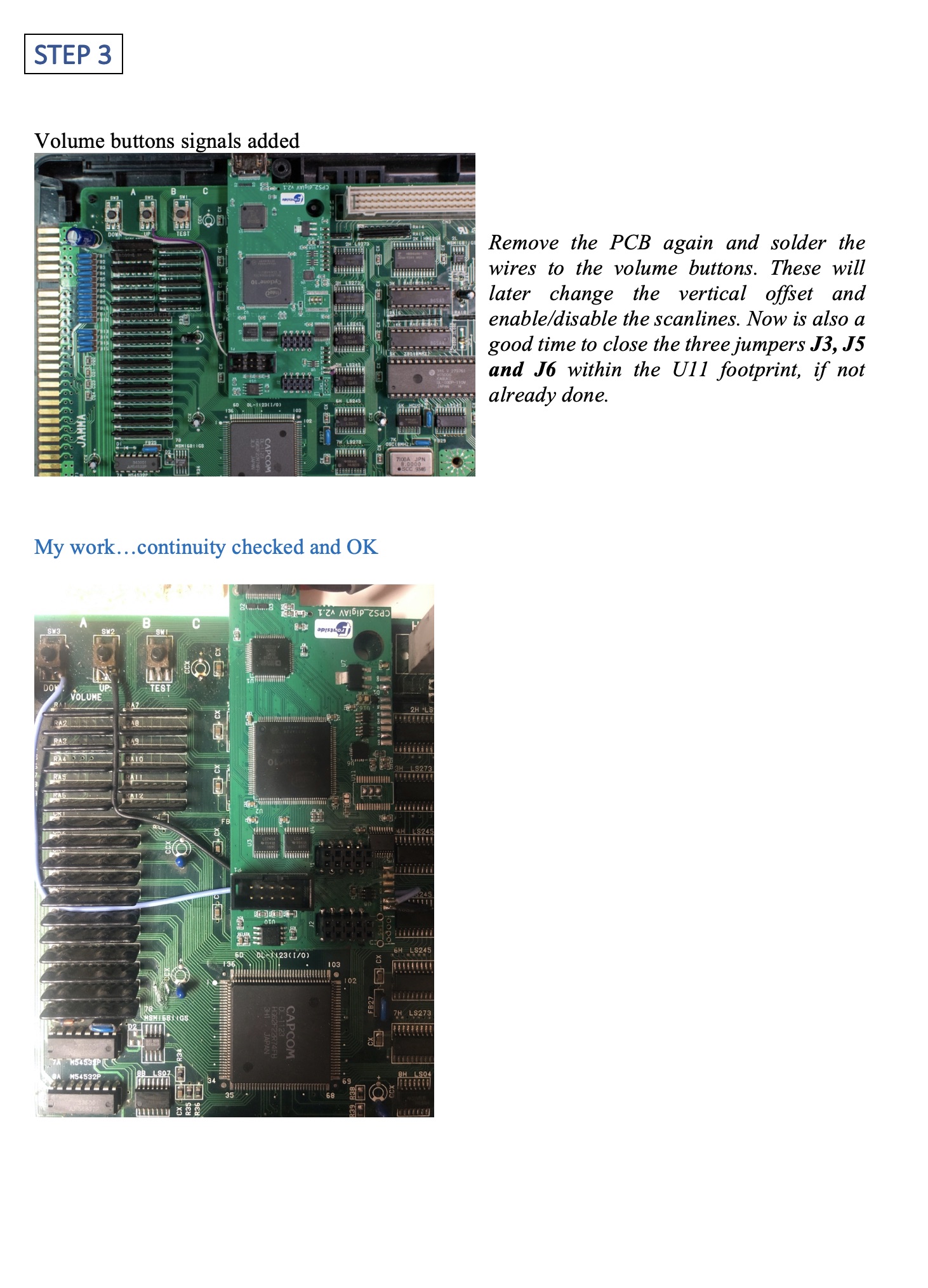

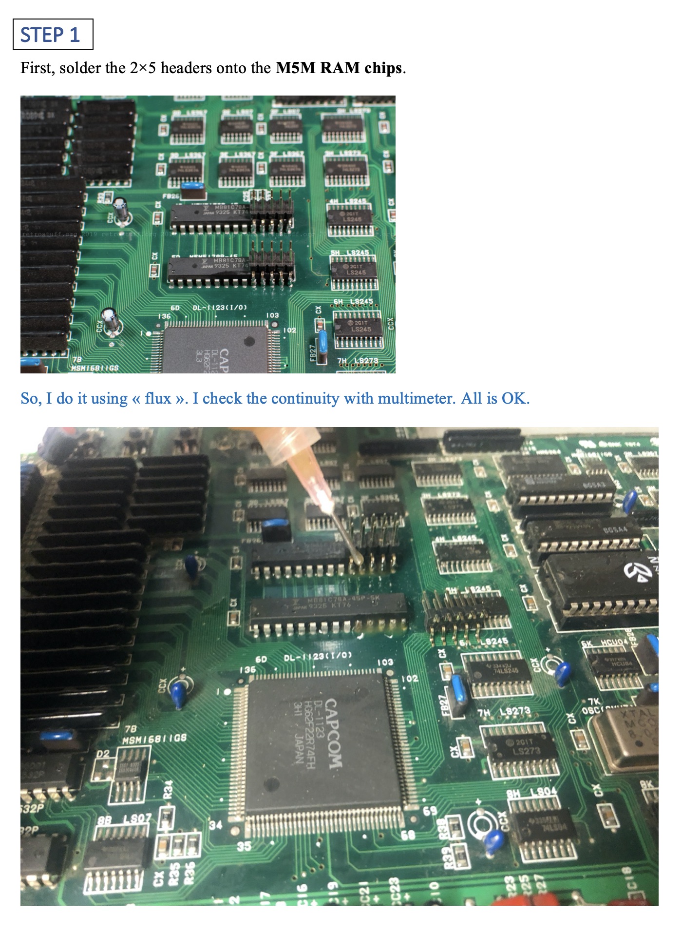

Hi,
I create this post because I try and try and try so many times that at the end I haven't no idea where I miss something ?( .
I wish you can help me :saint: .
Thanks to @Danexmurder who trys already.
Step by step I am going to post pictures of my "work".

Where are you putting the coax cable? I ended up using the clock signal from the IC just down from where you put the HDMI board because it's shorter than going all the way to the other side of the board.

If you are still having troubleshooting issues you can post pictures here. Be sure to check your solder joints with a continuity tester. It may look like a clean solder joint but only one way to tell for sure. And 9 times out of 10 the issue is folks not clamping the boards together securely. Reseat the boards a few times and check.
Hello kavas thanks for the suggestions I will recheck everything tomorrow and I will post pictures of the installation points I might it missed something then
