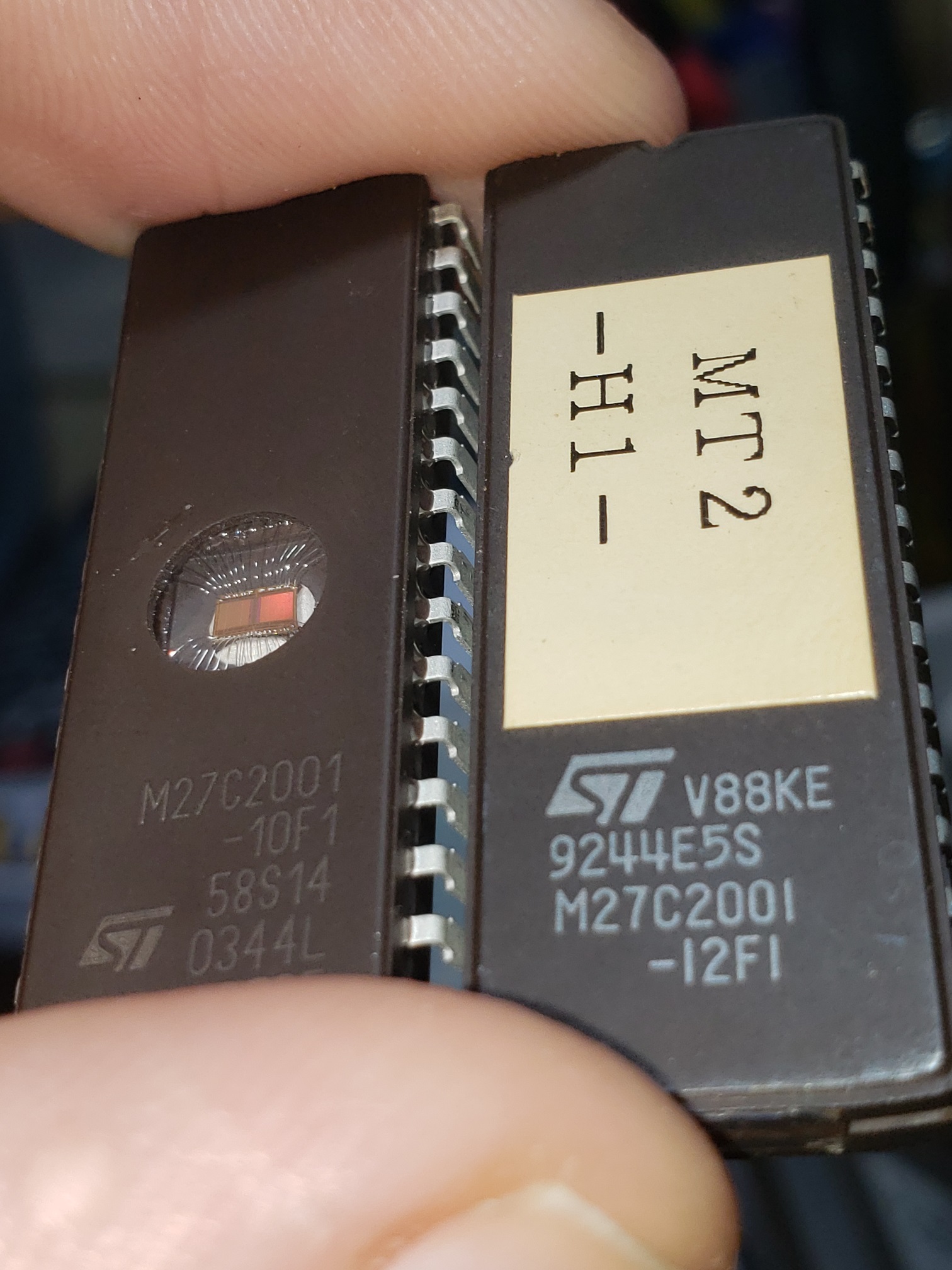

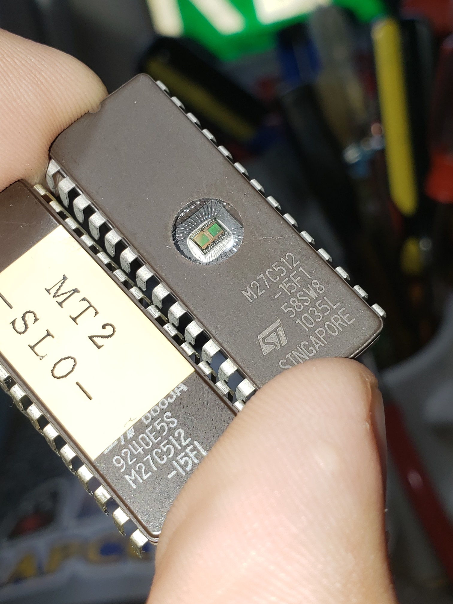

I assume all I need to do is burn the 2 sound chips and the 4 rom chips?
Or is there a complete replacement of other chips required as seen in this FANTASTIC write-up by @acblunden2
https://www.arcade-projects.com/for...conversion-log-major-title-2-r-type-leo.4680/
I matched the chips from the M92 to what I found online. Will these work?
Chip types are socketed in the following.
SL0 - M27C512
SH0 - M27C512
L1 - M27C2001
L0 - M27C2001
H0 - M27C2001
H1 - M27C2001

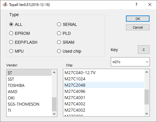

I can't seem to find M27C2001 on my TOP3000 programmer.
If there's an alternate chip type that supports the ITH roms, please let me know.
I've searched all variants and can't find any that support it.
I have version 6.30 of the Top3000 software.
Apparently there's an update option, but it fails to work.
God forbid it installed chinese malware on me by now.

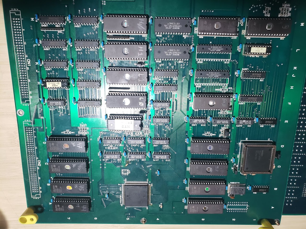

So In the Hunt has different IC numbers compared to the Major Title 2 PCB.
I've already burned and seated H0, L0, H1, L1, and SH0, and SL0 using a World rom set.
All the jumpers have been set.
So all I've got left is the below...

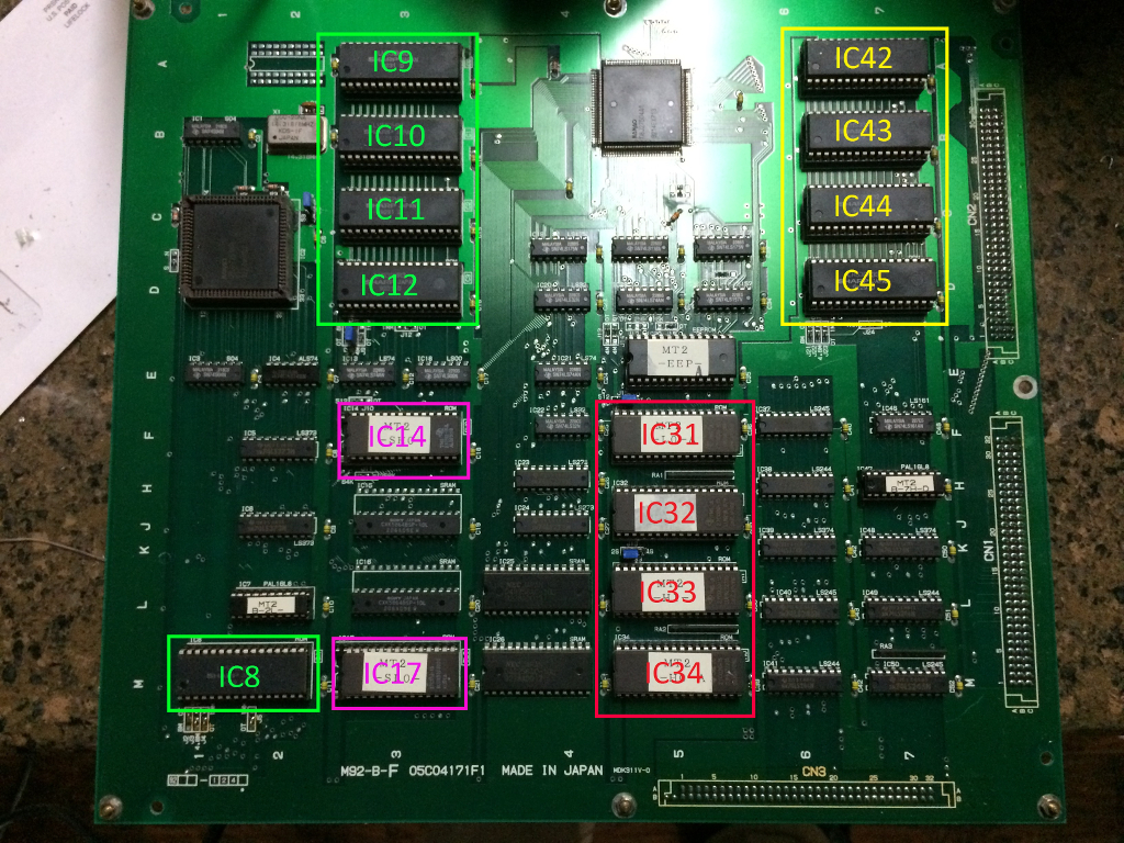

IC 8 - 12
IC 42 - 45
Where I run into issues is in the required roms need sockets for IC34-IC37, IC9, and IC23-IC26
Please check my work, is this correct???
My 27C040s should arrive any day now.
Thanks!
ITH World ROM ICsMT2 PCB IC SOCKETEprom Type
IC9IC827C040
IC34IC927C040
IC35
IC1027C040
IC36IC1127C040
IC37IC1227C040
IC23IC4227C080
IC24IC4327C080
IC25IC4427C080
IC26IC4527C080

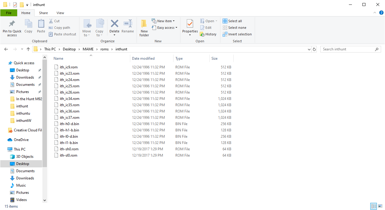

Looking at the known-good working romset I built this chart...

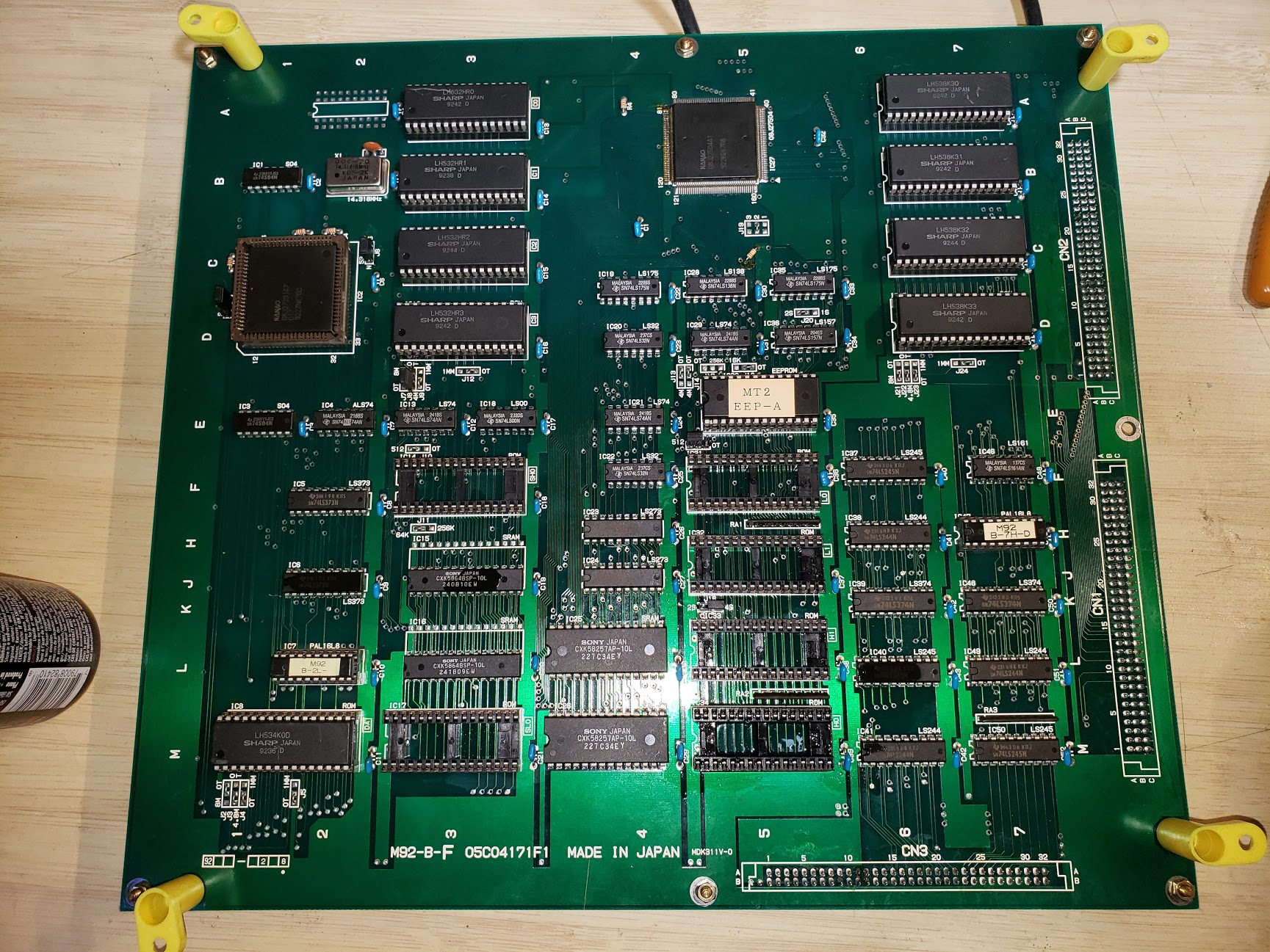

Jumpers are set to the following
J1 = N
J6 = N
J8 = 4M
J15 = 512
J16 = 4S

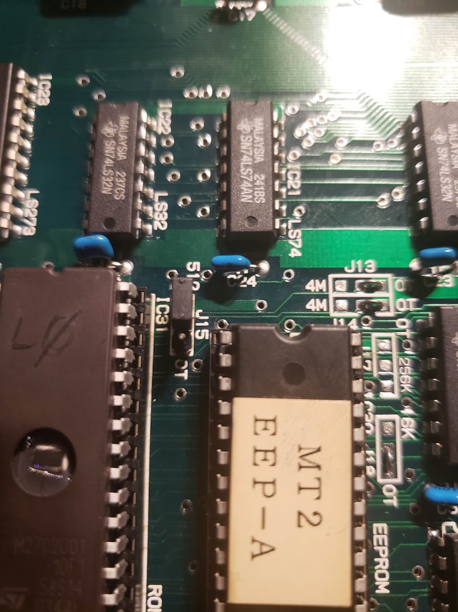

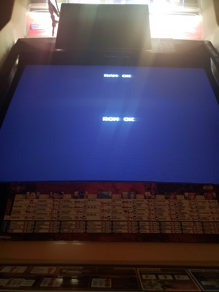

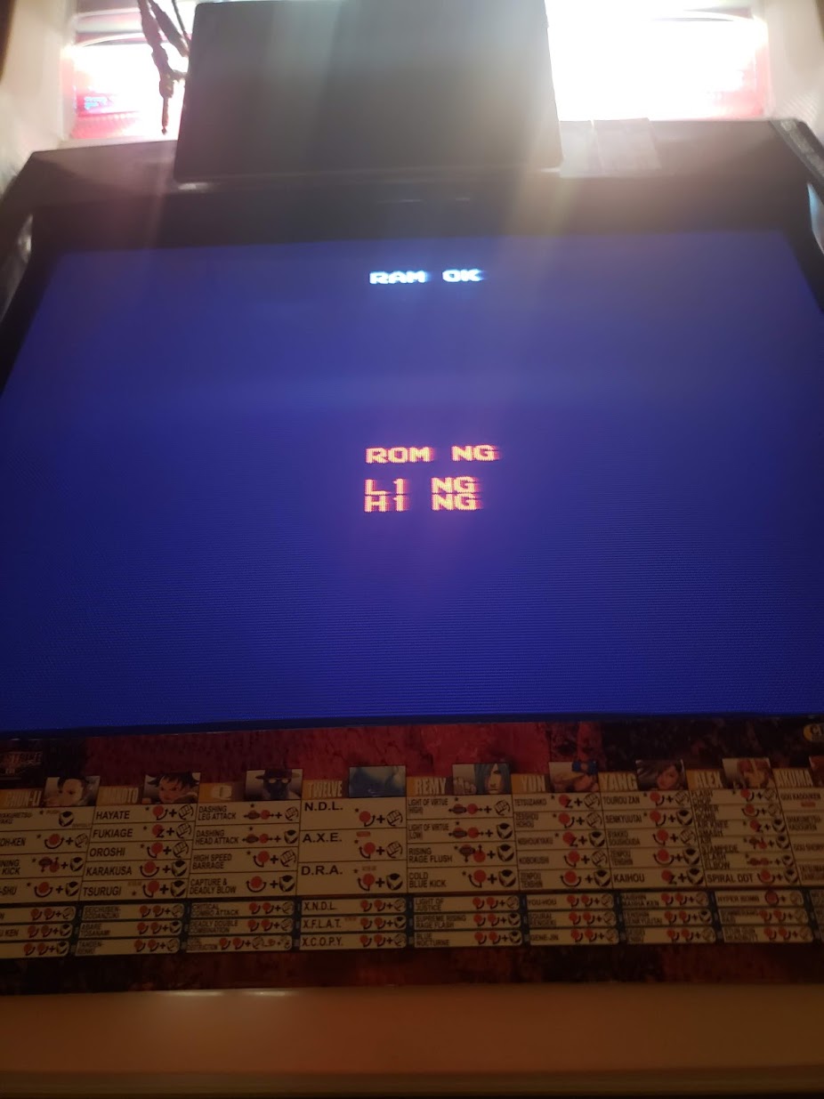

Following all the directions got me to this this error.
So I flipped one of the jumpers J15 from 512 to OT
I get now RAM OK and ROM OK
That worked... kinda...

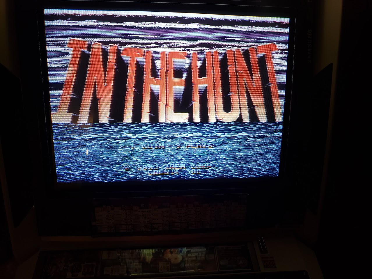

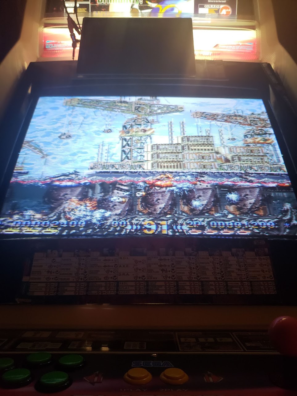

Currently I get the working game, and audio.
Something is off, like a color is wrong in the sky layers.
Also, the text for example is how strange it looks as the gradient is off.
The main sprites and animations are all there, but I've not played it past the first level.
There has to be something I'm overlooking.
I have poured nearly a day into wiping and re-writing different rom-sets to see if perhaps I was using the wrong one.
I've vetted the rom sets for functionality using Mame, and verified each and every write to make sure I was doing it correctly.

Putting the Major Title 2 roms back in, and resetting the jumpers to default, the board boots fine color/sound/all.
Any ideas?

The only thing I can surmise is that I’m using the wrong sized EPROMs for the main H0, H1, L0, L1 Roms.
