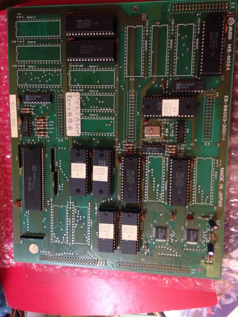

I recently picked up a P-47 board set for a reasonable price (great game too!) and would love to try out some conversions for some of the more difficult to find titles.
Some photos for reference:
P-47 Main board plus ROM board (system "A" no protection):
pro yakuu ROM board (system "A" encryption key "2"):
rod land ROM board (system "A" encryption key "2"):
plus alpha ROM board (system "A" encryption key "2"):
plus_alpha.jpg'
Has anyone attempted or seen a conversion on this system? I'm currently searching for a donor ROM board to experiment with but I'm curious if anyone else has tried this or if there are any gotchas?

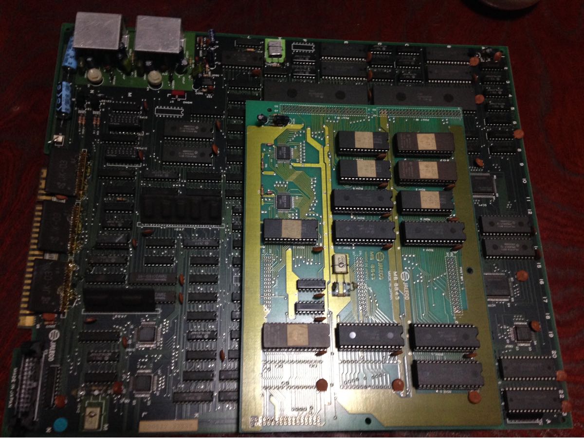

So I took a gamble and bought some ROM boards for Mega System 1 to try on my P-47 main board and they work... the connector spacing is identical.
In addition to P-47 I've got Rod Land, and Jitsuryoku Pro Yakyuu and both ROM boards fit and boot on the P-47 main board.
I also picked up a Kick-Off ROM board and while the PCB connector spacing is identical it looks like someone swapped the connectors on the rom board with some generic headers that don't mate with the connectors on the main board (main board connectors have a keyed shroud, this rom board's connectors are too bulky around the parameter to fit into the shroud.
So with that said P-47 seems to be a suitable donor for the main board (the ROM board likely can't be converted to anything else) And I've got a few ROM boards I could use to test conversions.

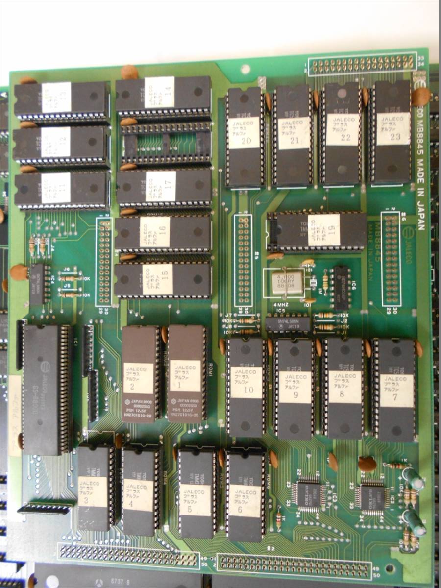

I started looking for ROM board photos of Plus Alpha to see if I could determine the Jumper configuration... this was the best photo I could find:plus_alpha.jpg
for reference this is the JPY ROM board:
aside from the obvious ROM differences I quickly noticed that the JPY ROM board has 2 PALs that are not present on the Plus Alpha ROM board... And not just unpopulated... the boards are different Plus Alpha is "MB8845" labeled PCB and JPY is "MB-M02A" labeled PCB.
Searching around for photos of other games I discovered pictures of Saint Dragon on both an "MB8845" and on an "MB-M02" ROM board (which looks indistinguishable from an MB-M02A) so I'm assuming these are all just revisions of the same board. Saint Dragon and Plus alpha have all 8 of the jumpers open on every PCB photo I've found.
I tried with the jumpers closed first and got some sprite issues. I then removed them all and the sprite issues remained. Audio and gameplay seem to work great though.
