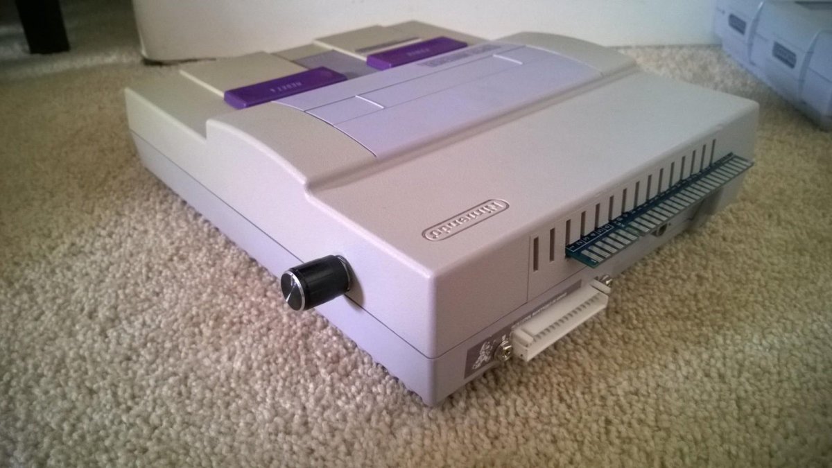

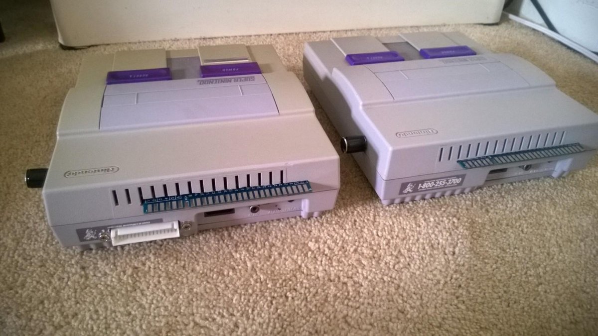

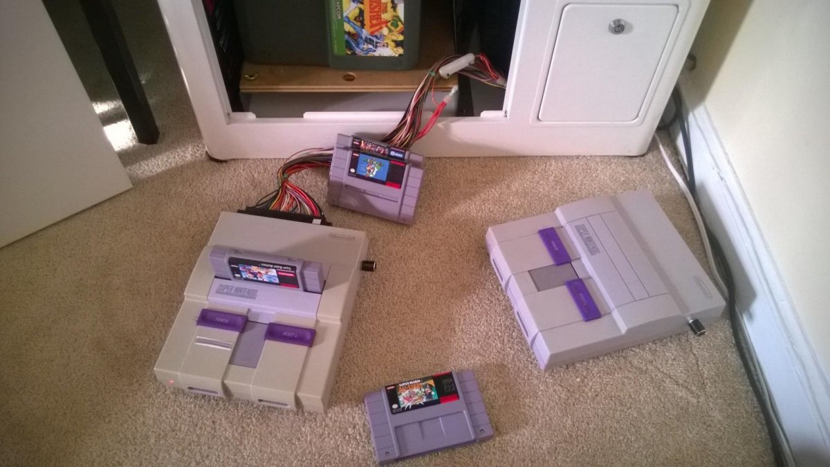

I did a couple of thems few years ago.. Sold them to some fine dudes on klov. Was thinking of maybe making a few more.. what do you guys think?

That is very cool!! Nice clean work. What is on the kick harness? Start/Select?
The Console Jammamizer exists, but this is a nice clean solution if you just want to drop a SNES in a JAMMA cabinet.

the kick harness is for cps setup .. The guy I made it for wanted it that way. The start and select are wired to the jamma and don't need a kick.
I prefer the solution where the console stays untouched and the adapter plugs into the power jack, AV port and controller ports.
Also if the console fails (which is frequent with Super Nintendos/SNESs) you don't need to redo all the mod again.

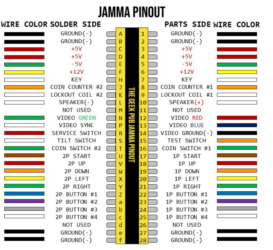

Start is ont the Jamma for player 1 and 2 but Select buttons never see that on my Candy cab.

how you do for second player Select ? Can tell us how to make same as you
On my blast city if add coin it will do the action same as pushing select but for player 1 only ,for player 2 i can't do the same action , i'm using a Jamma to Snes from Aliexpress .
