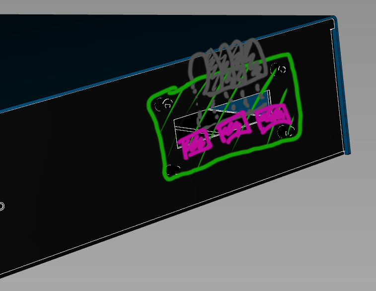

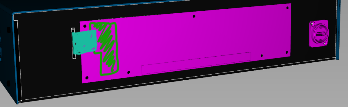

DIP SWITCH DEBATE: The cable that connects the remote pcb to the one on the actual cps board has an IDC cable that is surface mounted on the same side as the dipswitches. Because IDC cables are so tall, to make sure it clears, the pcb would have to be recessed back rather far. This would make access rather difficult without a tiny screw driver. My thoughts are to mount it to the front of the case externally so it's fully accessible but the cable would have to come out of the case (from behind the PCB) and loop up and over to the PCB. I'm leaning to the second option, having the pcb on the outside. It's a little less streamlined, but it is rather clean and mounted with screws to the case. The alternate option would be to use his other pcb that mounts to the filter board and having a notch or cable pass through cut next to the filter board so the thin ribbon can come out and over to it that way. The downside here is that the dipswitches will be on the back of the case with the HDMI/filter board instead of up front with the actual controls you would likely use all the time.

Option 1: Filter Board Mount with Cutout:
Option 2: Front Mount on Outside of Case
I don’t do the discord thing, but I’ll preorder if it supports option one for the dips as that’s what I got.
I opted for the filter board mounted dipswitch remote board, so as long as this case doesn't disrupt how that works I'm fine with it. Either way, looking forward to seeing the final design.
I'm confused by your references to the front and back of the case. Isn't the side with the JAMMA edge (ie. the filter board) the front?
I think it was a reference to option 2 outlined above "someplace other than the filter board", I can see either being considered the front I guess... frankly, if it were myself I would pick option 3 "all of the above". We're talking small cutouts to pass a flat cable through. Not like they'll look amiss in locations where they're not used and there's no reason to limit things to a single option.
Agreed. I think accommodating most if not all options should be possible without compromising the aesthetics too harshly.
I have the filter board mounted dips on the way. So if I had a gun to my head, that is how I'd vote.
There is a reason to pick only one, the front mount (IE opposite side of filter board) will require external hardware and a large hole for the idc cable to pass through. When not in use, I think it would look unsightly.
Given the filter mount option is the cleanest one and least obtrusive overall, I am going with that one.
