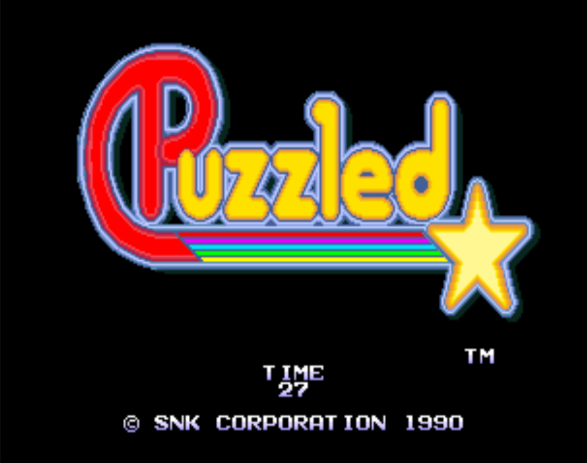

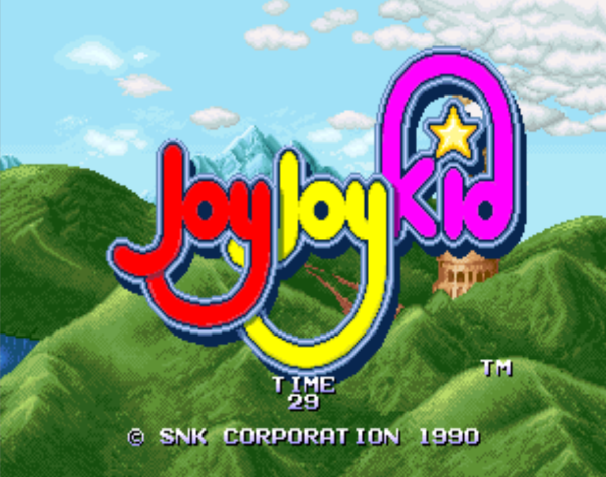

Have you ever noticed that the intro of the game changes drastically in the two versions?
Check here :
MVS
AES
On MVS we have this loop:
Logo -> Title -> Demo -> Score
but on AES we have:
Logo -> Story -> Title -> Score
Since I love seeing my mvs in a loop inside its cabinet with original bios, i was wondering, is it possible to reactivate the story scene inside the rom which is only present in AES? ?(
