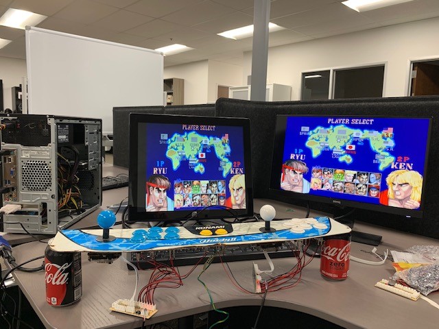

Get a load of this "ghetto" setup I am working on right right as of this moment:
This may seem really ghetto with a Windy II's CP being propped up by Coke cans. But this ghetto setup belies a truly functional application for this purpose. That CP is getting ready to be stripped of its CPO. The panel repaired as rust is eating away at it. But before it gets that TLC and since we are at my buddy's office, it makes for a good make shift rig to config MAME cotroller inputs as well as the front end's navigation inputs. All of this shall be thrown into a Sega Versus cab later. Once I have MAME and the the front end's inputs configured (in this case AttractMode), I can just copy the config files over and over. Those LCD's you see there are displaying a misaligned impage are displaying a 15khz signal from a single Dell Radeon 5450 card ($5 bucks shipped!) running CRT Emu. Such LCD's are a god send if you ever setting up MAME. I wouldn't even dare setup MAME without such an LCD. Too troublesome. It is worth your time to find an LCD that can display a CRT Emu hacked 15khz signal through VGA. With it, you can set everything up from the comforts of your desk. Then once done, shut it down and all you need to do is wire in your PC to your cab and you are good to go.
