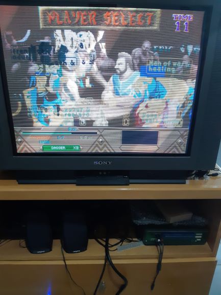

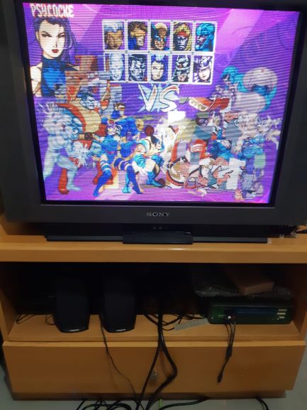

i have xman and dad ive been trying to de suicide using ud infinikey
1.dad is dead
2.xman shows messy scrambled pic and i can see ram error and then the screen changes colors few times and days
*i took all chips from DAD and installed them on xman board-gets audio and video but with wrong sprites /corrupted images
*took all chips from xman and installed then on 1955 board-same shit
any ideas on why xman roms and board combined gives dead screan but when tried them seperated they work (ish)
any ideas on why the corrupted images?
assume all jumpers were set correctly

Hmmm...
You seem to have bad MaskROMs on X-Men and bad object RAM on its original B board (or maybe a bad trace/via/custom).
Can we get a picture of the RAM error?
The A board is fine, right?

in order to get something alive i:
1.installed dad roms are on xman board
2.insralled xman roms are on 1944 board
*the xman roms on xman board starts with scrambled pic and ram error message. then the video goes crazy and flashes...
**I tried 3 good working a boards -same results
