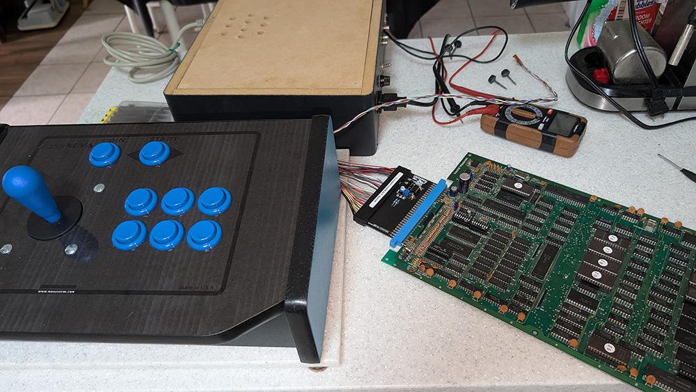

I plugged in the supergun today. I tested voltage at the jamma connector and adjusted it.. I'm at +5.05, but the other is like -4.06 and +11.59 or something.. are those fine to leave or should I get a new power supply?
I plugged in The Main Event PCB and got sound.

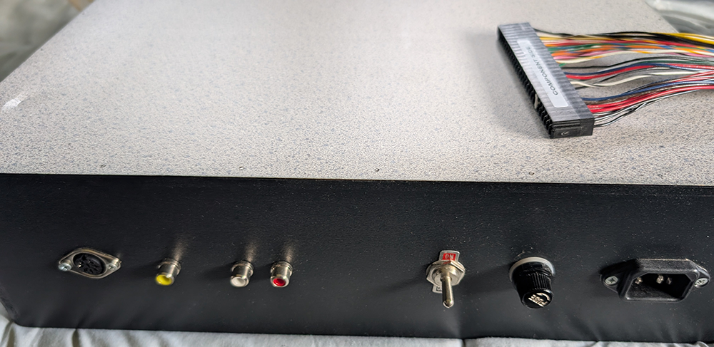

Attaching some pictures.. I tested video on my HDTV and it works! Obviously looks like crap. My TV stand doesn't allow me to rotate, so I can only see it horizontally.. so inserting a vertical game is sideways.
Attached are an image of the back of the unit, the unit on my counter (upside down) as I was testing for sound and voltage at the time, and then a picture of the inside.

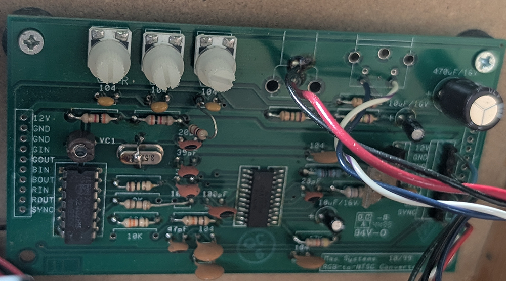

I took a close up image of the little board because I wanted to read what the chips were. One of them I cannot make out, only that I know it says Sony.

The photos aren't very clear so I can't see much, and I'm sure others who are better informed that I am can correct me.
Your voltages for 5V -5V and 12V are probably fine. -5V is rarely used and typically for sound (Rastan, and Midway boards). 12V is usually for coin counter and also for sound. It's usually less critical to get right compared to 5V and a bit low is probably fine.
With so many wires going into that round video port (again, the pic is blurry so I'm not 100% sure), my guess is that the port is for RGB. If it is and you intend to make/buy a cable for it, you would probably want to make sure the RGB signal is consumer level (75ohm .7v), or you may cause damage to your video equipment (TVs, scalers, video capture cards, etc). You can usually tell the RGB signal is not consumer level when the image is super bright and the colors are a bit washed out.
The Sony chip that you saw on the PCB is likely the video encoder.

Every photo looks clear to me. I did not post the close up of the board I talked about if that's what you were referring to. Someone asked what mine looked like so I posted picture. One of the chips is a hex inverter 74HC04N.. The Sony one is super faded and hard to get a clear picture of.

Forgot to comment prior re: round connector next to the yellow composite video plug. This is indeed for RGB. However as suggested earlier you will want to be careful what you plug this connector into as-is, at least until you get a reading for voltage with live video signal coming out of this output. What I used to do years ago was take a SCART cable connected to this port, run it through an RGB to YUV converter and connect to a component input on a consumer grade CRT. Pretty decent results from memory but it's 480i in the end and that may or may not be a desired result in your case. Thankfully there are many easy ways to pull video from JAMMA these days (plus attenuated audio for that matter) and we don't necessarily need to go the same route as OEM design for this device. As long as it powers on and provides safe voltage to your board(s), you should have the hard parts of this process handled well. Thankfully it comes equipped with a switching power supply, so we're good on that end.

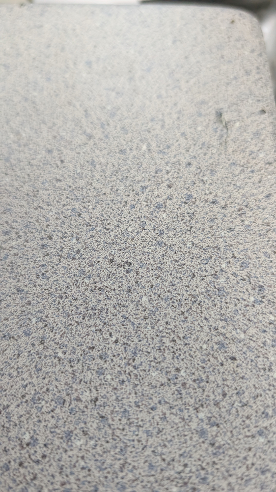

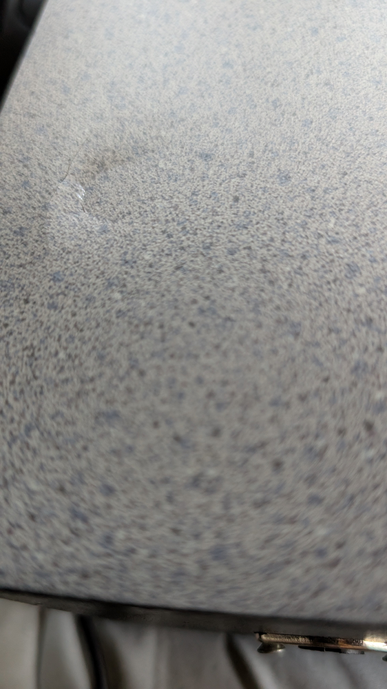

The whole unit is indeed in excellent condition, however during shipping there's slight damage to the top. A screw or something poking through.
Here's a slightly blurry picture of the board inside and two pictures of the damage. There's actually 3 places it got damaged that didn't seem to be there in the original picture.

Through the big DIN on the back you can get Svideo or RGB. You can get a Neo Geo AES RGB cable and that should be the same pin size/arrangement.
