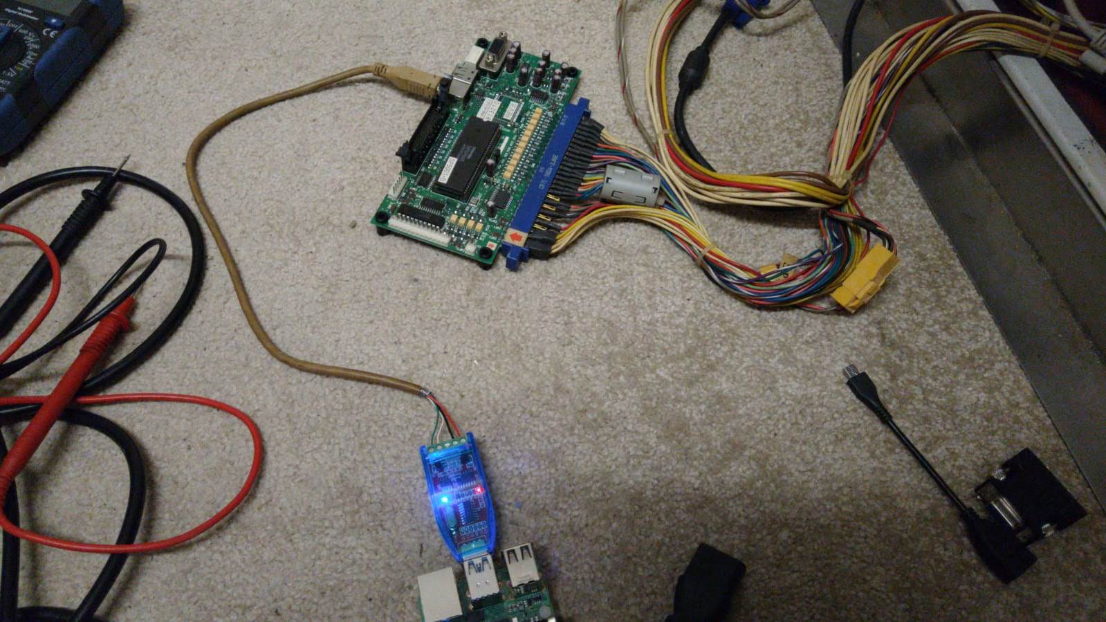

I've been testing today on Raspbian Buster Lite on a Pi 4 and have run into an issue, not sure if it's the code or my cheap and cheerful Chinese RS-485 adaptor! I can get the code compiled and installed no problem and it runs just fine, however, it only seems to pick up the analog inputs. If I run evtest I can see I only have one device event number available which is zero, it constantly reports back analog input due to the zero settings for fuzz and deadzone so it shows that the Pi and IO are communicating OK. My IO board reports back with the capabilities and says it can support 2 players with digital buttons but it reports either a timeout, a checksum error or Error getting switches. Could it be a timing issue maybe? I'll grab a different type of adaptor, the same as you use in your video, see if that makes a difference.

Hey there!
You're probably right and I suspect it is something to do with the timing, I get some checksum errors sometimes on mine which i'm not sure how to fix. I think your adapter should be fine though!
You say you only see one device event number which is zero. This is correct, and that corresponds to that I/O you've got plugged in. You said you get lots of analogue reads reported back, I didn't realise that's what fuzz+deadzone where for, so i'll get that into the next version so hopefully it doesn't display millions of analogue reads all the time. Thanks for the heads up!
Things to try:
If you run evdev again, select event zero and then quickly press Ctrl + C it should display what capabilities have been reported to linux, such as switches etc. If you could take a picture of that, I can see how its managing the switches.
I can see you've manually run `sudo /usr/bin/jvscore`, when you do that, does it remain open forever, or does it error out and close? (btw, when you do run this command make sure you've stopped the service running in the background with `sudo systemctl stop jvscore`, or it'll take over the serial connection)
From the debugging info it looks like it should be reading the switches fine. For me, because the switches get mapped to the keyboard keys when I press certain switches on my cabinet it will type things into the terminal. Have you tried pressing all the switches on your cabinet, to see if any of them type anything? It's unlikely you'll see the switch reads while theres so much analogue traffic going on, if you type the following command it'll filter out just the switch reads:
`sudo evtest --grab /dev/input/event0 | grep EV_KEY`
Hopefully some of these might get us closer to the answer. Thanks so much for testing it out, and any other comments/feedback would be very much welcomed. I'll credit you on the github page for the fuzz+deadzone suggestion.
Thanks very much for the speedy response, I managed to test this morning and your filter suggestion worked :) I can see digital inputs appearing when I move the stick and press buttons which is great! I do get double inputs on the stick so I think the debounce setting might need increasing and also I think I only get keypresses for Start and Coin but not the player buttons. I'll double check my cab wiring later just to make sure it's not a physical issue but this is just amazing! Would you mind if I fork your code and have a play around? I've written python based uinput controllers so I can see how the code is working, I'd like to change the inputs to mame defaults too. Also is it possible to add the debounce, fuzz and deadzone settings to the config file?
Edit: just noticed I'm being an idiot, the evtest shows input pressed, input released, not a double press!
You can see I tried jstest in the photo attached, I just get a single analog controller with no digital inputs, is that expected? Also, am I right in thinking this section of code is where the button inputs are being defined, using consecutive numbers from input-event-codes.h?

I have a suspicion I know what is going on, I've tested all player 1 and 2 inputs plus the service and test buttons, here is the only EV_KEY output:

Hey again!
Thanks for all the debugging work - you're probably right, that code probably only uses the first byte. I've only got a Let's Go Jungle setup to run it on which doesn't include many buttons.
I suspect `jstest` only looks for buttons from a joystick. I've mapped all the switches to keyboard keys, and jstest probably doesn't test for those. I'd be more than happy to switch them up to some proper joystick buttons in the code, and you mention that you know what the defaults for mame are which would help.
It should be easy enough to create an array of which keys are defined in which order, and then still use a loop to reference them.
