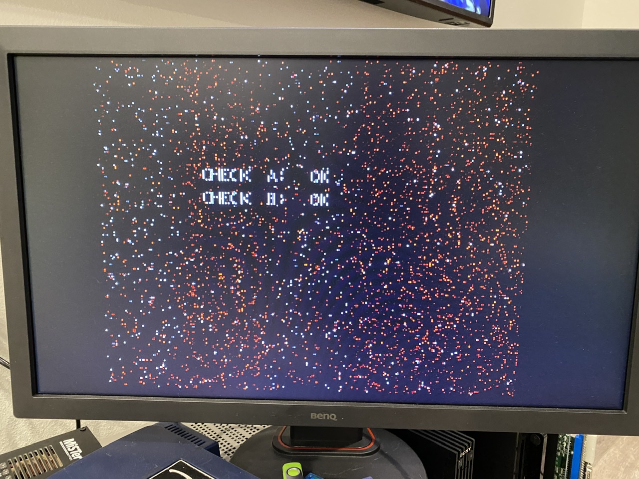

I bought some Gals Panic S boards from @ArcSys101. One board in particular is having some graphical issues. Unfortunately, it wont go past this screen.
Anyone know how to fix this?

Do other carts work fine on the motherboard?
If they do, I suggest a really good scrub on the cart contacts (and motherboard while you're at it) with Isopropyl and if you can an eraser.
Given how dirty looking the shell of the cart is, I'd say this might fix things?
I tried other carts on this board with similar results. I ended up pressing what I thought was the on board reset button, below the bios chip, a few times and that resolved the issue for some reason. I did however clean the jamma and cart contacts with no results.
Not sure why pressing the reset button multiple times did tho.
