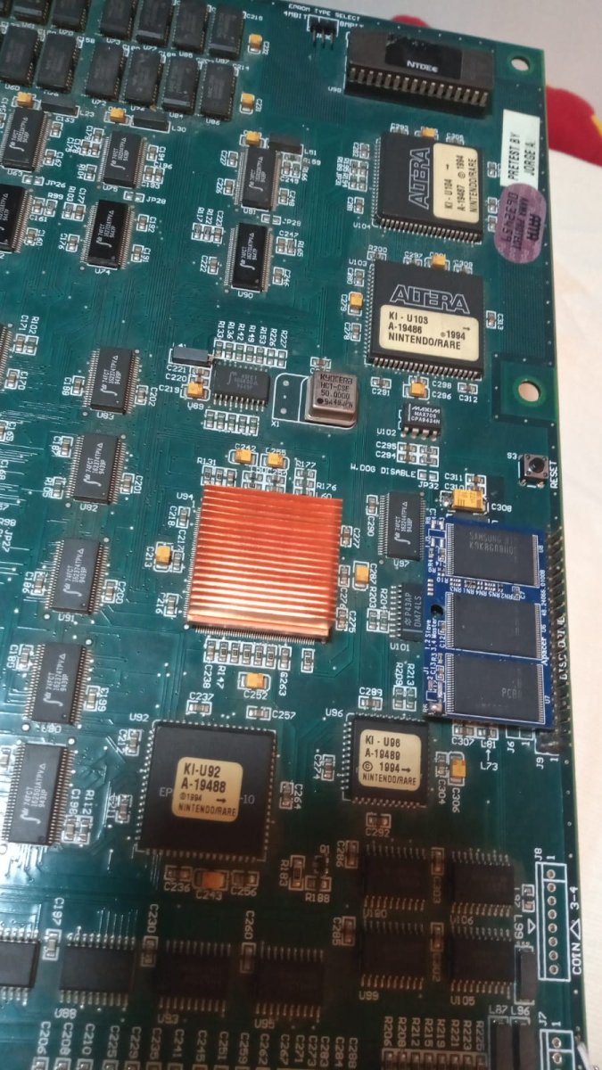

What I did was change the aluminum heatsink for a copper one and install a 30mm fan, it looks great and it doesn't even get hot

how is the original held on, tape or epoxy?
that wasnt my question,
i was asking how the factory heatsink was held on.
