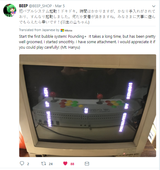

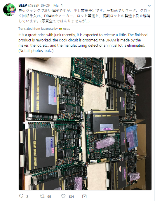

I've seen that BEEP Shop in Tokyo has figured out a way to revive their dead Konami Bubble System boards. Has anyone of you heard anything besides these snippets from Twitter? :)

Once the magnetic storage inside the cartridge is gone there is no way to revive it unless they have used another support.
