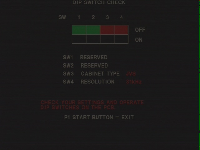

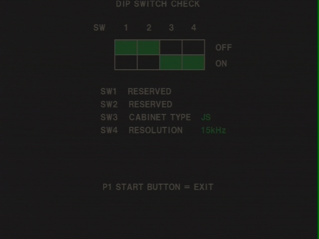

That is actually wrong. The hardware does support 480p and the soccer game can use it depending on some settings, I believe connect one pin of the JAMMA to gnd makes it do 31Khz....
I was wrong. It's DIP switches 3 and 4 to select controller input type (JVS/Jamma) and 15Khz/31Khz.

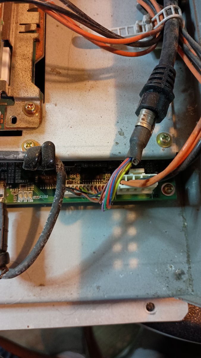

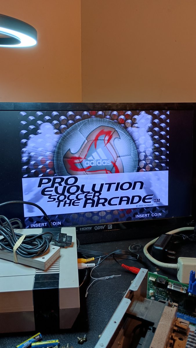

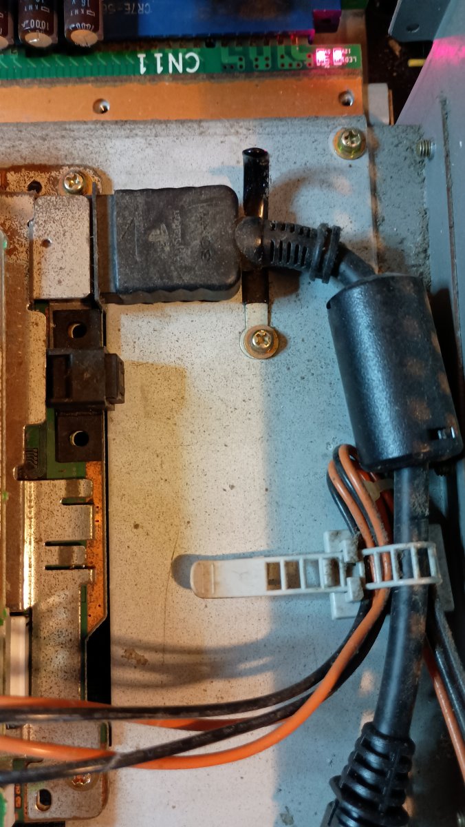

Was working with one with the same issues...I reseated the ps video cable in the case and it finally came to life. Rebooted it with jamma and jvs connections and so far all good.
