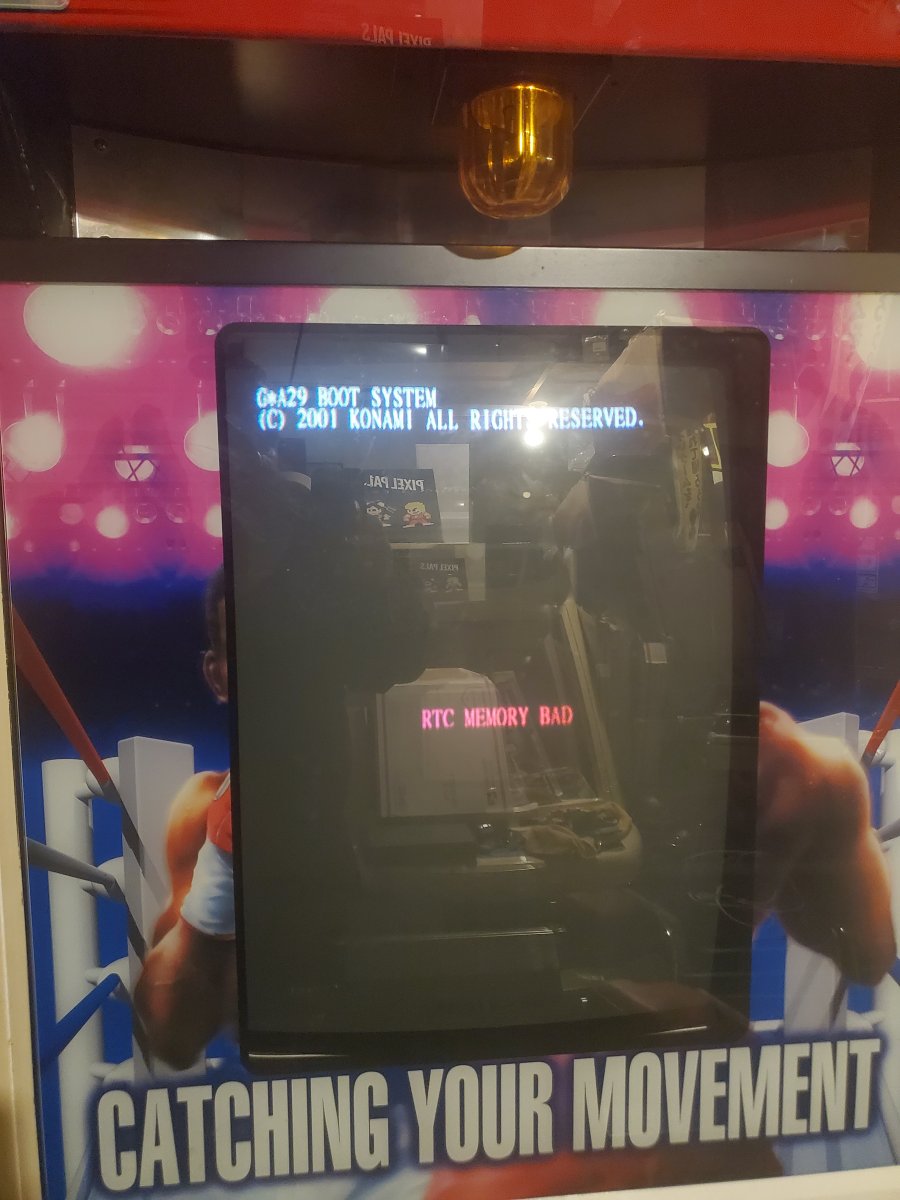

Hello,
I got a MoCap Boxing recently. RTC MEMORY BAD angry message when I got it. No big deal. Had a DALLAS chip programmed for me, installed a socket for easy replacement. Ta-da! Game worked for a nice 45 minute work out LOL
I turn it off, all is good.

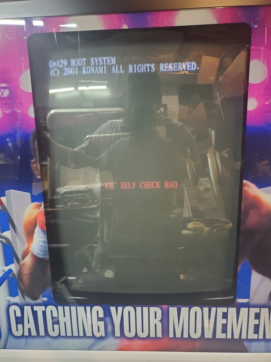

Come back to it next evening now new angry message:
RTC SELF CHECK BAD
are you kidding me?? Any ideas as to what this means?? How to fix it? I'm at a loss. Game worked great with the new Dallas chip. Voltage is at 5.1v, socket and solder joints are nice and tight.
