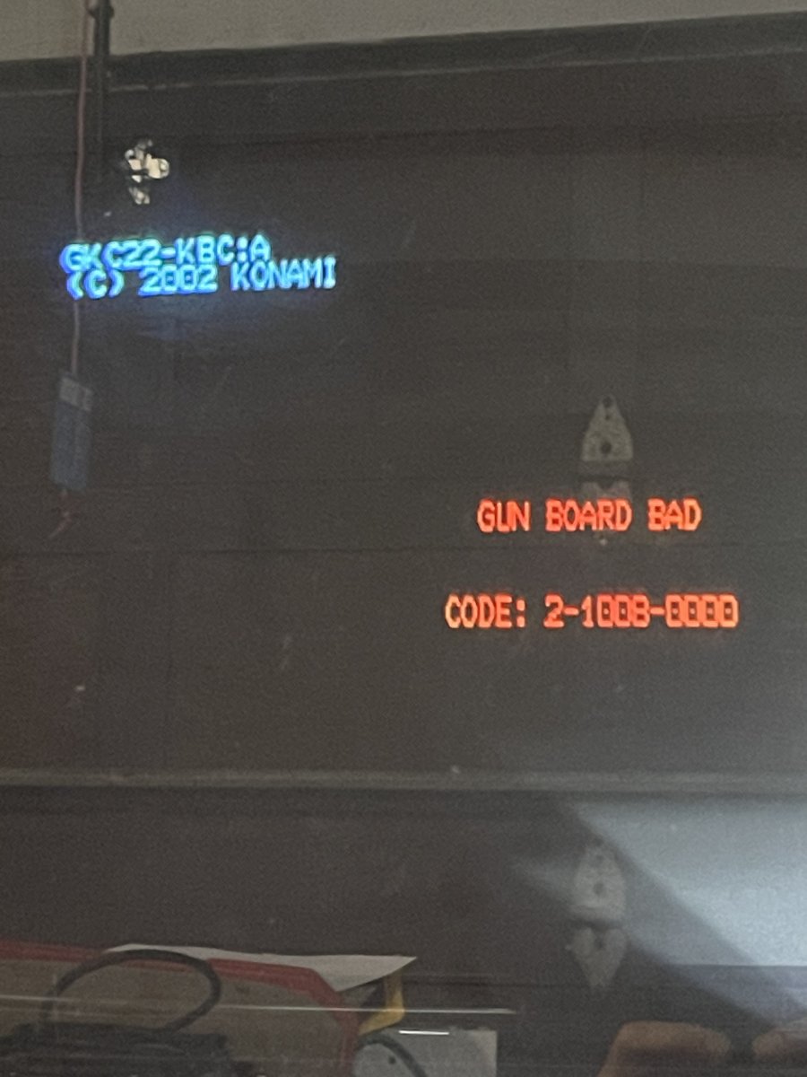

So warzaid is a beast with
2 konami viper boards
2 omz-2d gun boards
1 konami gmc22-pwb board
The rtcs are ok

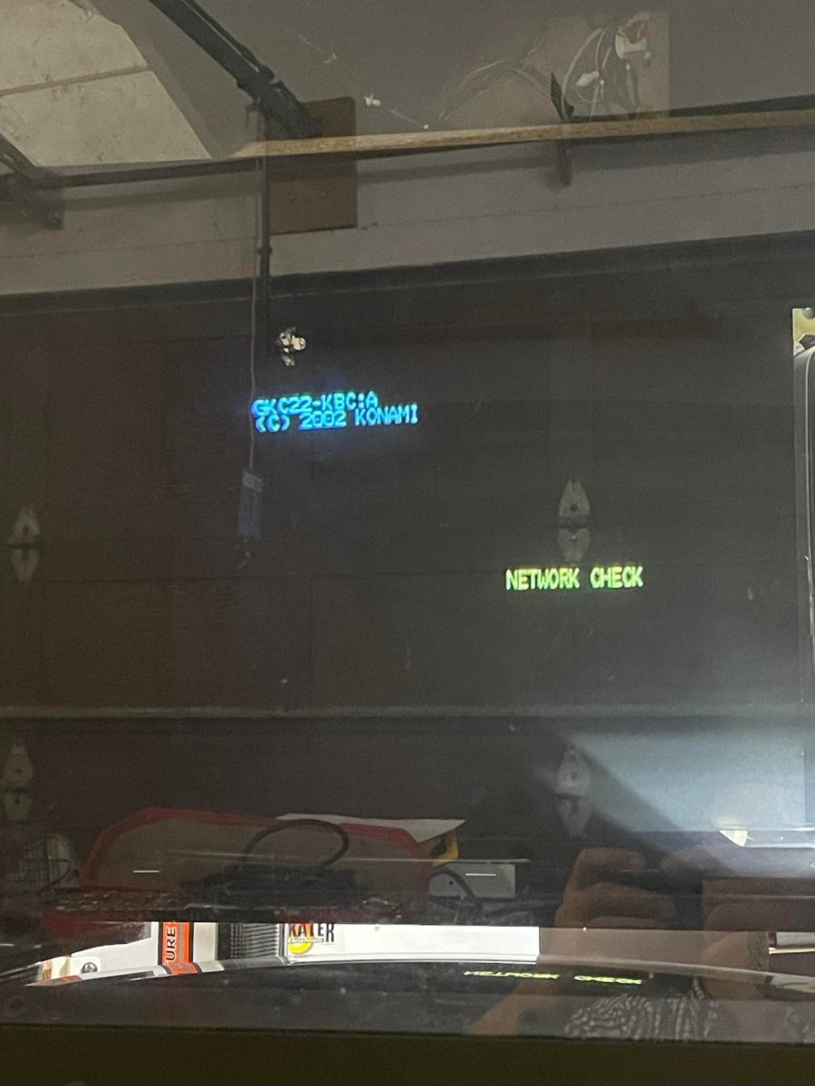

The network between the 2 vipers are ok
… and this
…. And then it reboots.
Google returns ZERO hits on that error.
As you can see above, the previous owner, a friend, ordered and tried changing boards but still the same message.
The wiring looks ok, fuses are there and good, my next idea is to check all voltages,anyone has suggestions or ideas?
Thanks!

All dips were set to off on the gun boards, moved them to ON for inverted and 10 leds (instead of 12)
Still no go with GUN BOARD BAD .... now I am wondering if its the gun board or the boards IN the gun. unplugging all guns made no differences.

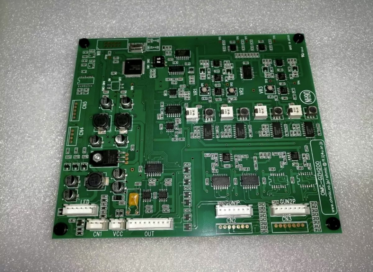

I’d say that one of the gun boards could possibly be bad, looks like the older style OMC gun boards, could the modern ones be used here? Like the TC4, HOD4 OMC gun boards?
I have heard that the older style boards are less reliable than the “newer” SMD pcbs.
it's not these board, it's a SERIAL board and not an analog one. the OUT has 4 pins: TX,RX,GND,GND.

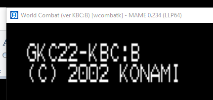

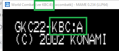

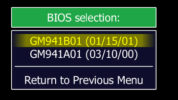

So running mame in debug solved one question I had:
where the hell did this "KBC:A" version came from?
Well running mame in -debug answered that:
it's the bios!
if you choose B:
and even if you are running what is identified as ":B" version in mame, if you choose the :A version, it will say so here:
anyway ... it's news to me! so I guess I can go and see if both boards are on rev.A of the bios, and see if it is something that can be upgraded?!
thats interesting.
i put those bioses there! :D
they both came from u.k. origin machines from Electrocoin!
you can upgrade them, i think it's a 32pin PLCC rom soldered to the board.
i seem to remember the pain-in-the-ass of fitting a plcc smd socket. :D

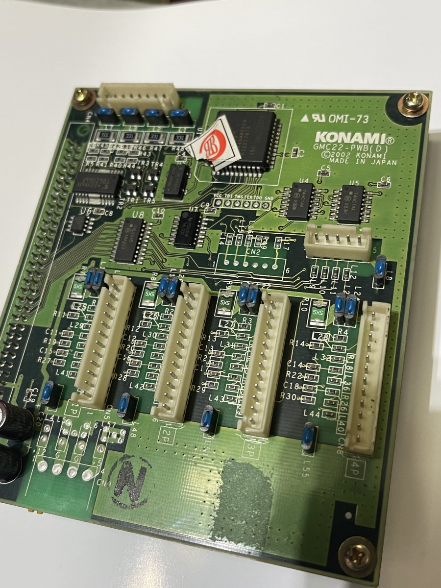

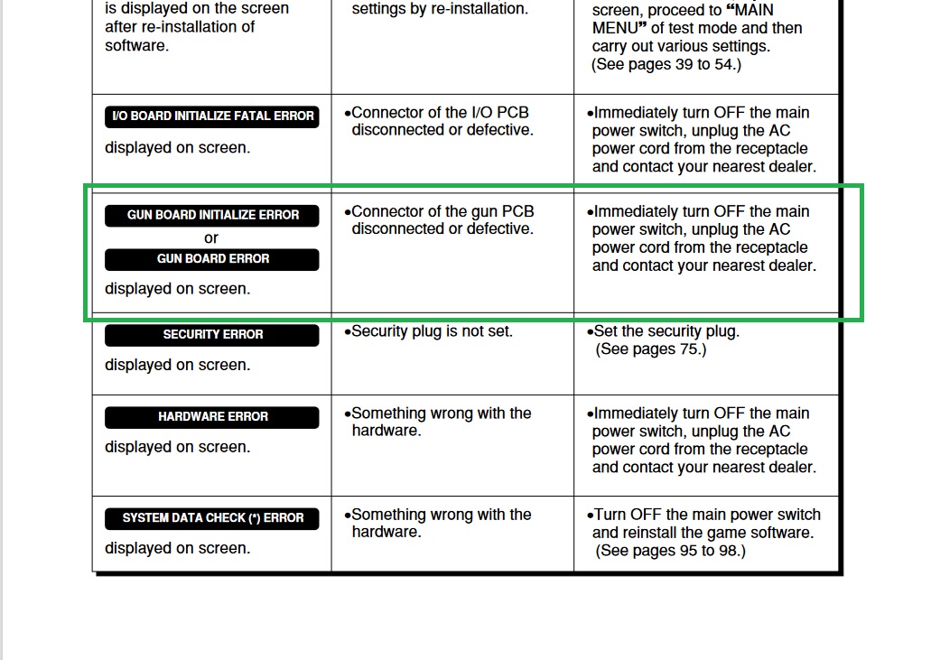

Maybe the gun board doesn't refer to the OMZ gun board but instead that gmc22-pwb board. Check connections between the slave pcb (#2) and that gmc22 board.
Edit: There should be another pcb under that board named gyb09-pwb. If that pcb isn't present, then you can't do much. The wiring diagram can be a bit of a mess to the point it's easy to confuse things but to clarify, pcb 1 serial port = omz gun board; pcb 2 serial port = gyb09-pwb. May have more to say but I need to rethink some things regarding this game.
Edit: I forgot to mention again dip switch settings need to be set accordingly (on both viper and omz gun boards). Viper pcb 1 needs all dips off; Viper pcb 2 needs only dip 2 on. Omz board 1 needs dip 1 off and dip 2 on; Omz board 2 needs both dips off. There is way too much contents to keep track in the manual that some tiny things can be easy to miss.

I have 2 of these gmc22-pcb+Gyb09-pwb combo board…and yes, after reading the manual very carefully, i saw it talks about the dips of the OMZ board and tried them that way, no change. There is a dip, and a jumper on that gyb09… know anything about them?
The viper dips are ok else the network check doesn’t go further and reboots.
