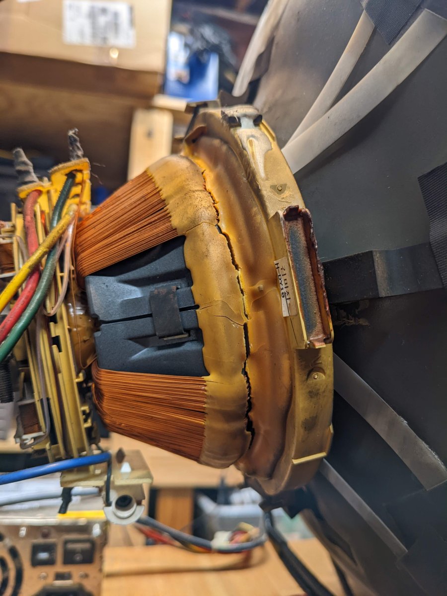

I posted in a few groups / forums about a 29" Kortek 2901M with a wiggly yoke assembly as it had the adhesive cracked.
This turned out to not be an issue as everyone stated. A little hi-temp silicone and its solid.

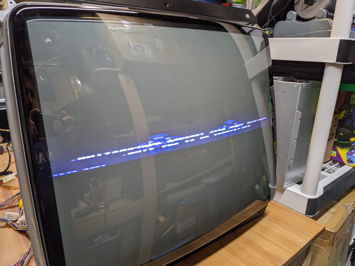

Then I saw it had partial horizontal collapse.

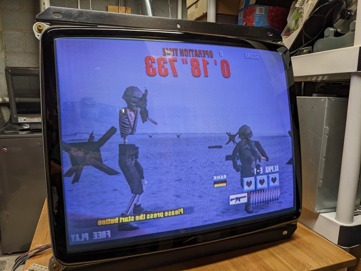

I replaced and marked the caps around IC201, I think, for the vertical and that fixed that issue. Best to do them all but I just wanted to get it to good.
Some adjustment and it was back to working condition.
